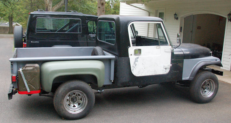

Originally Posted by ACAD_Cowboy View Post
Shouldn't it then be more correctly called a Flare Side as opposed to the factory jeep Fleet Side on the FSJ?
Mebbe so, but I just checked the four magazine articles I have about the original Gaucho (3 from the 70's and one from the 90's), and two of the four call it a stepside, and the other two just mention "California Stepside". I guess I'll just continue their error
To my eye I would suggest a small bracket shelf like the fuel can mounts but obviously smaller, perhaps to lug a bottle jack or a small set of pioneer tools like a pulaski and spade on one side and a sledge and halligan on the other. But doing it right might mean sectioning that beautiful rolled edge.
Sounds like a good idea, but I think I'll leave that kind of stuff for the buyer.

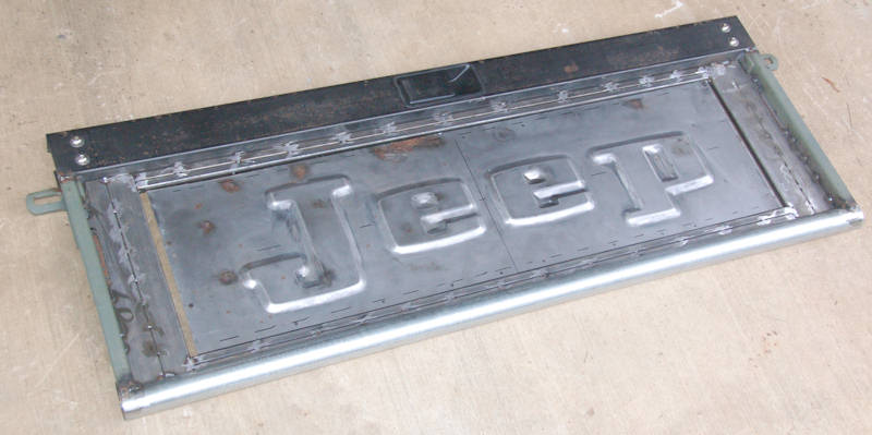

The inner frame is welded in place, this will support the outer skin panels, and the logo panel is cut to size.
All that's left to do is cut out the inside panel (a simple rectangle) and the outer panel, which will look like a "picture frame" behind which the logo panel will go, and then bond the panels to the inner frame. Might possibly get the parts cut out today, but bonding it all together will have to wait for Friday, I have jury duty Wednesday and Thursday this week.

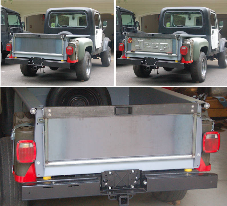

I did manage to get the tailgate skins cut, bent and fit today, here's a couple of photos. On the right, the logo is held on with magnets. All I've got to do now is cut the hole in the skin for the logo panel and then the entire tailgate will be ready for final assembly. You can't really tell this in the photos, but the outer skin is recessed 1" from the edge rails, and it's got a folded lip on all four edges where it joins to the rails. When I bond it all together with structural adhesive, this lip will seal the seams permanently from water incursion and rust. I'lll probably finish it all up this Friday.
And BTW, I'm sure nobody was wondering about this, but the Gaucho turned out to be exactly the same length overall as a Scrambler, even though it's got 10" more wheelbase. The reason is the Scrambler's spare carrier makes it as long as the Gaucho's bed. When I rolled the Gaucho out of the garage today to work on it I noticed this so I decided it was worth a photo. In this photo the noses are lined up and you can see the rear of the Gaucho lines up with the back of the Scrambler's spare.
PS: I am still planning on selling the Scrambler as I mentioned in a post a few months ago... I had planned to remove the World Cab to prep the Scrambler for sale the week I hurt my shoulder, and the injury prevented me from monkeying with big heavy objects like the hardtop. Now that the topless season is just about over, I might just wait until the spring to sell it, I'm not quite sure.

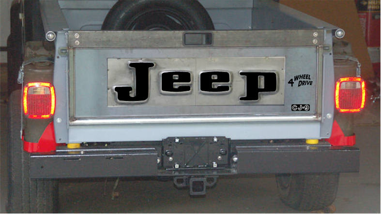

Jury duty was canceled for today, so I was able to cut the hole in the outer panel for the logo; I don't have enough structural adhesive on hand so I'll have to bond it all together tomorrow.
Here's a photo of today's work with the planned graphics superimposed on it to mock up the final look

i like the look of the tailgate, except for the CJ-9 IMO. Great job so far. Any ideas on paint?
I don't plan to paint it other than primer - whoever buys it can get it painted whatever color they like. Same for the graphics - since I'll sell it in primer, I won't apply any graphics, I'll make up the decals and let the new owner decide if they want to apply them or not.
If it doesn't sell in primer and I'm forced to continue the build to a point where I can unload it, then I'd paint it. In that case, probably some flavor of yellow similar to the original Gaucho.
