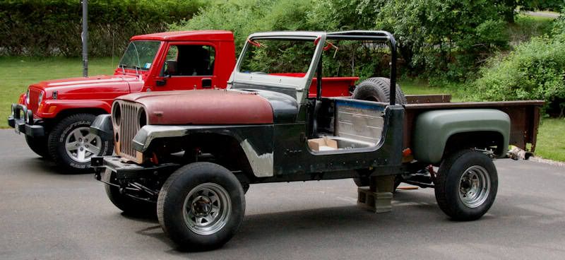

I got the "sport bar" adapted to the pickup tub/cab today. On the left you can see the original main hoop (I had already removed the angle bars that went to the back) - the main hoop angles back beyond where the hardtop will be, so that's no good.
On the right, I've pie cut the main hoop to stand vertically, also took 1" out of the height in the process - of course it became taller when it was standing straight up. I also had to remove about 5" from the connector bars that go to the windshield.
I haven't done the finish welding yet, still tweaking it slightly, also I plan to tie the main hoop into the B pillars just below the door strikers for extra rigidity. Also haven't put the rivnuts in the windshield frame yet, that's why there are clamps there.
It fits very nicely up inside the hardtop, it's all the way to the back and the top so it takes up minimal space inside the cab. Worked out very nicely.

I picked up a hood for next-to-nothing today, couldn't resist grabbing it to make the mockup more complete It's an early 76 hood, you can just barely see the small notch at the bottom edge near the front, I have no idea what that was originally for.

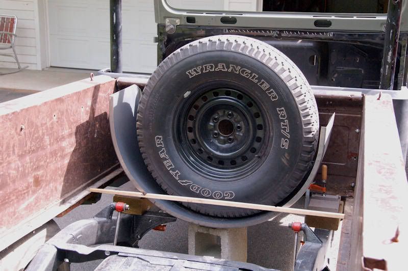

I've decided I'll be mounting the spare right behind the cab, parallel to the back of the cab, it's really the only way to store large spares in this bed. I'll recess it in the bed floor a bit with a well I'll make from a large trailer fender.
Here's a quick mockup photo showing the fender serving as a well, it's got a 36" radius and it is 13" wide, so the 32" tire sitting in it looks small. The well will go about 3" lower, and the bed floor, indicated by the stick, will probably be 2" higher than the stick. Obviously (I hope it is obvious), most of the fender will be thrown away, only the semicircle below the bed floor will be used.

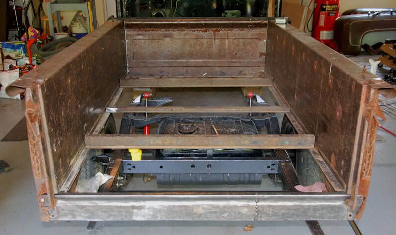

I'm starting to work through the bed restoration/resizing now; today I got the cross-sills in shape. All of the stock Chevy cross-sills were in good enough shape to restore and re-use. I've shortened each of them 5 1/2" to provide a 44" inside width for the bed instead of the 49 1/2" of the original Chevy (44" clears the Jeep WT axles nicely). The under-bed cross sills got shortened at each end and the rear cross sill got shortened slightly off center to the passenger side, you can see that in the photo. I did this to preserve the holes and captive nuts at each end that the stake pockets bolt to; and it is off-center because by a nice coincidence, there was a 5" long nasty dent/deformed area on that side so I was able to just cut that section out.
Today I ordered new repro rear stake pockets and new side angle strips the floor and sills attach to - the angles in this bed are not in good shape, plus I have to move the floor up about 2" from the stock Chevy position to properly fit the Gaucho, so I'll weld new angles to the inside of the bed sides. In this photo, the three forward cross sills are sitting on top of the angle strips - when assembled, they bolt to the bottom of the angles, and sandwich the bed wood in-between the angles and the cross-sills.

wood bed? if so, are you going to do your own, or buy a kit/cut it down?
looks great (as always)
