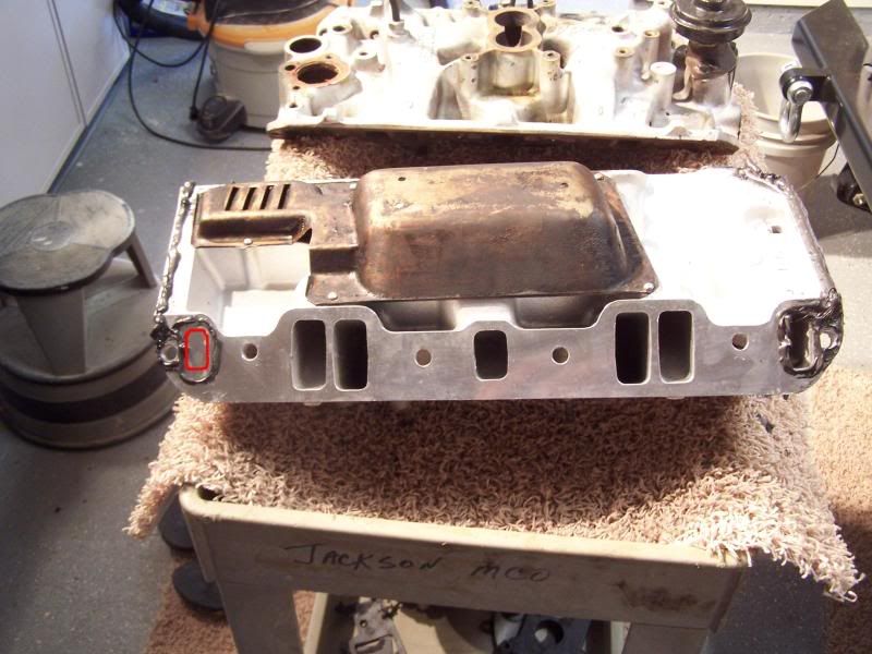

I have researched and found mixed results on here about the use of the various available gaskets and RTV used when upgrading from the stock 2 barrel intake to the edelbrock performer. I used a new metal valley pan, removed the front and rear rubber pieces and replaced with generious portion of RTV -both intake and block side. I circled the water jacket inlets on the block with RTV then placed the valley pan down and aligned holes. next I put rtv around water inlet holes on the valley pan then placed intake on block/heads and torqued to specs. My question is was I to put RTV around the exuast/intake ports holes as well?
http://i349.photobucket.com/albums/q...upgrade037.jpg
<a href="http://s349.photobucket.com/albums/q384/jdchappell/?action=view&current=intakec-carbupgrade038.jpg" target="_blank"><img src="http://i349.photobucket.com/albums/q384/jdchappell/intakec-carbupgrade038.jpg" border="0" alt="Photobucket"></a>
also why would this be blocked off

perfect, i never use sealer on intakes. the gaskets have water jacket cutouts on both ends so u can use them on both sides (u dont need a left and a right.)

so you think I will be ok? why is one of the water ports on the intake blocked off?

thats how it should b, look at the stock intake it doesnt flow through on that end either. it may have an opening in it but it doesnt go anywhere. the heads and gaskets have water jackets on both ends so they can b used on either side of the engine, but water only flows through the one end. if the heads only had a water jacket on one end u would have to buy a left head and gasket and a right head and gasket. everything u did looks good to me.
