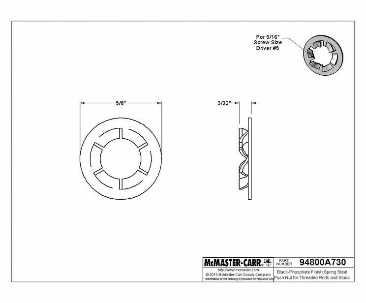

There should be 5/16 Carriage Bolts going through the rear cross member which are held in place with spring steel push nuts. The push nuts prevent the carriage bolts from lifting up and spinning while you take the nuts off.
The carriage bolts are dropped in from the inside through the square holes in the rear cross member and then the push nuts are pushed on from the bottom to keep them in place. At least that's how it was installed from the factory.
Huh... I did not know about the pushnuts. I'll have to get a few of those before I reinstall my tank.
Yeah, most of mine had rusted away so I bought the ones posted from McMaster-Carr.com. Makes it easier to remove and install without the carriage bolts trying to spin.

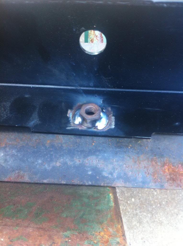

When I have the tubs off, I take it a step further and weld a nut centered in the square hole. This allows for a bolt from the bottom to be used, The type with the washer like used on the fenders or grill are best.
This is viewed from the inside where the tank would be...or the top of the carriage bolt head.
