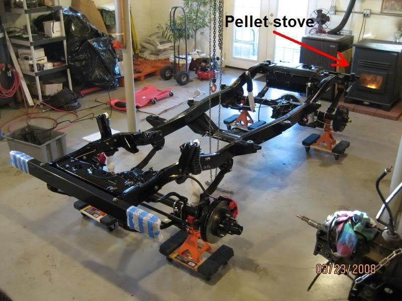

I have a wood pellet stove in my workshop that is built of cinder blocks and a double french door to the outside (basement). The pellet stove runs off a 110V for the combustion and blower fans and typically cost me about $250.00 to run (cost of 1 ton of pellets) in the winter. Dry heat and makes no dust as it is vented to the outside and has a fresh air intake also. The basement workshop is 28x 60 of heated space.
awsome space you have so much room it looks like
my garage is only roughly 20 by 30
