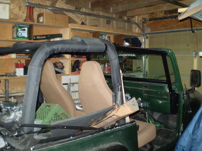

Well, just moved in to the new house and I'm looking to dust off the welder from being in storage and starting a new project.
Does anyone make a kit where I can convert my half roll bar to a full one that extends up to the windshield and down to the floor?
Thanks.

4WD hardware sells them.

or you could just get a YJ bar from the junkyard and tie it in to the floor. it would take a little modding to do but it's all there

The popular ones are OR Fab and Rock hard.
I personally went cheap and bolted in a TJ sport bar and fab'd my own "front bar". It bolts to the sport bar, windshield and the dash and will be going through the floor to attach all 6 pillars to the frame. I will also be putting a bar across the top.
