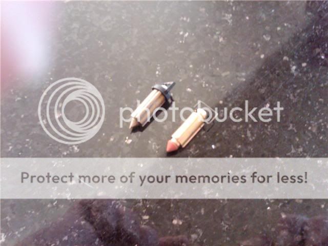

Originally Posted by swatson454 View Post
Actually, I had a long conversation with Weber about this very thing. The reason that they recommend the regulator and no more than 3.5 psi is because the needle and seat assemblies that are factory installed aren't really up to snuff. If you choose to use the factory installed needle and seat, then the regulator is pretty much a given.
The alternative is to purchase the "good" assembly that will handle anything that a factor Jeep pump can produce. It's cost of $14 vs the cost and often headache of the regulator seemed like a wise investment to me. I'm running the good assembly with no regulator and have had no issues at all.
As you can see, the one on the right has a much better chance of sealing and a much lessor chance of failing prematurely.
Shawn
Researched this a bit in the last few days. This NEEDLE..... is a product of APT and is NOT A GENUINE WEBER PART....... READ THAT NOT A GENIUNE WEBER PART. This also has a limitation two fold.
1.. The WEBER's spring loaded seat that helps in bumpy off road conditions is now gone... so off road performance may suffer a great deal.
2.. Rubber Seat Type material dries out and needs to be replaced on a regular pm. So this should also be tanken into consideration. Thus the $14 needed ever 2 yrs or so may not be that good a bargan anymore.
GENUINE WEBER COMMNET.... some folks and the REDLINE one importer likes to use this. They just sell the 32/36 Weber and the other large importes Sells ALL the WEBERS. So the only time you see this is with REDLINE advertising. You will also see a REDLINE distributor, RaceTep, go sued by Magneti for using the Weber Name in US and can no longer do so. Google it.
Do you think Weber North America could use the name for their own or use the Weber 34 and call it a weber 34 an not be sued also??? That alone should be poof enough to put this to rest.
Weber 34 is a weber design made by Solex and both Solex and Weber name owned by same mother company. If not they would be sued too.
EMPI is a China copy and is lower quality from what I read. Never had my hands on one.. no interest. They do not use the Weber name but the parts are interchangable partialy at least. So do not confuse that, EMPI, with the GENUINE WEBER 34.

Not sure how much of that was necessary because it still doesn't address the fact that those other carbs are simply "branded" to use the Weber name and their design and quality control are not part of the original Weber carbs that perform so well and are only built in Spain.
Anyway, you need to do some more research as the needle I posted up does in fact have the spring-loaded buffer. I could continue but it's Friday night and I have better things to do than spend three days trying to prove someone wrong.
Shawn

I bought a Weber rebuild kit for my 32/36 and it had the newer style needle, FWIW. It was a genuine weber kit.
The feedback I got was the After Market seats are supplied by APT and others maybe. There are the soft seat and another style of some with two balls or similar. I do not belive they came from weber corporate, but are something one of the IMPORTERs put together.
The gentle man I spoke to was aware of the alt seats but the metal needle seat materials are stock. I can ck again.
The base theory... is you match the fuel pressure to the carb requirements. Pres for a fuel injected is different than a carb. This / Weber carb happens to spec 3.5 psi max.
Mr Swatson has used his carb for a whole wk lets see how it works in a yr. No issue with the needle, but saying the holley low pres regulator is not needed? I am just not convinced yet... takes a little time... most would agree. I would hate this to be a situation that because Fred says holley is proven and the norm for Weber applications we need to say otherwise. Fact is after testing not fact based on theory is how my mind works.
Most Weber installs did not show rich conditions for a month or two.. then the rich and stinky starts if not set up right. At least that is what I hear posted most of the time.
Stock Weber Carbs and seats can last ten years I have some say here and they never touched them. Mine has been installed for 2 yrs and zero issues. I have had my front tire bottoms six feet in the air and did not stall and the bumper was on the ground scraping.
So how about a little time under the belt with some use and trial before we send a bunch of users down the road? I know for $15 delta in price, needle/FPR, the rubber tip needle would not have been my choice. Summit Racing recommends that all the carbs have the proper fuel pressure... its just a std practice.
