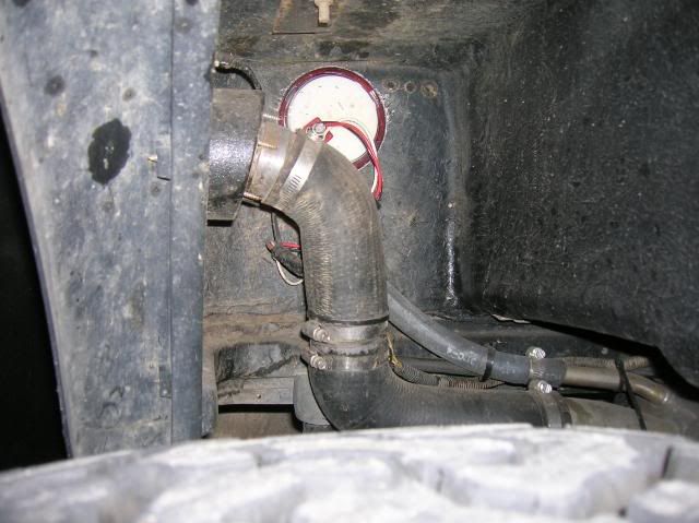

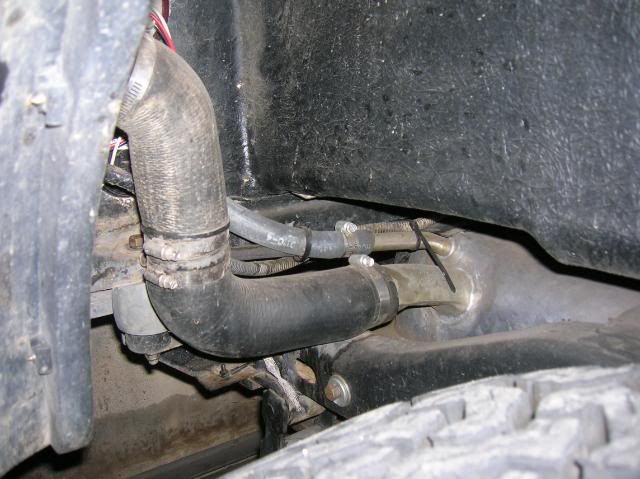

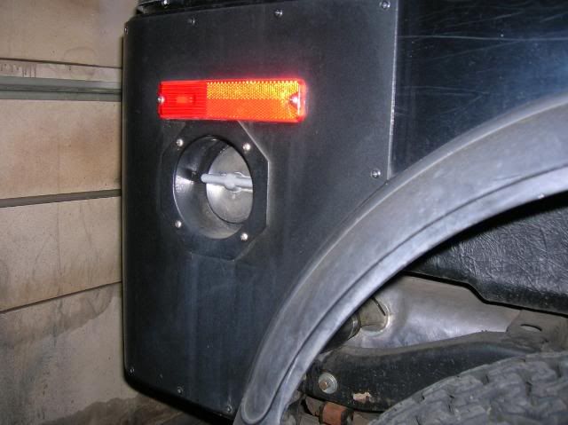

I did what you stated in your opening post, when I switched my fuel filler from the rear to the side of the tub.
I cut through the hose, perpindicular, sleeved the 2 halves, and swiveled the hose to where I wanted it. Then, I used hose clamps to secure everything.
Here are a few pics...
No problems, whatsoever.
Rich
Rich
Cool! That's how to do it!

Autozone has fuel hose. Not sure on the sizes they have. You have to ask for it because it is in the back. It's on a roll so you can get the exact size you need. Personally I see nothing wrong with splicing like in the photos and you can save some money.
