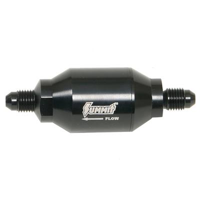

The whole fuel system is brand new. New pickup in the tank, new soft line from the pickup to the new hardline on the frame, new line from hardline to pump, new pump, new line to filter, new filter, new line into carb.
I was thinking of installing one of these before the pump.
http://www.summitracing.com/parts/sum-220191b

May work.
Let us know.
