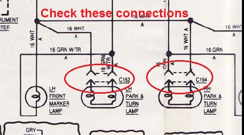

Here's a diagram on the basics
http://oljeep.com/edge_76_tsm.html

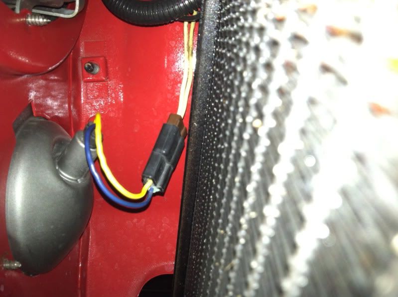

Especially this plug that is hidden behind the grill and radiator. Check it for looseness or corrosion as it is a notorious plug that will give you the symptoms you are having.
