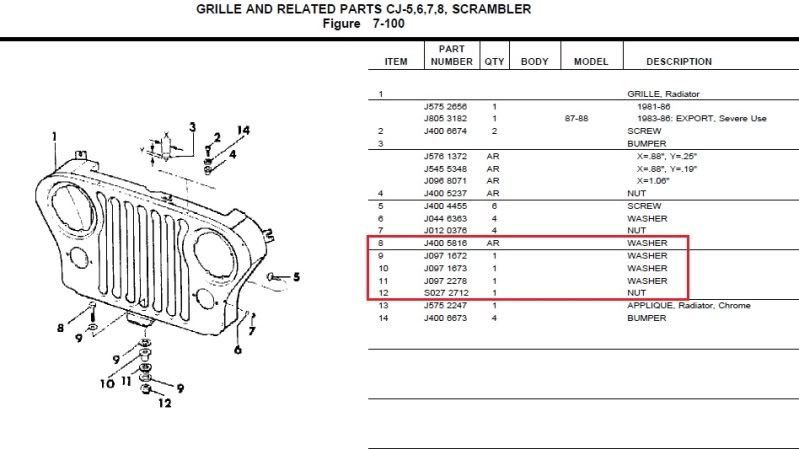

Glenn, those part numbers you have are incorrect as far as I know. They are for the more common body tub mounts and not the one for the grill. If you have a 1981-86 Jeep Parts Manual, look under the Cooling section to find the front grill mounts.
To add to the confusion, the parts manual list all the parts associated with the grill mount as washers and the exploded view doesn't make any sense either. They show a bolt coming in from the top with a nut at the bottom when we all know the nut is encapsulated in the grill and the bolt comes up through the bottom. I remember having a hard time sorting through the parts with NAPA here in Doylestown Pa and it took several attempts to get the correct parts that the parts manual list as all WASHERS.
