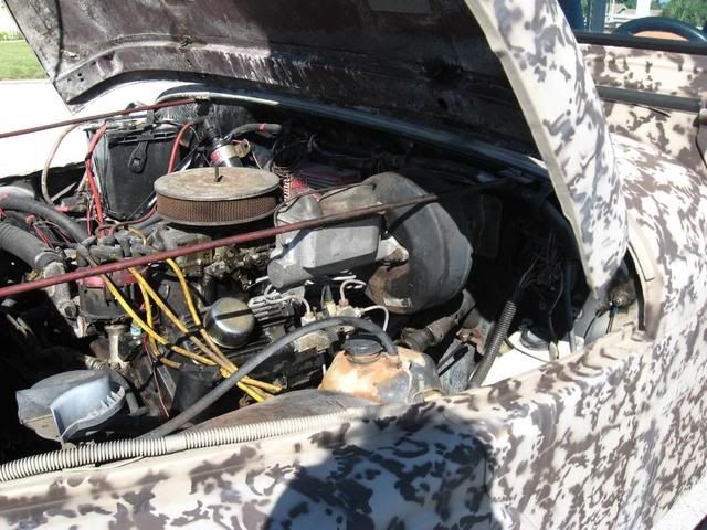

Haven't got done putting it together yet. Just pulled the 351 last week should be putting the 401 in in a week or two. Jeep bay is cleaned painted and waiting on it. That 351 your probably gonna have to cut the drivers side wheel well out a little to fit the power steering pump but you can set the motor farther back because of the front distributor and that will leave you plenty of room for a 3 core radiator and electric fan which you will need. Mine was in since 2002. Here's the 351

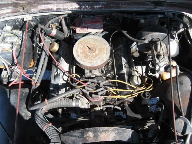

Here's a thread that will helpful. Poll: 5.0 engine swap pictures
Here's what mine looks like at the present time.
