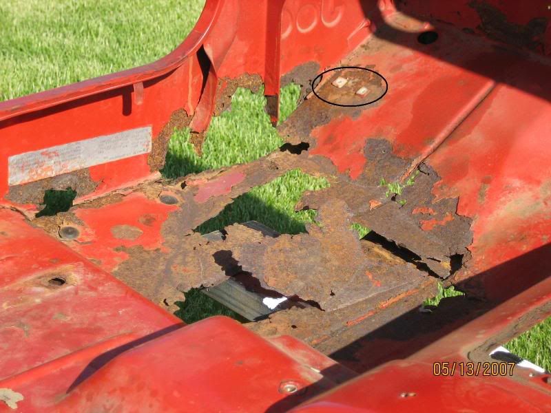

Most of mine use the little plastic inserts like found on license plate factory brackets. I think this was the factory way. They use a square hole.
I like the small bolt/nylock Idea, the same size as the holes in the switch.
If I did this, I would put never seize on, for sure cut the machine screw/ flush with the nut. And use some spray undercoating to seal.

That's correct. Your 1985 model year will have two 3/8" or 1/2" square holes in the floor pan with plastic inserts that provide a base for the #8 Hex head sheet metal screws that hold the dimmer switch in place.

Mine didn't have the plastic plugs. Went with 10-24 screw and nylock, and have had no problems. I also took a thin 3/16 or so piece of rubber and put between the switch and floor. Just a little added water/dirt protection.
