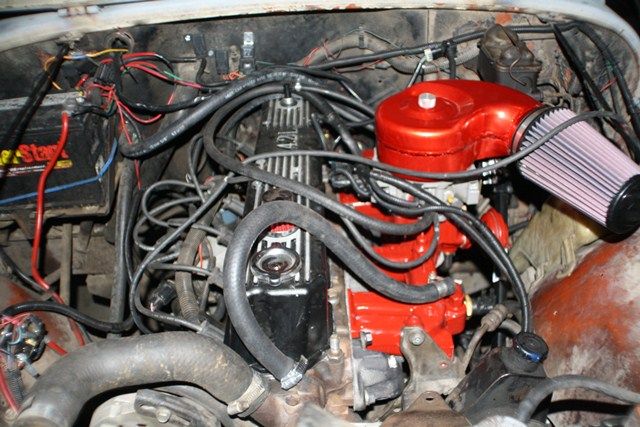

Walker,
You guys are inspiring me to make things pretty! Looks good to me!
I definitely have plans to do dress up one day but I am in the phase of must-haves right now.
Thanks for the pics, the red intake looks nice.
Chris
Originally Posted by walkerhoundvm View Post
I got a new exhaust manifold and did what Matt suggested - prepped with phosphetch (for only 15 minutes using a 1:4 dilution with water), let it dry, then painted with black exhaust paint which is basically the color of your propane grill. I also did my intake manifold at the same time using a red VHT paint after phosphoetch. I just cured them on the engine according to instructions - run it for 10min, shut off for 30min; run for 20min, shut off for 30min; run for 30min, and you're done. Both are holding up well, the exhaust better than the intake (I think I just couldn't get the intake clean enough before etching).
I had a pair of left over headers after putting the new manifold in, so I did the same to them and sold them to cover some costs.
Not nearly as pretty as Matt's engine bay, but neither is the rest of my Jeep
