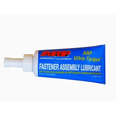

Hey Keith im going to be putting my cylinder head back on tomorrow. I was told just to oil the bolts up before torquing. Im not sure what stuff you used? Also I was just going to hit the hardware store and get some pipe sealant but what did you use for bolt #11?

The stuff I used for the head bolts came from Summit Racing and is made by ARP (Automotive Racing Products). Looks like anti-seize compound but is called ARP Ultra Torque Assembly Lubricant. Summit Racing part #ARP-100-9909

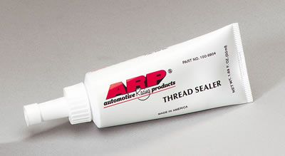

ARP also makes a high temperature thread sealant available from Summit Racing, part #ARP-100-9904. I didn't use as I couldn't justify the additional cost of $10.00 just for one bolt to be sealed so I used Permatex RTV high temp sealant like I always used in the past without problems. I imagine pipe thread would work just as well too.
