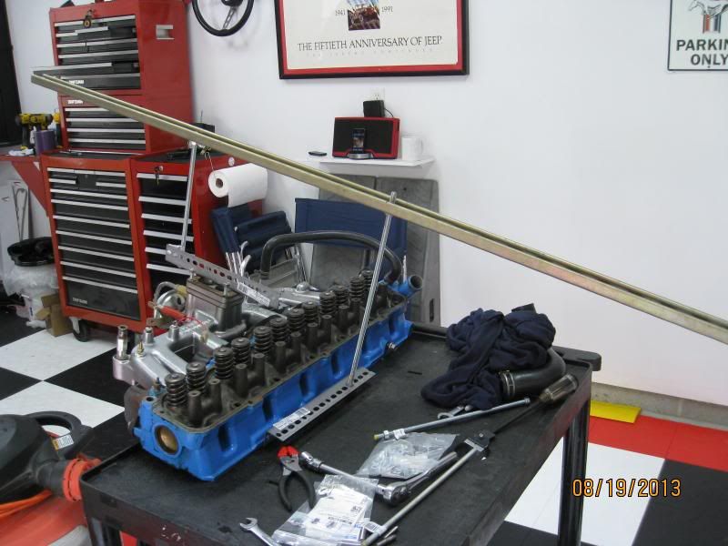

No, the most I will do is just check it for straightness because I don't want to separate the intake/exhaust manifolds from the head. It's a lot less work and another gasket I won't need to mess with. I've made a Uni-strut piece that is a little wider than the Jeep, has all-thread attached to it and a plate that mounts to the carb base. The cylinder head side will be attached the same way, with a plate attached to all-thread going up to the Uni-strut. It makes lifting the entire cylinder head with intake and exhaust manifolds attached a whole lot quicker and easier with two people. Got three old cylinder heads bolts, with the hex heads cut off, to use as guides when lowering the cylinder head assembly back onto the block.

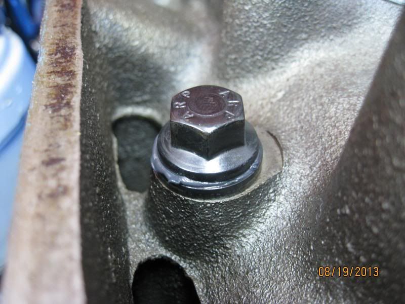

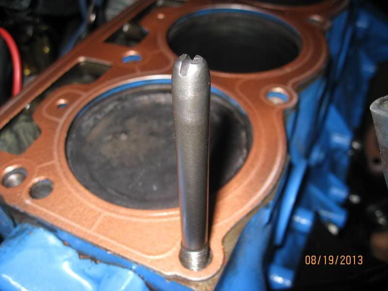

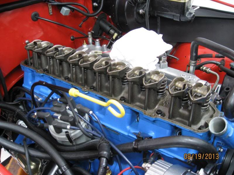

Started putting the Cylinder Head back on the Jeep today.

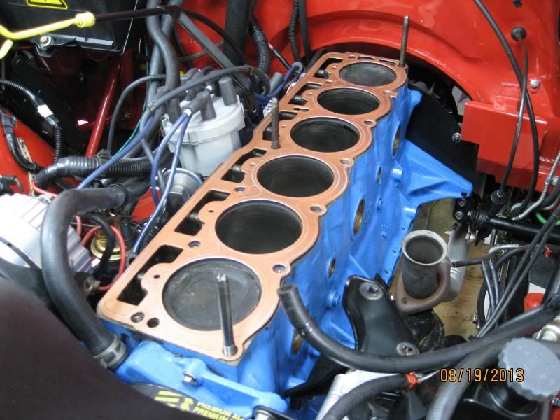

Got the head gasket on that came from Qaudratec and applied some Permatex Copper Sealant
With the help of some guide pins, it was time to put the Cylinder Head back on.
Made a jig so my son and I could lift the Cylinder Head with the intake and exhaust manifolds attached easier. I wound up attaching it a little different as the one angle piece was interfering with the distributor.

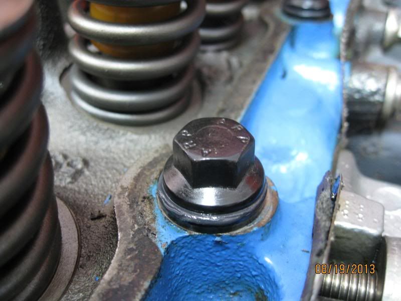

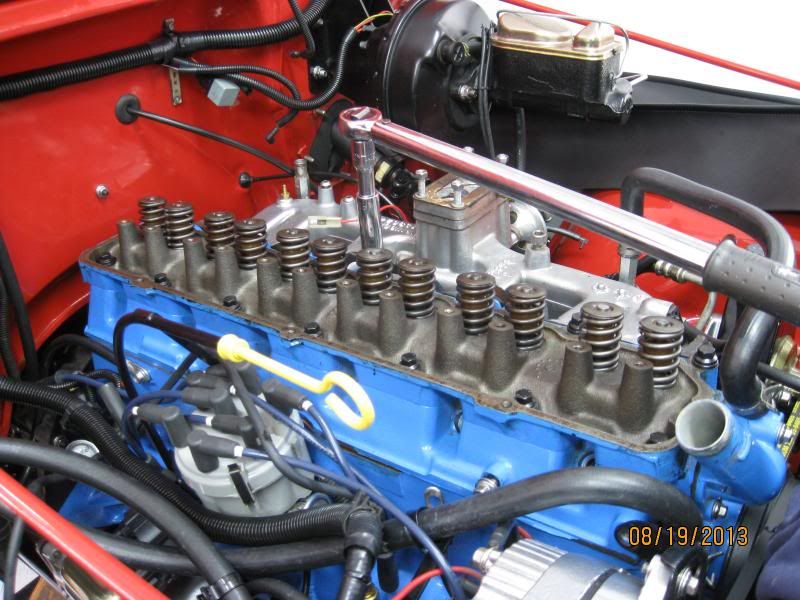

With the head back on, it was time to install all the new bolts and torque them to 85ft/lbs each. Bolt #11 gets sealant as it is a through hole that passes through a coolant passage. I call it bolt #11 because of the torque sequence order and that one bolt only gets torqued to 75ft/lbs.
All the new bolts have an installation lube applied to the head of the bolt and threads so torque readings will be uniform.

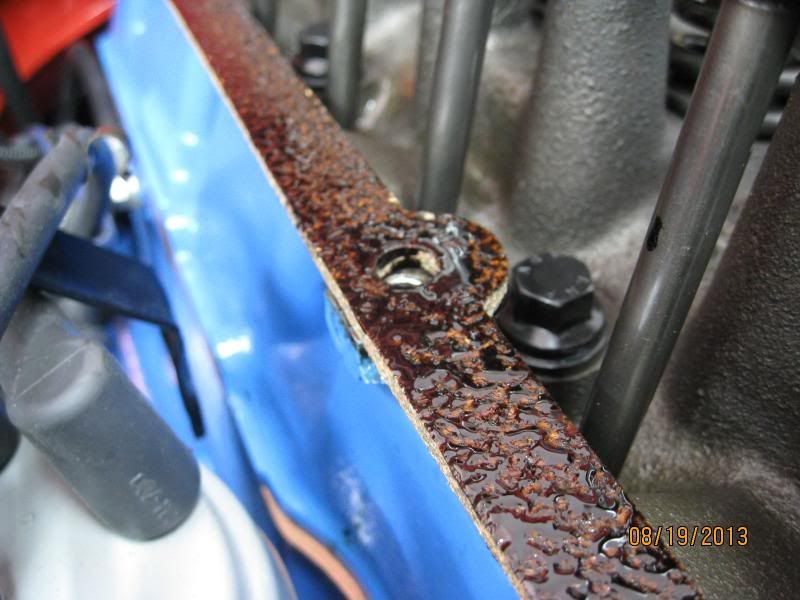

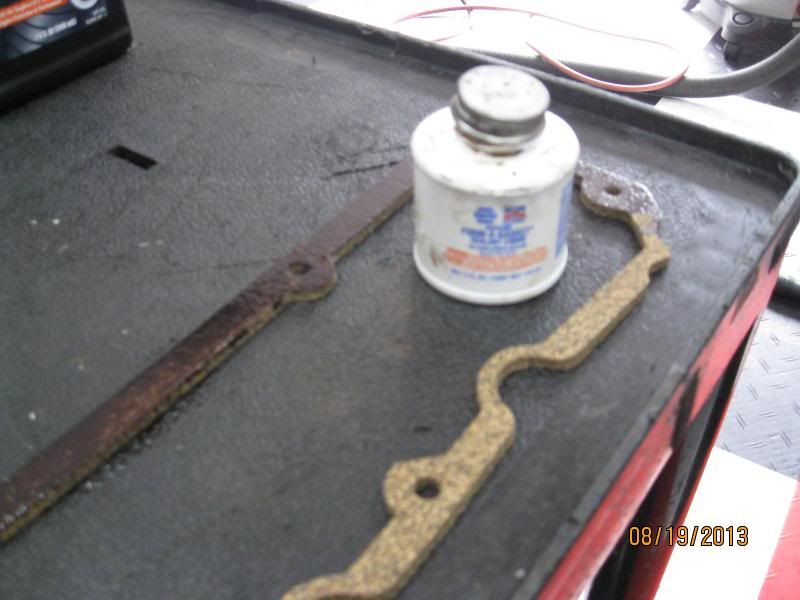

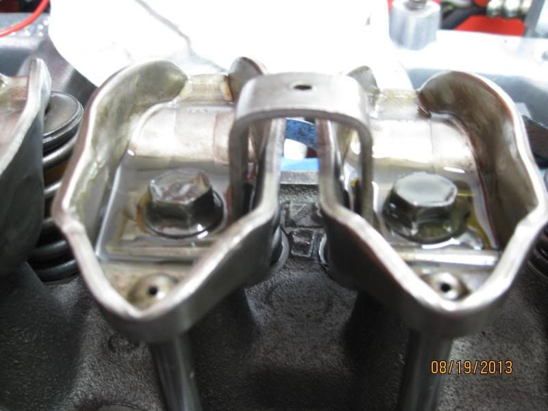

Once the Cylinder Head was put back on and all the bolts installed, all the rockers and push rods were put back on in the same order and orientation that they came off.
We used a new Valve Cover cork gasket and applied aviation sealant to both sides. I can honestly say I have never had any leaks while using a fresh cork gasket with aviation sealant applied.

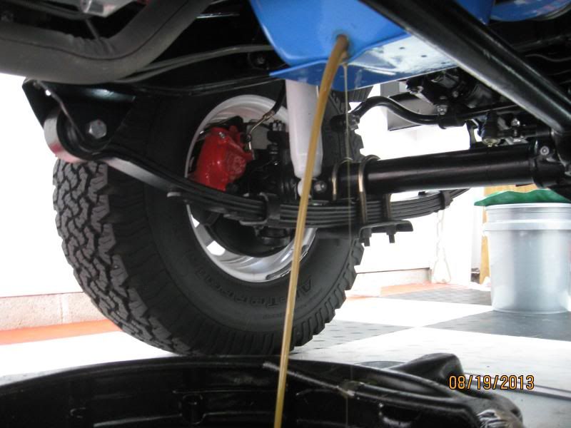

With the Cylinder Head back on and all other accessories that were taken off and put back on, it was time to start it up with some cheap K-mart 10-30 wt oil and new oil filter. Only put in 5 qts so I could leave room for a quart of NAPA Engine Flush to clean out the rest of the coolant/oil mixture that was still inside the engine block interior walls.
Once the engine started, we let it run until it warmed to operating temperature. Shut it down and added the NAPA Motor Flush. Started it back up and let it run for just 5 minutes and then stopped it again to drain out all the oil. NAPA's Engine Fast Flush really thinned out the oil and I noticed a drop in oil pressure as soon as it started to circulate inside the engine.
After the oil and flush were removed from the engine, we installed yet another new oil filter and 6 quarts of Shell Rotella 10-40W motor oil and then let it idle for 10 minutes before taking it out for a test drive.
Test drove it for about an hour and everything looks good. I'll report back in about a month to let everyone know if the coolant leaks are gone for good.
