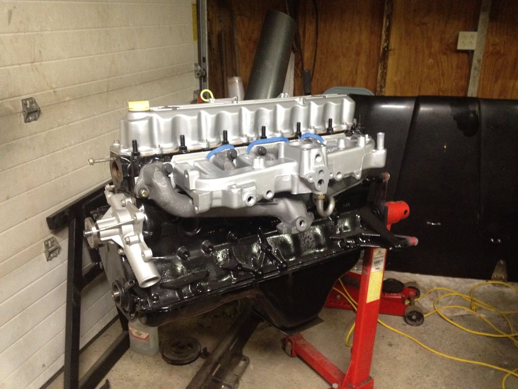

I am not sure if the 258 head bolts are "Torque-to-yield" but I've put a few of them together using the original bolts and they have never bothered, including my present engine which came from an '88 YJ and now has about 35,000 trouble free miles on it. I used Victor Reinz gaskets on that build. I hope it continues to be trouble free when I put it back into my CJ when it's done, I did do a freshening of the exterior and this is how it looks now:
Best of luck getting it back up and running. If you do end up needing a head core, I think I have one or two out back in the shed.

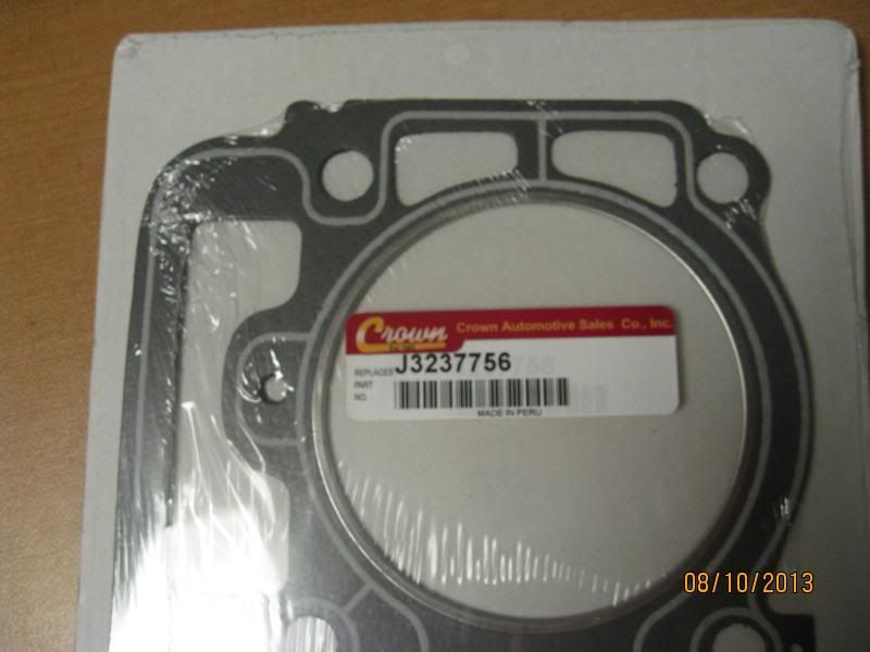

When the engine was being rebuilt in 2009, the block and head were both magnafluxed and decked. It is one of the reasons I use 89 octane fuel now instead of 87. The compression a little higher from the decking and I can feel the difference when driving using 89 octane.
The Fel-Pro head gasket replaced a Crown head gasket that was put in in 1990 that I had absolutely no problems with. Used sealant on that one and I forget why I needed to take the head off as it was a long time ago. But anyway, the Fel-Pro gasket didn't have a piece of paper in the package stating not to use sealant or other wise. It went on dry, and now I have leaks. My new head gasket from Quadratec came in yesterday and it is another Crown head gasket for $12.99. Same one they made 33 years ago and had good luck with and I can see the difference from the more expensive $30.00 Fel-Pro version. The Fel-Pro version does not have raised sealant or "edge molded sealant beads" around the each coolant passage or port like the Crown version does. The Fel-Pro was just flat with the blue chalk like sealant only. I'm liking the Crown version already as it is just like the OEM one used by the factory. And for once it's not made in China, but in Peru! At least that is one of the America's.
My bet is still leaning towards stretched head bolts is the cause for the leak.
Got most of my parts in except the 3.75"L head bolts from ARP as they are on back order right now. I'll be sucking all the gunk off the top today and prepping the removal of the head with the intake and exhaust manifolds still attached.

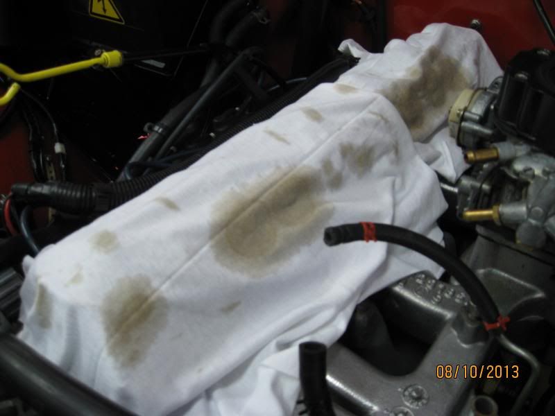

FedEx just arrived with the rest of my ARP head bolts so I will start the cleanup today while I have the time.
I just looked at my Healing Shroud covering the exposed valve train and I believe I can see 'his' face in the oil stain! I going to sell the shroud on eBay to the highest bidder to recoup the cost and lost Jeep driving time. I swore I wouldn't go there but, what fun would that be if I just ignored it!
What do you think, can you see 'his' face?
1984 CJ-7 Renegade
Turin my a$$!!! Its definitely healing!!

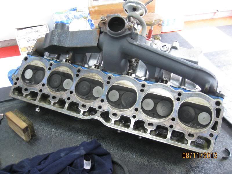

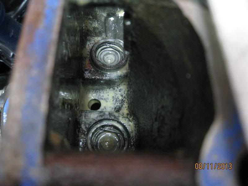

I got the Cylinder Head off and can clearly see that the Fel-Pro gasket did not seal against the block. It sealed against the Cylinder Head but the small coolant passages between the cylinders and the push rod cavities are soaked with coolant and oil residue.
1984 CJ-7 Renegade

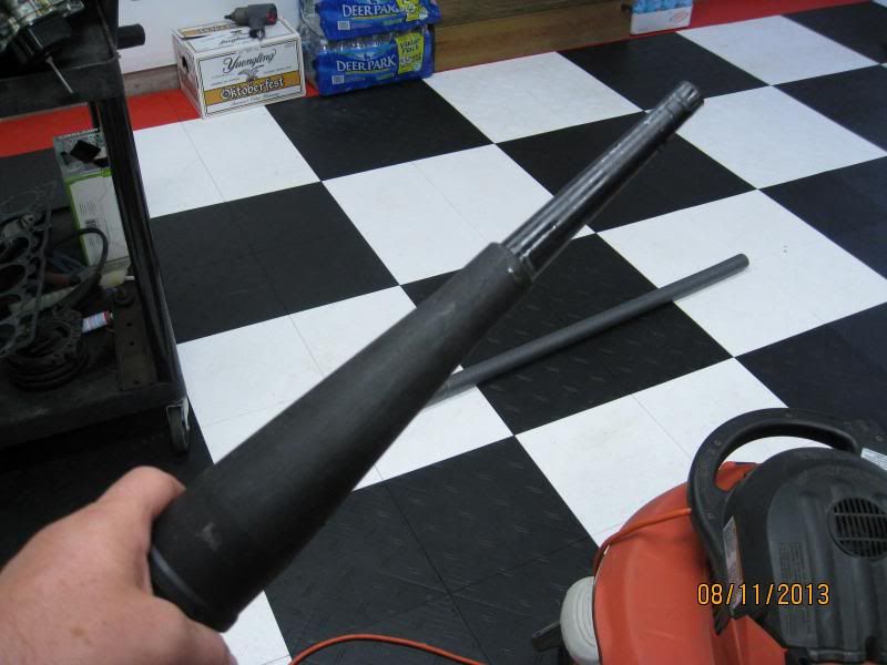

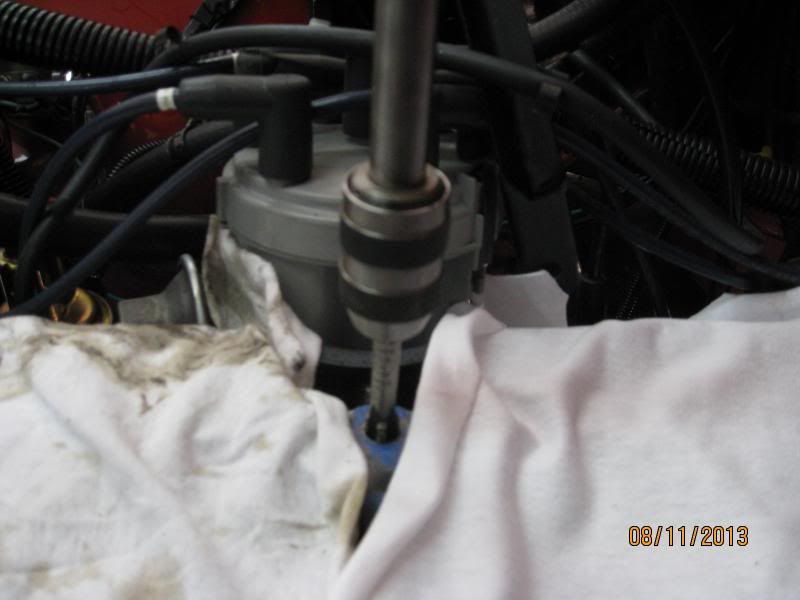

Got back into the engine late in the afternoon after doing a work related job for a customer on Sunday.
With the Cylinder Head off, it was time for some cleanup work.
Cylinder Head scraped and cleaned of the Fel-Pro head gasket. I used a razor scraper and a soft brass brush.
Cleaned out the Lifter Gallery with a vacuum attachment and generally sucked up any gunk with it.
Thoroughly cleaned out the head bolt threaded holes and chased them with a 7/16-14 tap.
I'm off to a business trip to the Carolina's for the rest of the week so no Jeep time this week. Might be able to fire up the pressure washer before I leave and give the head and valve cover a good cleaning.
