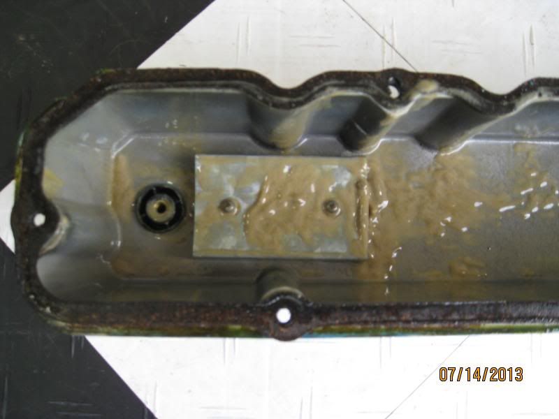

Valve Cover coated in thick deposits of coolant and oil.

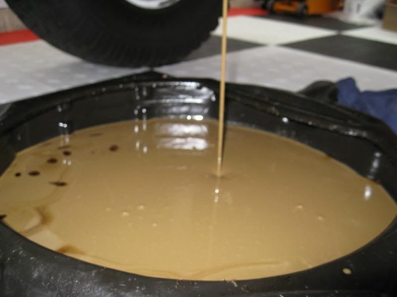

Oil draining out of engine is milky in color.

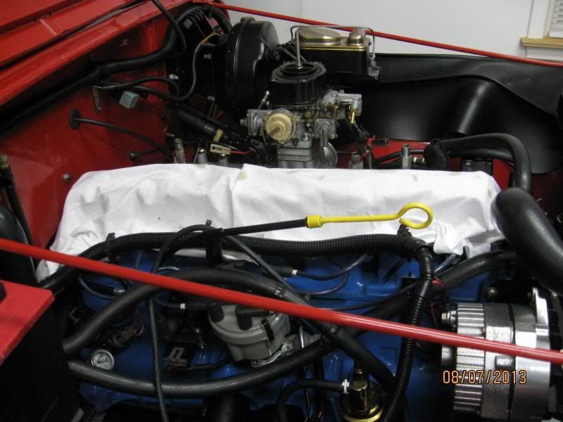

I'm betting on stretched OEM head bolts are the culprit or a head gasket that is blown because no sealant was applied and is now leaking. What do you guys think?
