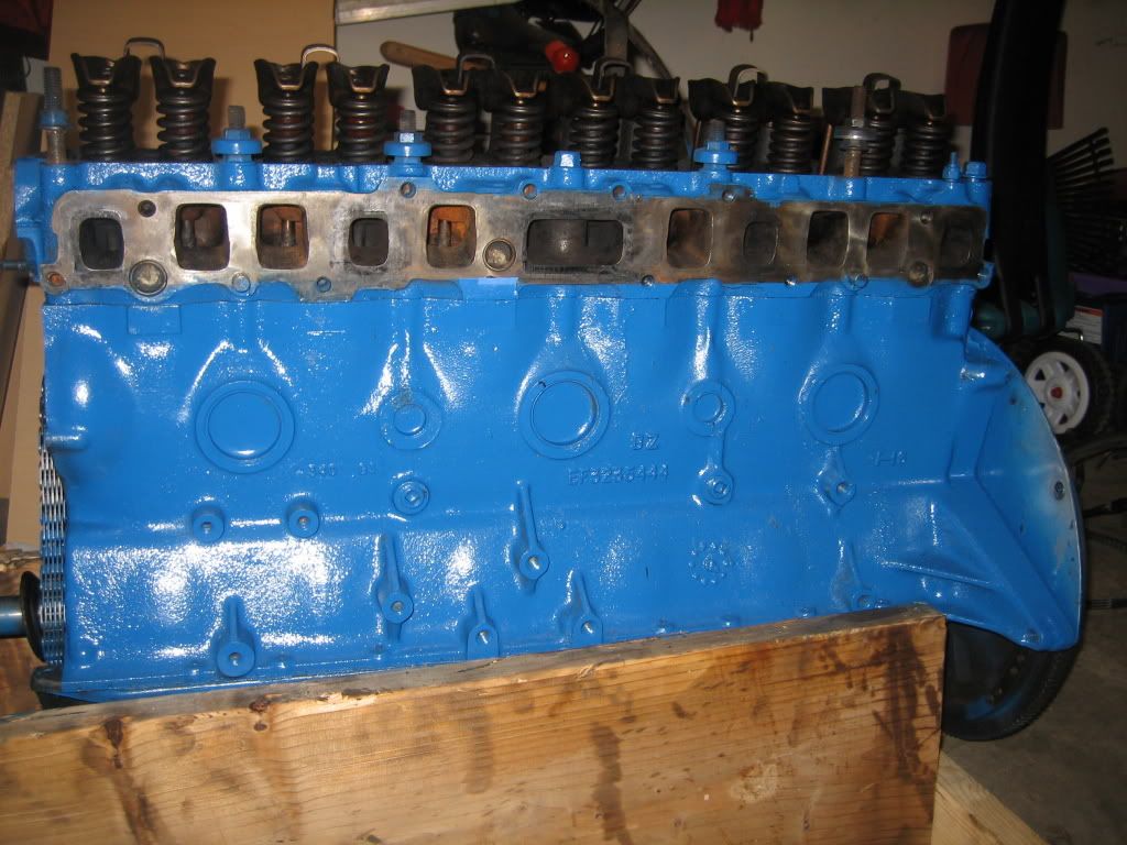

I should have been more precise about the CJ. It's not mine, and I actually don't have it in my possession at the moment. I have a Jeep/4X4 shop & the owner is a new customer who doing a lot of work himself. I haven't seen the numbers in person, but he wrote them down & brought them to me.
He & I looked at an '85 CJ7 258 block I have on the engine stand in the shop. It has 6 digits on it, and we both agreed that his block seemed a digit shy of a full number, but he was certain that he copied down correctly.
Also, he mentioned that the stamping on his block was much smaller size print than the one in my shop.
Does any of this help explain anything?

Try this. There is also a block casting number on the drivers side of the block, you may be able to verify the year range of the block with that.

Look on the manifold side for the casting number. The stamped numbers are usually the actual assembly/build date.
