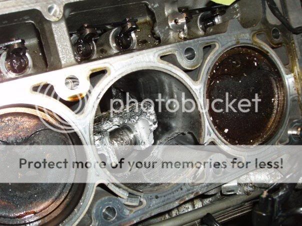

You'd be amazed at how well a good cat can act as a filter before the turbo. Yeah, we found the exhaust valve and chunks of cylinder sleeve packed up at the converter.
Again, let's find out if you're leaking pressure through one of the valve seats.

Now driving it another 1/2 hour isn't going to make the engine look like Shawn's picture, and it's not going to cause any more damage than you have now...
