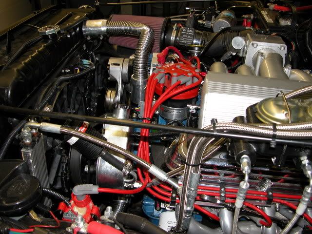

1) You'll need the fan setup from the V6 model. Get as much of the wiring with it so you won't have to source the plugs. Mine is wired to a Flex-A-Lite controller that works the fan similar to modern vehicles. It 'soft starts' the unit (it does this by 'hitting' the motors with brief pulses of current), which makes a bit of noise, but once running it is not louder than the 5.0L motor:
I have the controller set up to also work with the fan 'always' on high, or fan 'always off'. This is controlled by the dash mounted switch on the left with indicator lights.

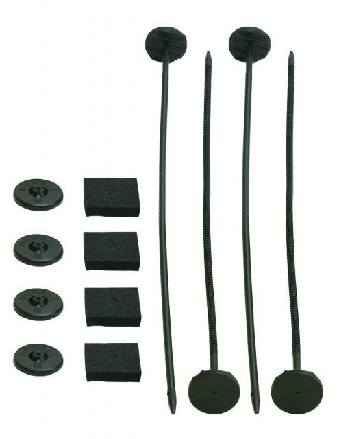

2) It is attached with plastic rods. I got mine from Summit, here's pic of a similar product:

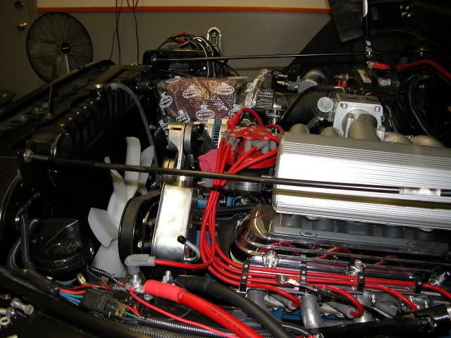

3) The 3.8L Taurus/Sable fan is a beast. I show it test fitted to a stock CJ radiator fan of unknown model year.
It would take a bit of minor trimming and some sort of fasteners to make it one unit. The wiring could be easily handled depending on how you wanted the fan to function. It does draw a LARGE amount of amperage to start, so you will need to use relays with a direct connection to the battery. The next step up would be the 4.6L fan from a Mark VIII or V8 T-Bird. That is a much larger unit, but does move incredible amounts of air.
