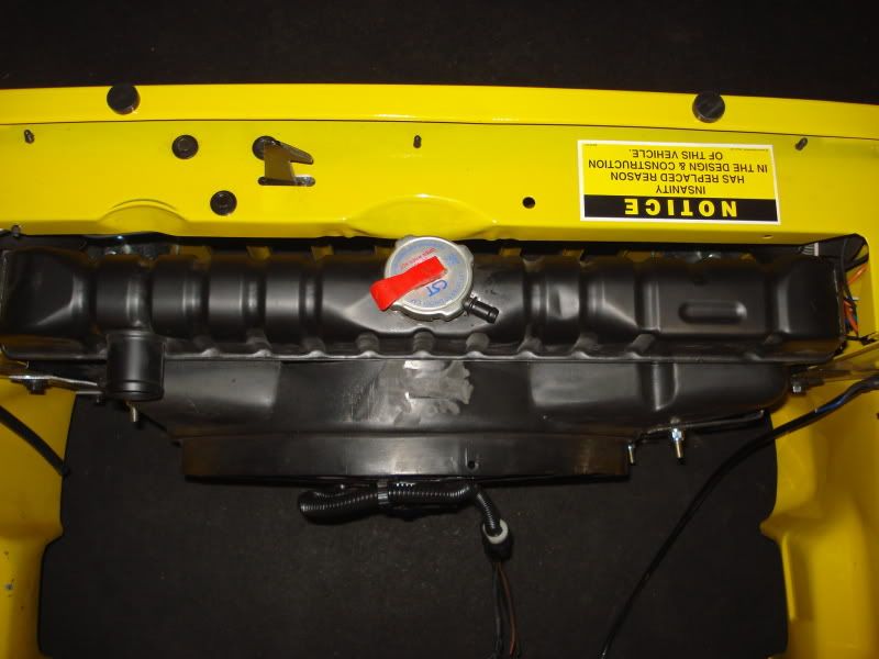

thats a good looking set up fatman. im not bashing you but its not a dirrect fit it dosent cover the entire radiator fins like a stock fan shroud will but the contur fan will. here is a pic of mine as i was wiring it up but you can see it covers the entire radiator like a proper fan shroud should (im not trying to pick a fight or dog your set up so please dont take it that way i was just trying to point out the differance between the 2 setups)
? trust me, you stating your information is not "bashing" me or 'pick[ing] a fight"
To set the record straight, a "proper" fit of an electrical fan shroud does not need to consume the entire air flow area of the core tubes / fins. Several manufactures; asian, european and american allow for areas of their cores to have free pass air flow. Don't be bull chitted into believing everything thrown at ya !
