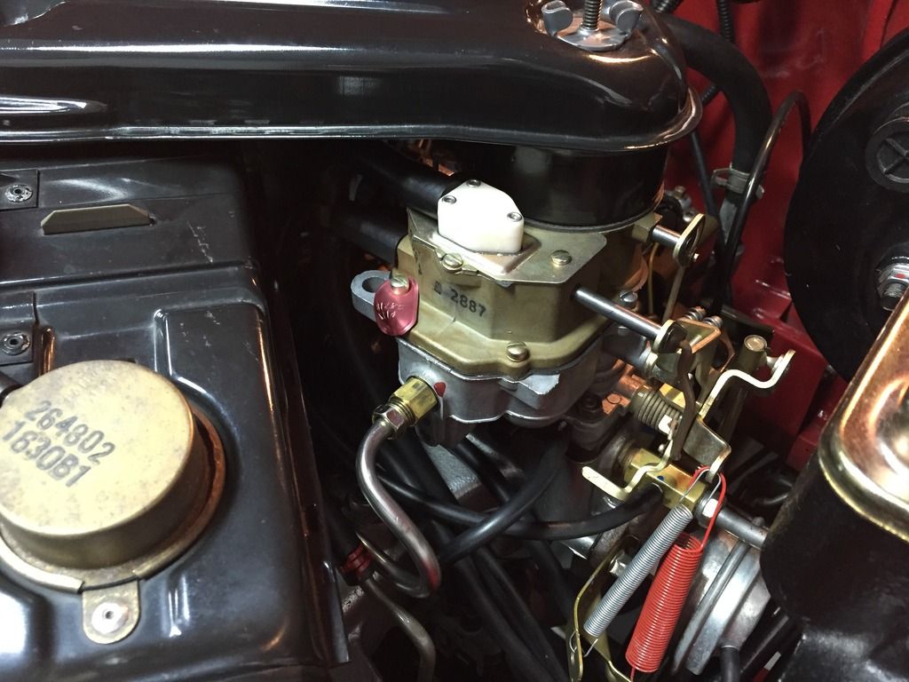

I'm running the 2100 from Groningen and I've had quite the experience with it.
I purchased it after reading his glowing review over how much more exceptional it was over my bbd which had been giving me elusive stalling and hesitation issues from previously being "desmogged" without much knowledge on what they were doing.
So the 2100 arrived and quickly dethroned the bbd from the intake. It turned out to be a bit of a disappointment when I could not come close to getting it to idle. I then turned to texting Gronk for assistance in trying to tune it properly. This went on for about six months of contact attempts with Mike (Gronk) and daily research into possible fixes, but to no avail. Everything I would try would make it seem like I was a step closer, but I could never get an idle under 1300 rpm. I played with the choke, tried changing from a manual to an e-choke. Went back to a manual choke when I found that I could drive it better by playing with the choke when going from a high, choked idle at a stop to opening it up while under throttle. I tried playing with the static timing on multiple occasions when I was able to get into contact with Mike. He seemed to believe that all of my issues were timing related; never understood that. I tried searching for vacuum leaks around the base of the carb and found nothing but a worn throttle shaft. I purchased a reamer and bushings and rebushed the shaft. Again, it seemed better, but it still was rough and hesitated badly.
I eventually decided that I would rip out the entire vacuum line system and rebuild it properly with new components. At around the same time, I had my carb off for about the sixth time and went ahead and did a full cleaning and rebuild. As it turns out, buying a refurbished carb doesn't guarantee that it would be rebuilt correctly. Turns out that one of the idle tubes on the venturi cluster was blocked up incredibly well. I took some advice and used welding tip cleaners to clear the block after about 30 minutes of trying. This alongside a cracked vacuum tee ended up getting me that smooth, consistent idle I had been chasing for months.
Now I adore my 2100.
This rant isn't meant to dissuade you from going with the Motorcraft carb or any other. It's just to demonstrate the point that these engines are old and what we are doing was never meant to work. Just be prepared to diagnose and fix problems that arise no matter the carb. The forums will be your biggest aide by far in trying to solve your issues.

Very thorough and much appreciated. I may just flip a coin between the 38 and the 2100. I don't think I can go too far wrong either way. I want to take the route that will allow me to go back to original spec without too much issue.
Looks like Gronk is out if I do end up going the 2100 route.

The more I think about it, I think I will go this route. No adapter plates, or backing out studs to mount. It will also make for the easiest recovery to original spec when I do a restoration in a few years.
Thanks to everyone for their thoughts on the matter. Timing may push me towards letting my local shop do some of this, but I will report back with some results soon.
