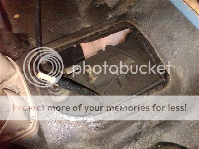

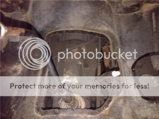

Take the cover over the hump inside the jeep out and post a picture of the top cover of the transmission. That will tell the tale. You may have an SR-4 or a T-4.

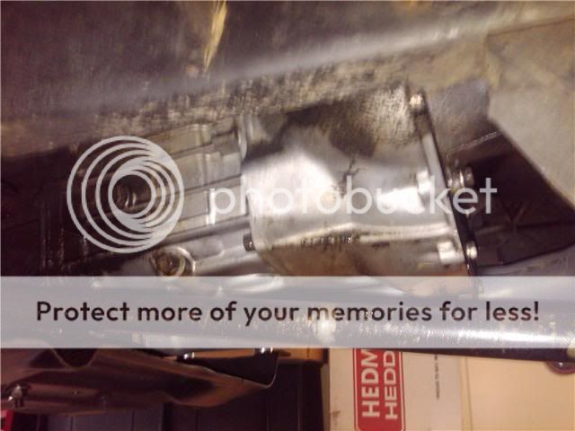

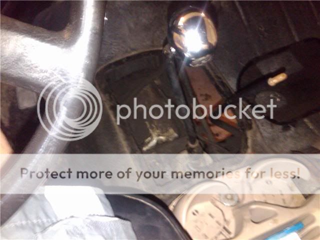

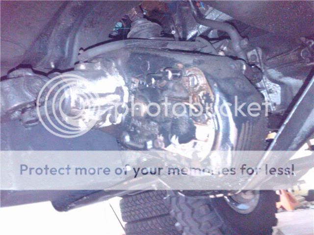

Here we go...
And since where doing this clarity thing, is this the 300?

that looks like the T-4 to me. I dropped and opened mine so Im pretty sure it is.

SR-4 is another Bog-Warner tranny used by AMC for a short while. It's Junk.
You do have a T-4, and yes that is a Dana 300 T-case.
