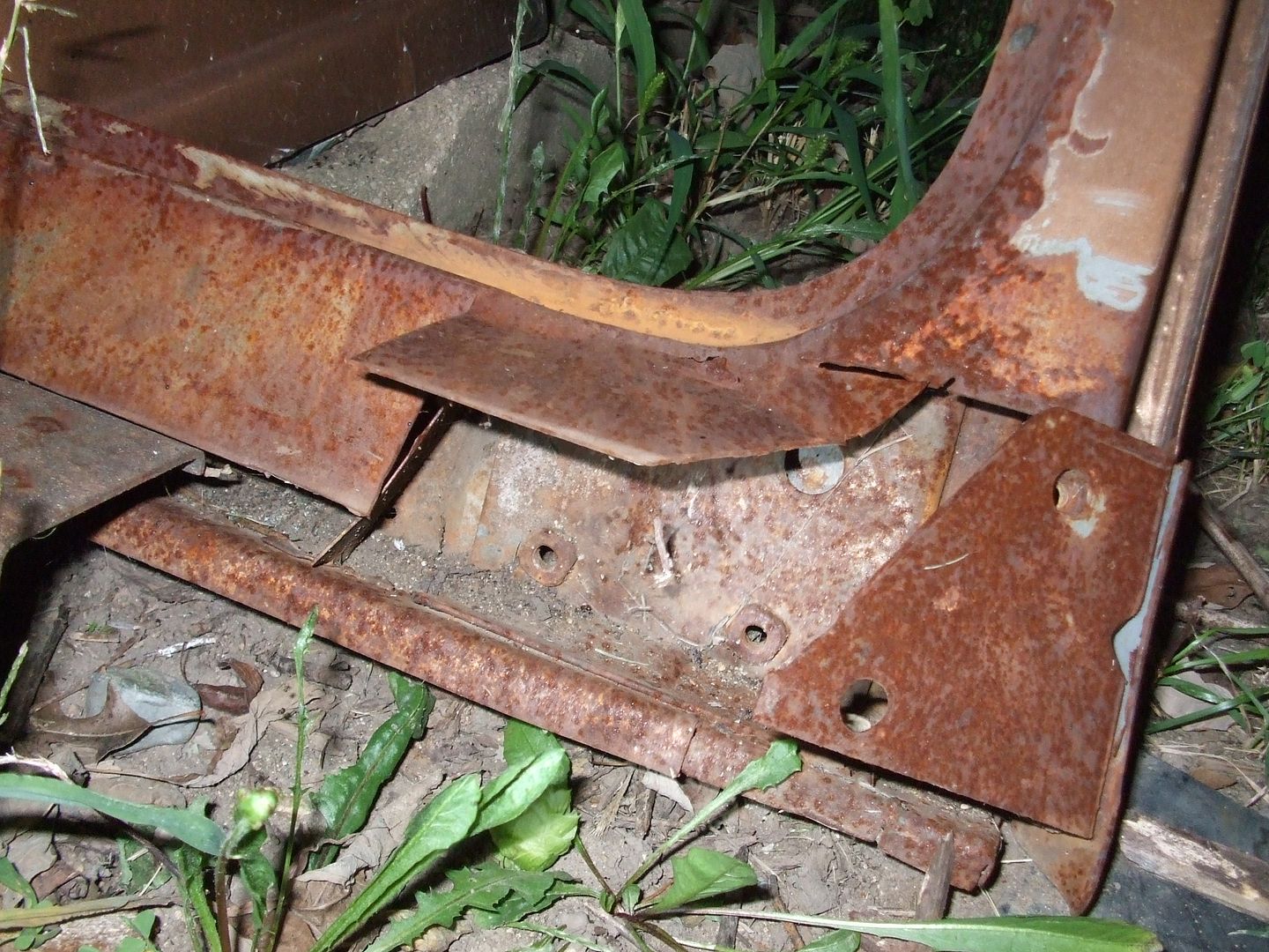

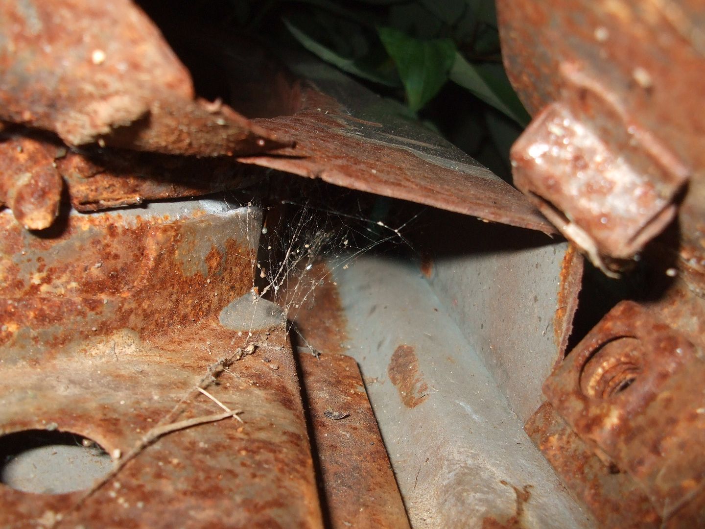

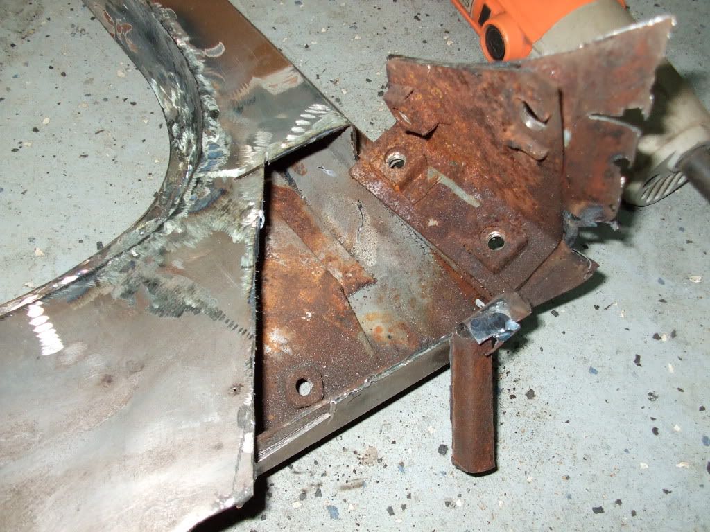

Here is what the inside lower channel looks like. The separator is 2-3" inside the cut.
Since I still have the frame I just went outside and snapped a few more pictures. You can see where the air divider is located. You should be able to reference the location off the windshield hold down nuts.
Up the windshield post is a straight shot.
