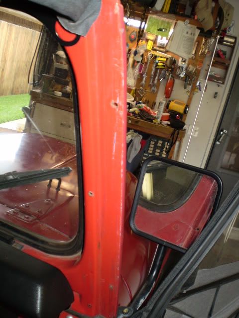

What belongs on this window pillar, i get allot of rain leaking in when i'm driving or setting.
IMG]http://i7.photobucket.com/albums/y285/nichboy/1985%20Jeep/Jeep015.jpg[/IMG]

nichboy, I have a 1980 CJ7 also, I was able to buy some weatherstripping to put up there and actually all over the windows to make a tighter seal with the door. I am not sure what the policy is with regards to posting links to JC whitney, so hopefully this reply won't be deleted. I went ahead and found the stuff you need and here is the link:
Jeep CJ5 Window & Windshield Weatherstripping - JCWhitney
it is a little bit expensive but it gets the job done really well. You can probably pick it up at any parts store as well.

Can you repost that pic? I can't get it to open, and I'm wondering if I'm having the same issue as you. On both windows, I have a space between the front of the upper window and the windshield frame. On the pass., side its about 1/2" at the top, and the drivers side is about an inch. Bestop sent me some collars to use on the doors, and they helped alot, but the drivers side gap was to big for those to help. I thought maybe the whole windshield needed to come down some, but I've loosened the bolts and pulled it down, but it doesn't move enough.

i believe you are missing the front door strikes
i don't know which top you have but heres some for the tiger top
Bestop® Front Door Strike Kit for 76-86 Jeep® CJ-7 with Tigertop™ - Acme Jeep Parts

chuckles0227 i think that is what i need, i'll check it out. Let me try and post my pic agian.

anytime, they just mount on the edge of the windshield and then the door presses up against it when you close it.
I don't know if the 7's have the same issue as my 5, but make sure your windshield angle is correct other wise the doors wont close all the way.
