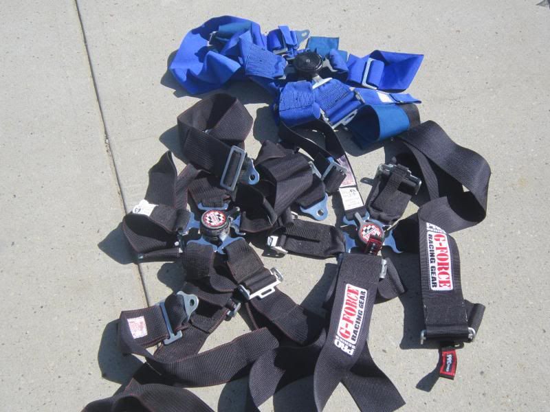

Well I am back home after a Winter in Yuma. I brought back a new gastank, skid plate and some used 5 point harness from a Mexican flea market.

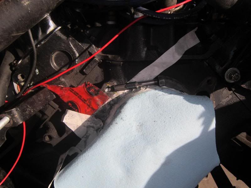

I took off the water pump holding housing and inserted a Heli coil in the stripped hole. I was very nervous when cutting the 1/2 inch thread in to the block. A little worried about breaking off the tap.

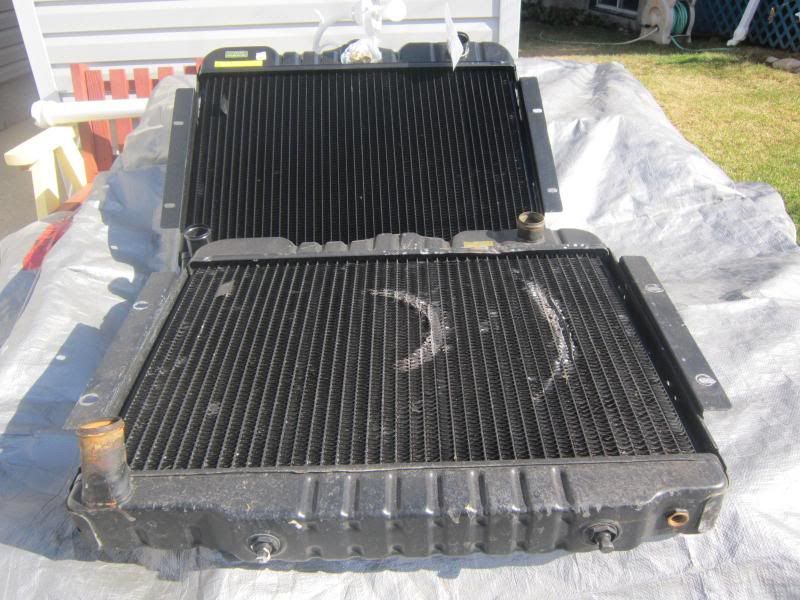

I had been running around town with the rad suspended off the hoses. I didn't want to replace the grill until the new cam proved out. Mistake. I took her down to the creek and climbed up a steep hill. I took another rear universal out and dinged up the rad. I bought a new rad as I wanted all of the passes with a 360. My wife said get those carburetors or whatever they are off the front driveway. LOL
Now I have a problem. I can't get a new gasket in Canada and was thinking about using The Right Stuff by Permatex. I don't know whether to scrap the old gasket off, or just add the sealer to the damaged portion or the gasket. help

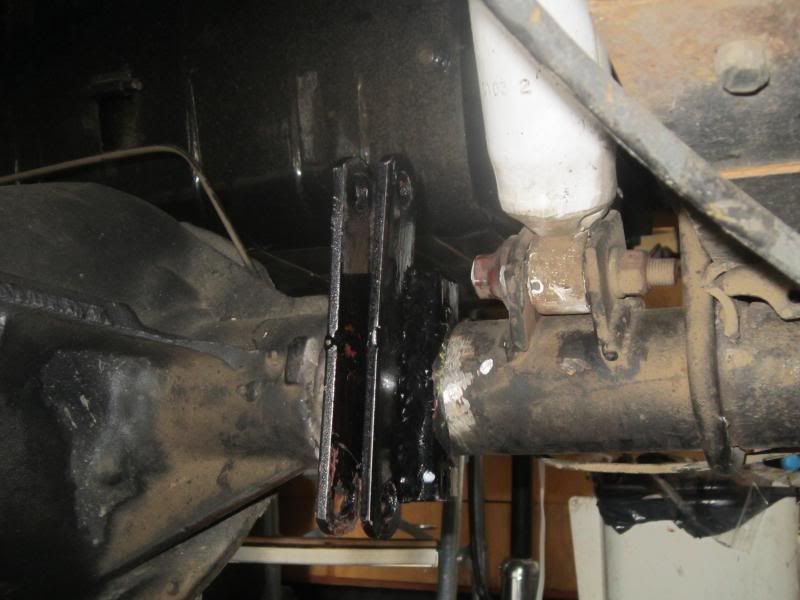

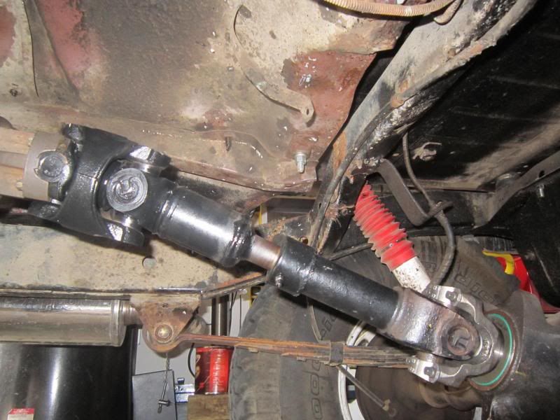

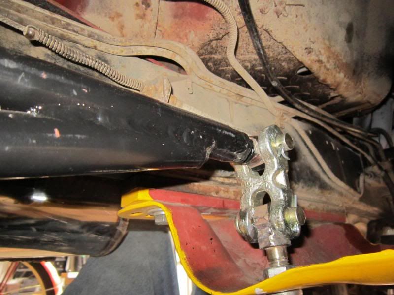

I was going to do new SS pipe bumpers for the back however I put the old solid SS bar bumpers back on for now.
With the 360 I was twisting off rear drive shafts and universal joints so I built a anti axle wrap bracket.
I also acquired a double cardin drive shaft and had it cut down.
The five point harnesses look OK to me.
