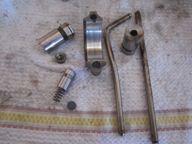

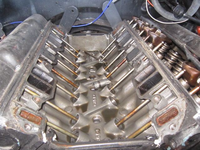

Well I finally got my CJ on the road. I got about 100 miles our of the new rebuild and things went South.
I broke the rings in pretty hard as I had been told was good. Probably too hard as I developed a miss. Found that #3 hole had little compression. (30 lbs.). Took the rocker cover off and found one pushrod on 3 had really gone south.
When I took the intake manifold off I found the pushrod and one lifter in the valley of the intake.
The one lifter was hammered right through and the push-rod bent badly. The bearing on 3 seems not too bad.
I am really frustrated and feel strongly about quitting the project and parting the jeep out. An alternative is to stick in a new cam and see if it will run. I have been told I should rip the engine apart to clean any debris from the smashed lifter out. That's a lot of work and I am tired. Really don't know if I have a problem with the valves becoming spring bound either. What the heck to do????

So I have ordered a new cam, lifters and push-rods from Summit. Gonna take a leap of faith
that everything else is ok. Talked to Summit Racing and they think that the lifters on #3 and others that showed excessive wear were not turning. They said to watch the push rods during break in and if they are not turning, shut the break in down and determine why the push-rods are not turning. I also tried to get some warranty out of Comp but they said that since the order was over one year, all they could do was give me a good price on a new cam.
