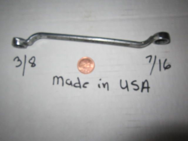

I had a heck of a time trying to tighten my headers until I found this little old box end wrench. It is the perfect tool for headers. The 3/8 end fits the centre bolts that are 3/8 NC and the 7/16 end fits the outer flanges that are 5/16 NC.

You're not supposed to create extra work Don!? I have several of those angled box wrenches. Good to have them when you need them!

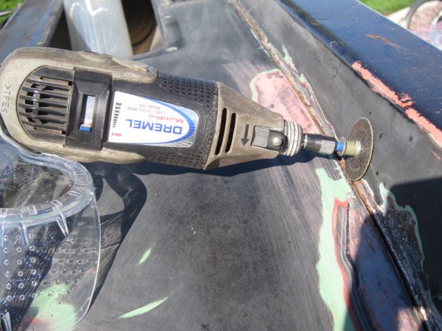

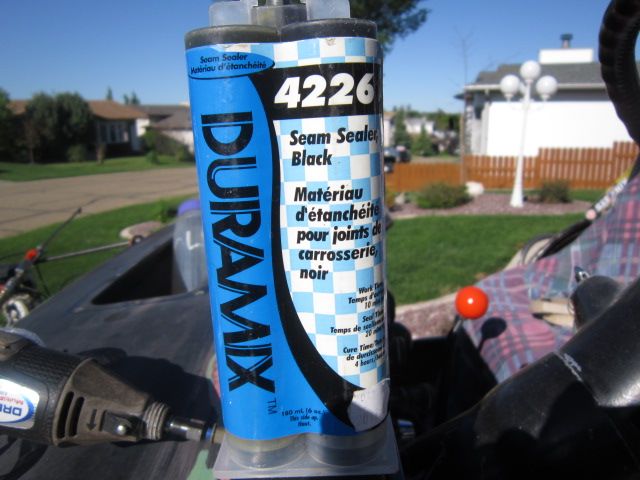

Cleaned out the seam on cowl with my trusty Dremel and filled the gap with a two component seam sealer. I think this is a permanent fix.

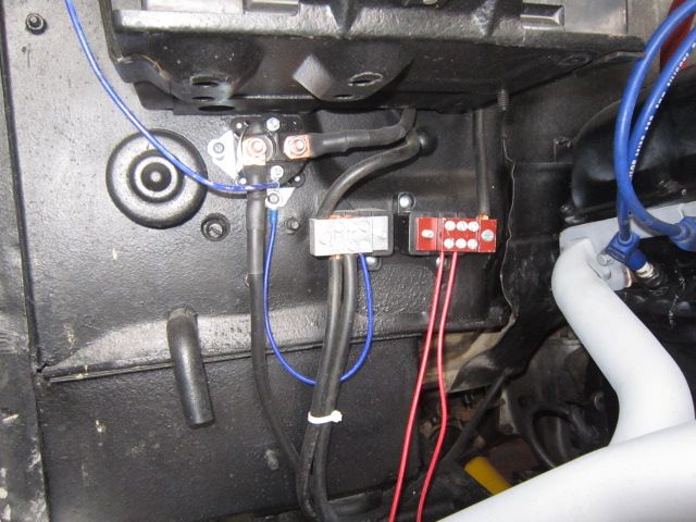

I mounted the starter solenoid below the battery tray. I also mounted two terminal strips from a splitter box for easy access to a ground or hot wire. I have a dedicated ground for the starter and frame. The alternator and rear wiring will get one too. Can you imagine dropping a wrench across the top of those terminal blocks!! lol
Looks good Don......as for the wrench dropping......you know those things happen!
A good reason to maybe enclose those terminal bars inside a cheap project box from radio shack
