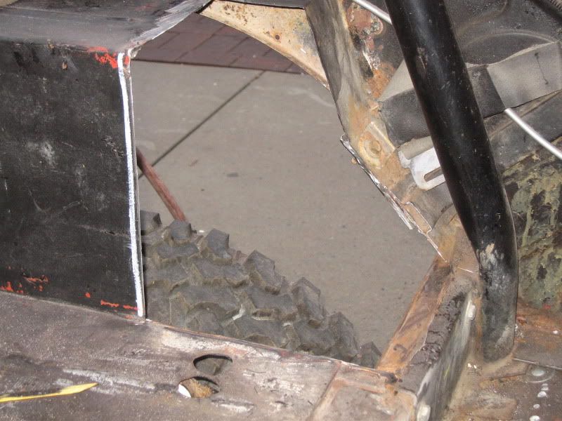

They PO had taken a sawzall and cut out the back of the CJ. I suppose this was for access but made little sense without a tailgate.
I cut some angle and welded on a tailgate stop.

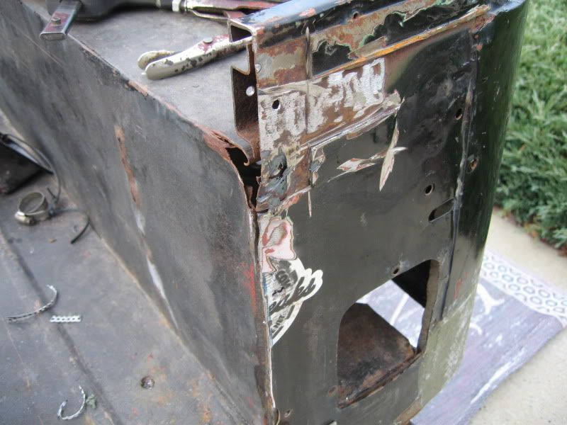

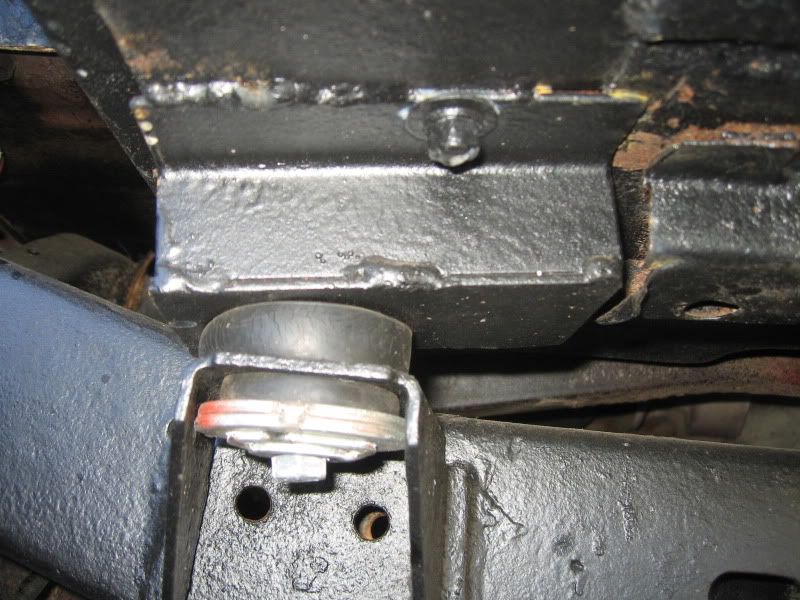

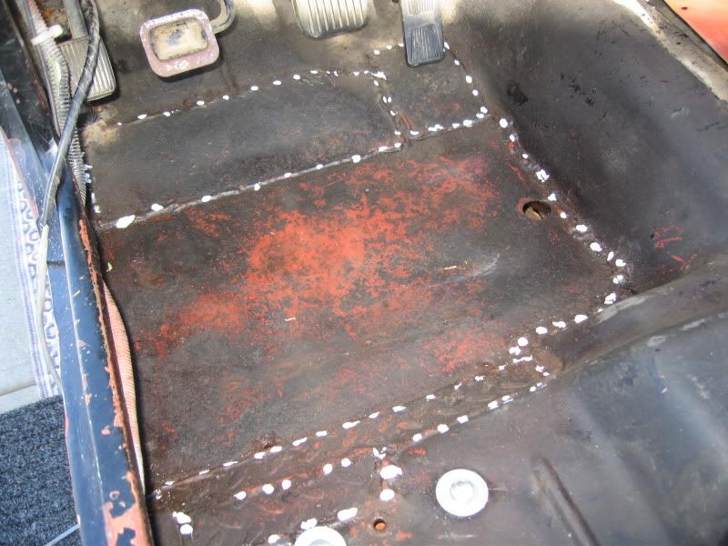

[QUOTE=jeepaddict1;12229415]Hey Splinter, I need to patch up the underside of my tub over the body mounts. It looks like you did a pretty good job. I see some bolts and some welds. Do any of the bolts go through to the floor or are those just lag bolts that went through the underside to hold the plate up until it was welded. If they did go through, I would like to see some pics if it is not too much trouble. Still trying to figure out how I am going to do mine. Your build is looking great so far!
Thanks,
Tom, here are a few pics.
Passenger side mount near roll bar
top view of bolts that go through homemade mount.
patches outlined in white on passenger side

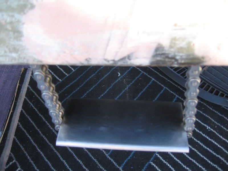

step made from ss chin and a piece of ss plate
driver side patches as outlined in white
bolts through floor board to secure plate
picture of plate from underneath

Don, I really appreciate you taking the time to post those pics. Now I know what I need to do. Awesome work! I am sure that I will ask your advise again! Tom

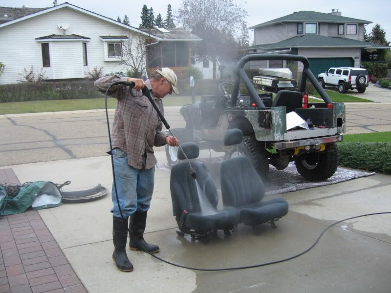

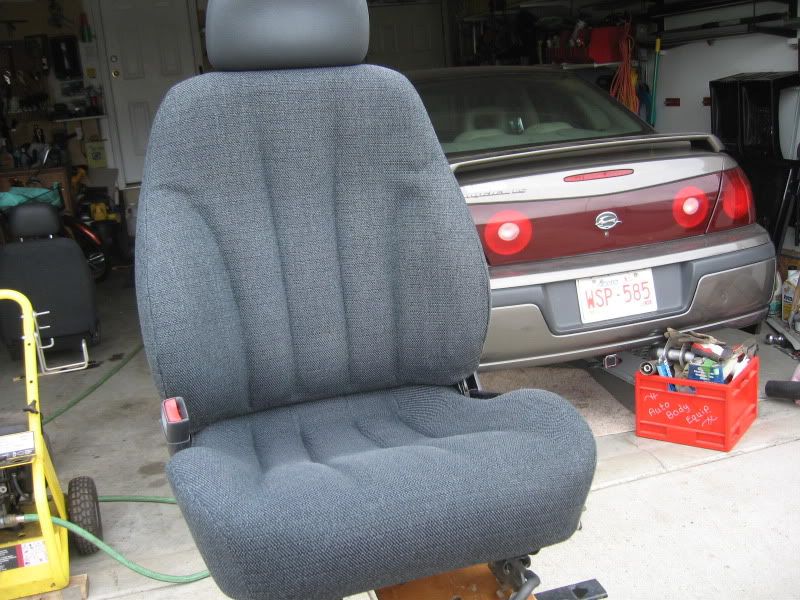

I had read that 3rd generation Cavalier seats would almost be a direct bolt in for a CJ5. I picked up a couple at Pick a Part for $65. I sprayed them with pre-spray for carpets, poured car wash soap on them and hit them with my pressure washer. I then extracted the water with our upholstery attachment on our carpet cleaner. I was quite happy with the results.
Here a few pictures on a mock up. I can use only one original mount. Front right. Notice how high I have to raise the seat in order for the seat rails to clear the deck of the cargo area. Anyone see any issues?
I have the marked the area that will have to be cut out for the notch which will allow me to move the seat back.

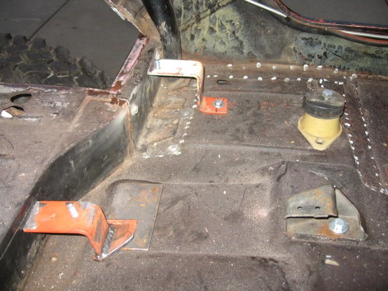

Started on the notch today. It took about 15 minutes with a zip wheel to do the cut-out. And Scott, this was easy but the patch will tax my skills. LOL
This is a shot of one of my gorilla welds with my homemade welder.
Here is a shot of the other mounts. Only one is original. The front left is an is a vibration isolation mount from a compressor in conjunction with a hockey
puck. Whatever works LOL.

I finished up the mounts for the passenger seat
I had cut too much of the wheel well out for the notch. It would have been too close to the rear tire so I modified my patch in panel.
I am happy with the way the seats fit. However there is no room for the original consul.
