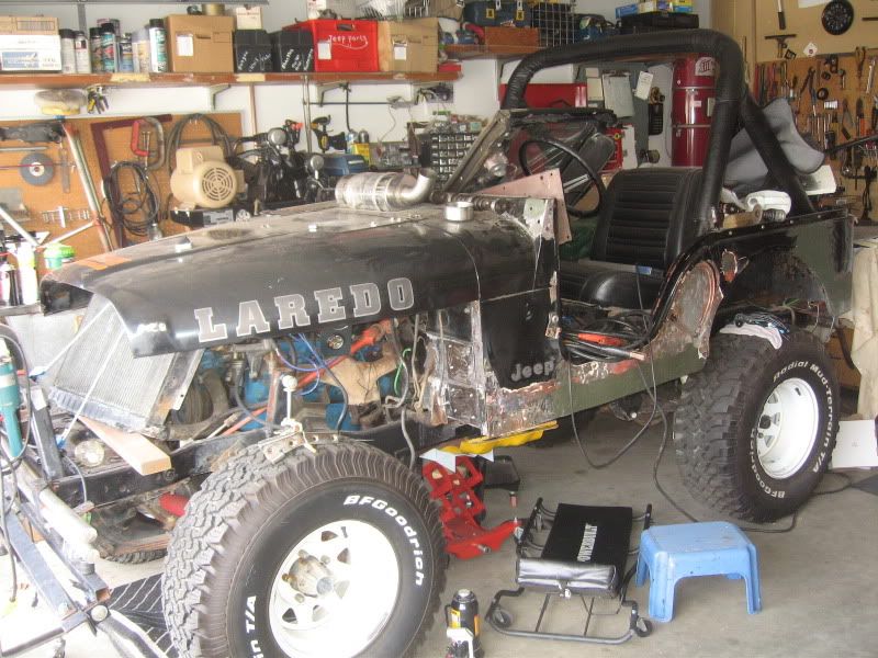

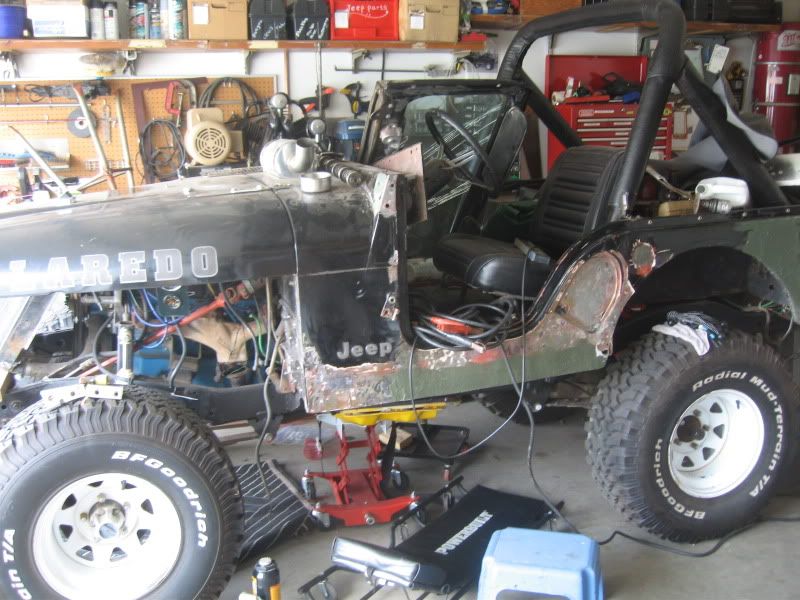

As it turned out the motor had a dead cylinder, but I knew it had to come back out anyway because of the wrong flywheel. I then got sick and my project was put on hold. Seven years later I am in reasonably good health and retired so I am resurrecting this project. This is the way it looks now.
As stated before, I want to drive this CJ so I am not worthy of being in the same class as the builds in this forum. Lots of low talent fixes here to get me on the road. No flames please. LOL

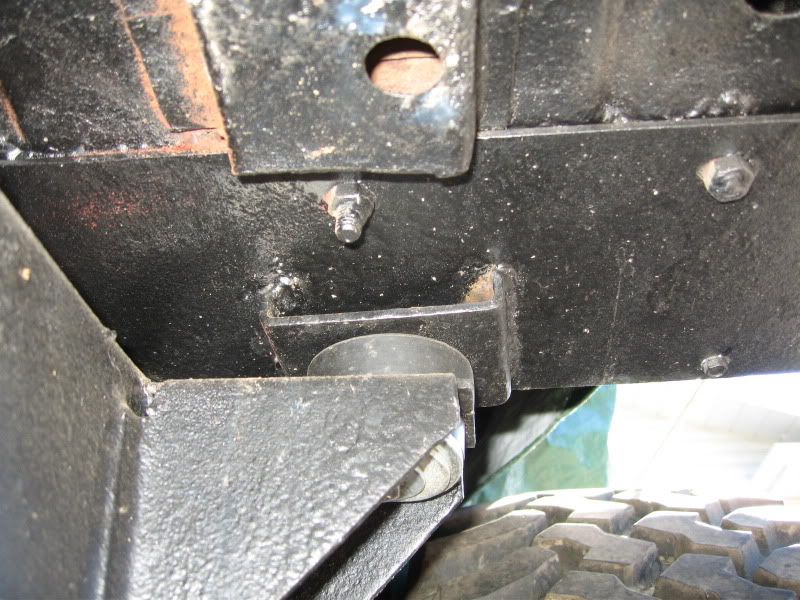

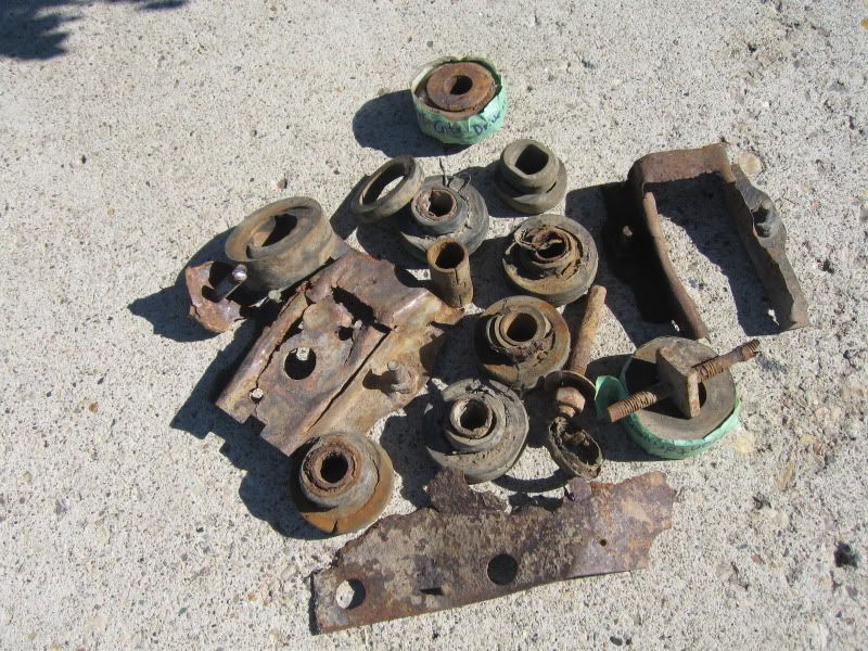

Here is what the body bushig brackets looked like.
I reinforced the tub with plate and made some new mounts. The PO had previously welded checker plate in for a floorboard patch.
Looks like the PO patched the frame here.

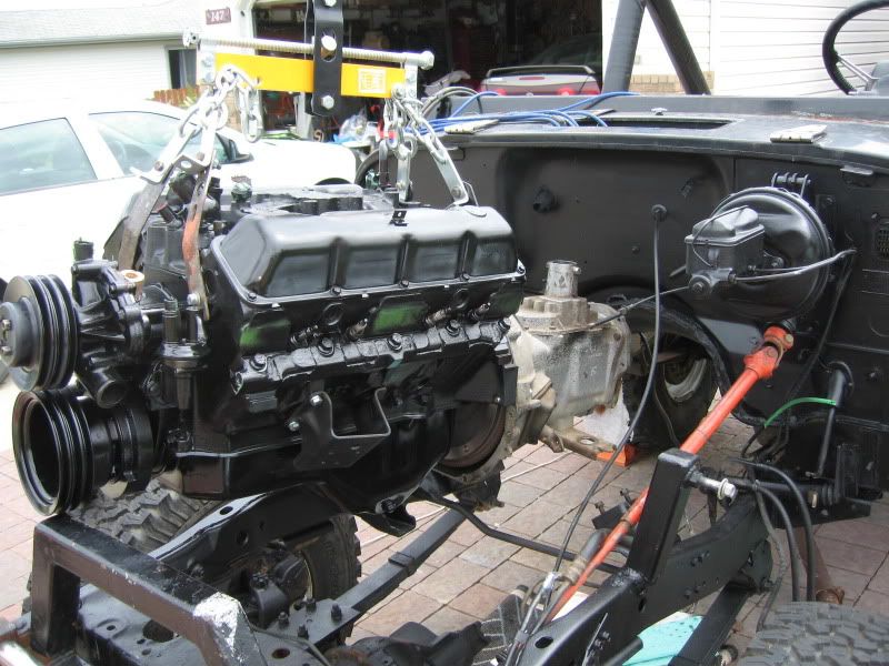

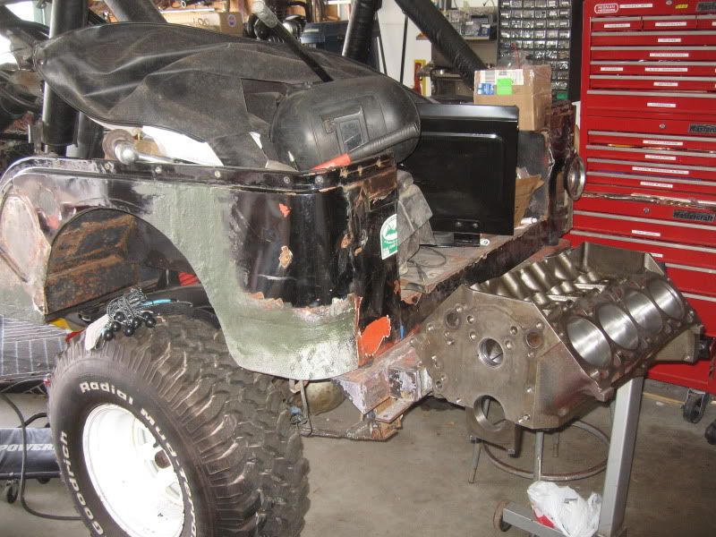

The first junk yard 360 that I dropped in had one bad cylinder so it had to come out. Also to install the proper flywheel.
Meanwhile I had picked up a second 360 which I stripped down and had a machine shop check over. It had already been bored 30 over so they only honed the cylinders and pushed in new cam bearings. They rebuilt the heads and put in new springs to match the comp 270h cam I had chosen. (maybe a mistake).
My son helping set the motor on the mounts.

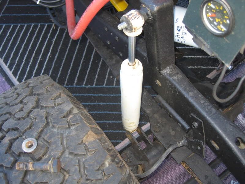

I am trying to determine if I have a wide trac or NT. all 83 CJ's are supposed
to be WT but my measurement of 45 inches to the back of the brake plate does not support this
The front shock bracket is welded to the axle tube however this CJ has undergone a SOA by PO.

Just found your thread Splinter. I always like seeing a bare cast iron engine on a stand. One of my favorite things in life.
I'm not sure when it was started but my 85 has the front shock mounts welded to the axle tube. Good place for them in my thinking. Enjoy the work.

Hey Splinter, I need to patch up the underside of my tub over the body mounts. It looks like you did a pretty good job. I see some bolts and some welds. Do any of the bolts go through to the floor or are those just lag bolts that went through the underside to hold the plate up until it was welded. If they did go through, I would like to see some pics if it is not too much trouble. Still trying to figure out how I am going to do mine. Your build is looking great so far!
Thanks,
Tom
