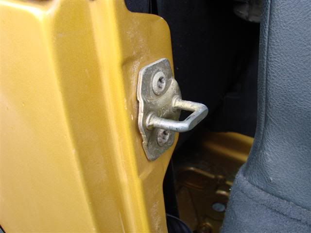

Hmmmm, so the article Jp magazine did on using a TJ top and doors on a YJ must be a bunch of made up hooey.
There are several examples of them being used on YJ's (and for our purposes we can assume they will work on CJ's as well). The only catch would be that the older CJ tubs (I think pre '80 or '81) had a different pillar support where the striker is bolted to. (hence the reason there are two different types of strikers for those converting to YJ doors) So if that support is different enough to not allow you to mount the TJ strikers then, no, those doors will not work. But that is about the only thing that would prevent you from using them.

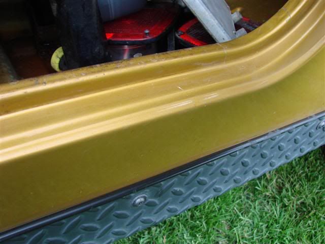

Striker aside (that can be changed or modified at the tub), my main concern would be the seal and tub shaped at the seal...the YJ and CJ uses a sloped or angle of about 45 degrees, while the TJ uses a step down of two 90 degrees.....damn it....I'll go take pics....give me a few minutes.
Ed

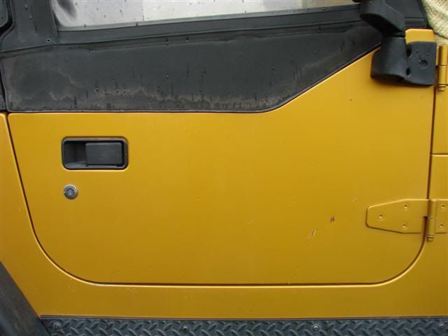

The Inca Gold doors are my 03 TJ Rubicon and the orange doors are 95 YJ doors on my 83 Scrambler
Ed
