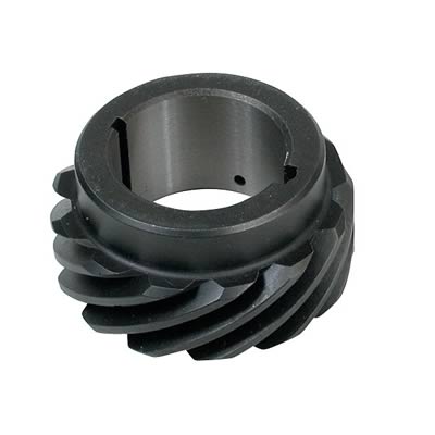

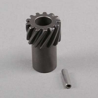

LINK: MSD Ignition 8007 - MSD Iron Camshaft Mounted Distributor Gears - Overview - SummitRacing.com
LINK: MSD Ignition 8005 - MSD Iron Distributor Gears - Overview - SummitRacing.com

Originally Posted by JeepHammer View Post
OP, first of all, take a 1/8" drill bit, and turn the gear 90 degrees from the pin hole.
Try to drill the gear material.
If you can't do much than scratch/polish the gear material, you are a victim of a hardened distributor gear that is an IMPORT.
These things have been a plague on the Jeep community for about 5 years now, and they are causing REAL problems!
I'd hate to guess how much damage (in terms of cost) they have caused to engines since not only do they destroy the camshaft gear,
But they release very sharp metal shavings into the engines as they eat away that camshaft gear!
Actually, I stay away from Bulltear.
The gears I've seen that cause this issue first started coming from Bulltear,
And the 'Owner' denies there was any problems at all.
You can get both distributor and camshaft gears from the dealership,
From NAPA,
And from a REPUTABLE aftermarket supplier, like MSD...
USA manufacture, and they have ZERO PROBLEMS/FAILURES that I know about...
Replying to your message since I used the links you provided to order my msd gears. My question is does the cam gear just slide on or is it a press fit? If it is a press fit does the cam come out to do this? Please forgive the ignorance but I am at my wits end with the front of this motor. I have had it apart more times than I should have. I bought the garbage from omix ada and gears are not even close to fitting. Also looks like the gear that goes on the distributer has to go to a machine shop to be installed, is there any back yard mechanic method to avoid this? If a machine shop is the way to go then no problem I will take it. Thank you for any input you provide.

Matt,
I was wrong earlier. Looks like the distributer drive gear is a slide on with a keyway. The end-bolt holds it all together.
