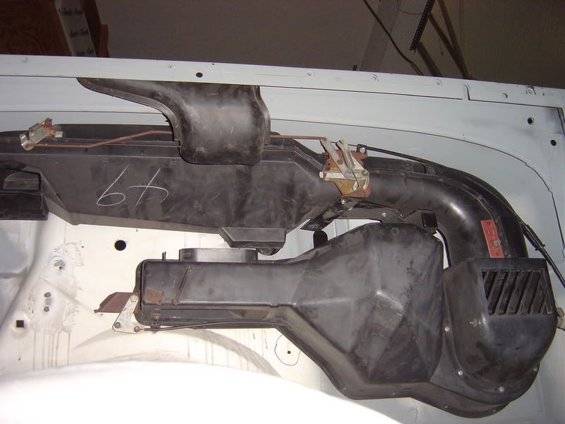

You might be able to lay on your back and look up behind the radio.
Pic with out the accordion hose:
Have you done the "Heater Blower Fan Upgrade" ? BIG difference

Originally Posted by Bubba Ray
I have not done the blower upgrade because heat has been ok. Is it possible that when I pull the defrost knob out that it is not open/closing a flap somewhere?
If the floor stays on when you pull defrost, then yes, it is disconnected some place. It is the lever on the left above the heat one on the box in that photo
