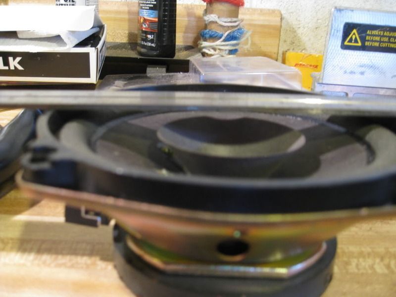

I replaced both of mine without pulling the dash, and I have large hands with fat fingers.
I used speakers made for Harley Davidson motorcycles, but they may not work with your head unit.

The Bazooka MCC5252 speakers sound great for a 5-1/4 speaker. A huge improvement over stock.
They are a 2 ohm speaker, however, so your head unit needs to be compatible.
I use the Retrosound head unit below, along with a Rockford Fosgate 300 watt amp in the center console, and Infinity 6x9s in the rear.
