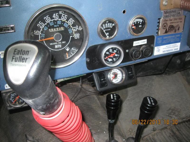

i use the advance adapter twin kit and after couple times engaging the various combinations one can tell pretty quick whether its in hi, low or N. doing lights sounds complicated, but cool factor for sure.
edit: in this pic the rear (left) is in (forward) low range position to manouver into and out of shop and front (right) is at neutral. (if front hubs are disengaged, it doesn't really matter) but one can clearly see the split between the two
I think ill figure it out, just thinking coolnisity while its sitting on the bench!

RareCJ8, is that a SCCA plaque on your dash?
No, sorry. Some are from the now defunct Nevada 4 Wheelers Association, one is from California Association of 4 wheel drive clubs and the larger is a dash plaque for the annual sierra Trek-- specifically 'star trek' the fabled night run.
