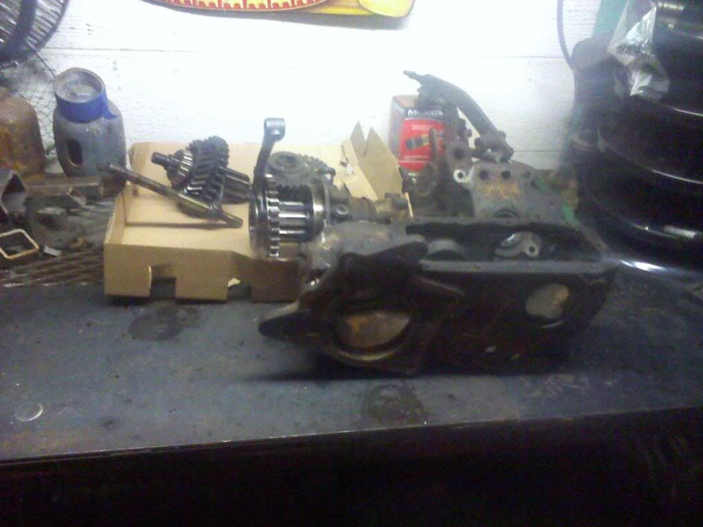

hey got my transfer case out of my 72cj5
i bought .i pulled it because it was full of water .i pulled it all apart. now im wonderin wheres the best place to get a rebuild kit?also what twin stick setup would yall reccommend ?if it dosnt have the new shift rails how difficult is it to grind em down .this is my first jeep but not my first rodeo with 4x4 trucks but the jeeps are new to me.and this thing needs a ton of work haha

I got my kit from novak-adapt.com. They also sell the twin stick setup you spoke of. $240.00 ish for the master kit and $120.00 ish for the twin stick. the kit doesn't come with the shift rods but it has some little sleeves that slide over the ends with a bolt through the holes to secure. They have good pictures for you to look at and lots of great information too.
I'm just curious, what transmission was your Dana 20 bolted up to? Could you post a good picture of the complete mounting surface on the Dana 20 that attaches to the transmission? Thanks 71cj!

t15 ill take a picture in a while
