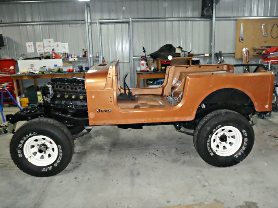

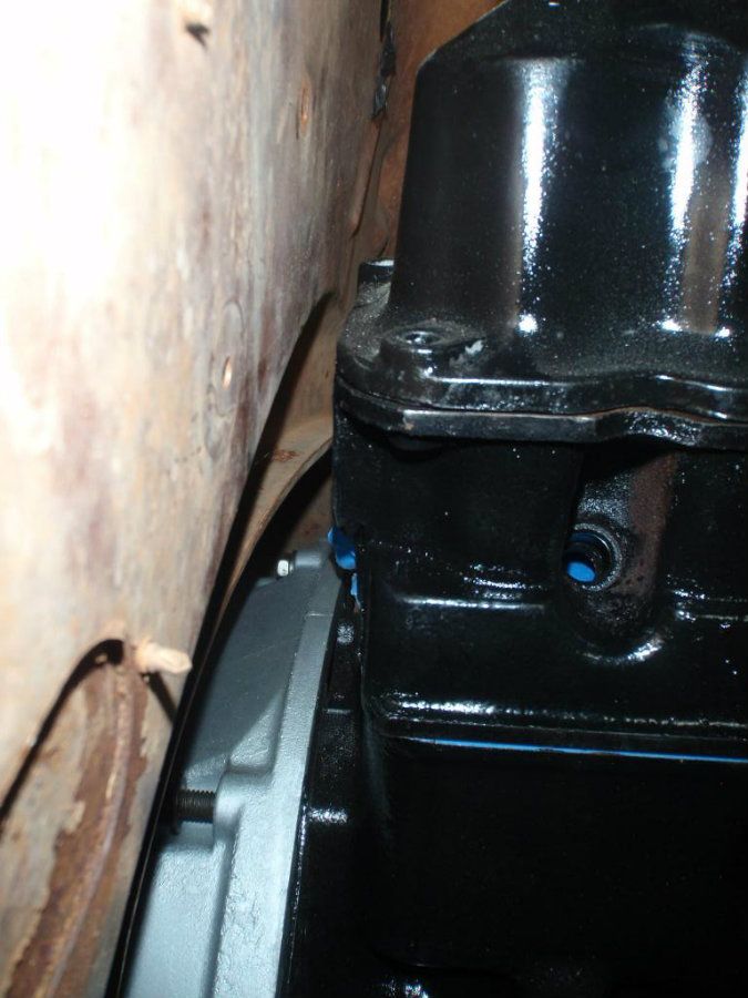

I've thought about clearances and clashes since I changed transmissons. I was pretty sure the gearshift was in the same position but had to see if the the clocked D300 was going to have issues. After I got all the body mounts cut down to the right heights I couldn't resist putting the tub on for a look.
I've got 1/2" clearance from the back of the head on the stroker to the firewall. I hope that is enough. I have the engine angled at about 6.5 degrees down.
After I got the tub on and found I have no issues with the engine and transfer case I couldn't help myself and got carried away with a few more body parts
Good stuff Dan. Going for a bit of instant gratification huh? Pretty easy to get carried away isn't it? Looking good

The disease! Looks great, Dan. I think the 1/2" is enough clearance.

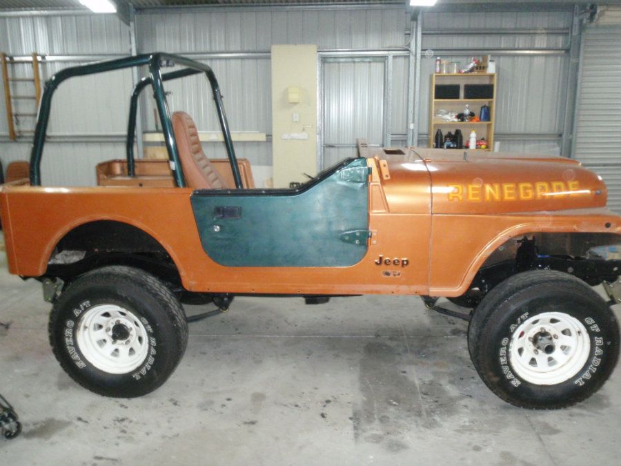

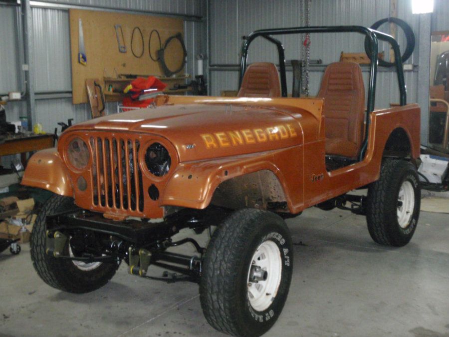

Lookin' good Dan. Heck add the steering wheel and get the kids to push you around the yard!
Is that roll bar setting higher than normal? Maybe the seat is lower. Could be just an optical illusion.

Haha, my kids got a kick of sitting in the seats, and there wasn't a fight over who got to sit behind the wheel!
The roll bar is the one I had in the YJ, it does look a bit high in the photo probably because the whindshield is missing.

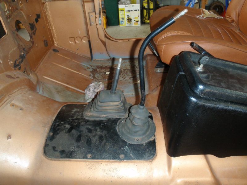

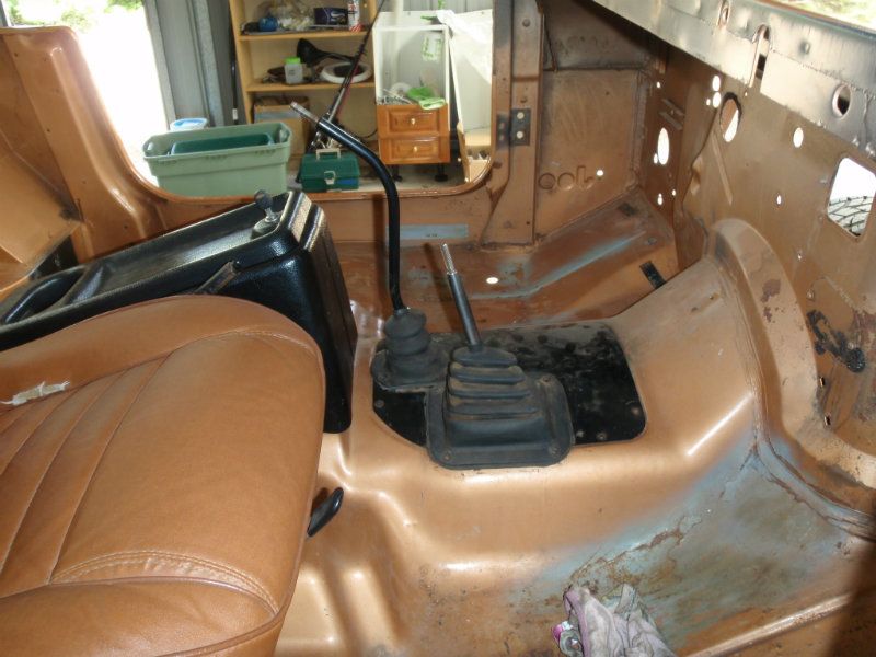

I've now back to serious stuff and taken it all apart again. The AX15 gearshift is spot on the same spot as the T5 but I have issues with the transfer case shifter as it is clashing with the tub after I had to rotated it up to fit onto the AX15.

I got myself I new a new mapp gas torch on the weekend so I put it to work to get the gearshift bent to fit in the stock position. After heating-bending-test fitting over and over I got a position I'm happy about. It looks to be in the same position it was before I rotated it to fit behind the AX15. I didn't take a photo of the stick after it was bent but I will soon as I now have the tub off ready to take it all apart again to put in the clutch and fabricate a transmission mount.
