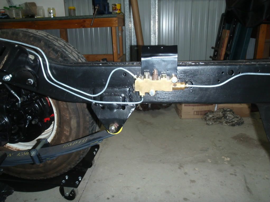

Here's a view of the proportioning valve on the right hand side.

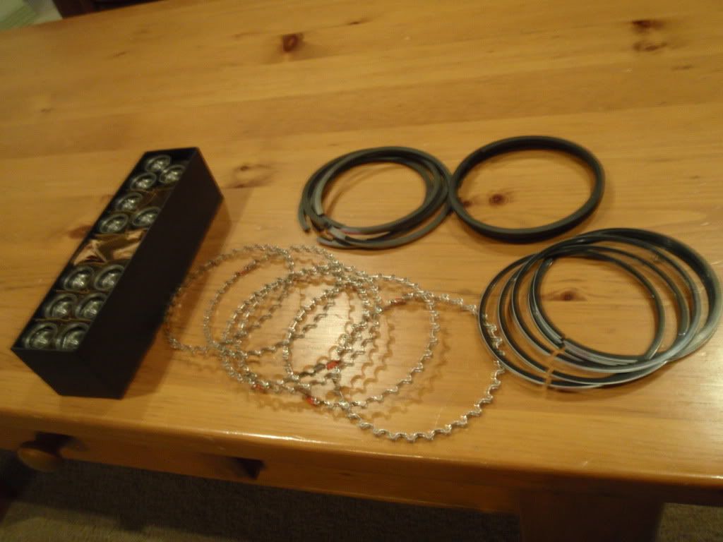

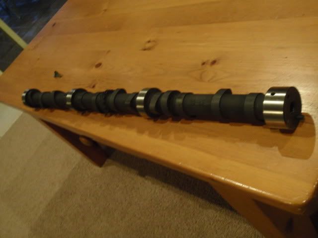

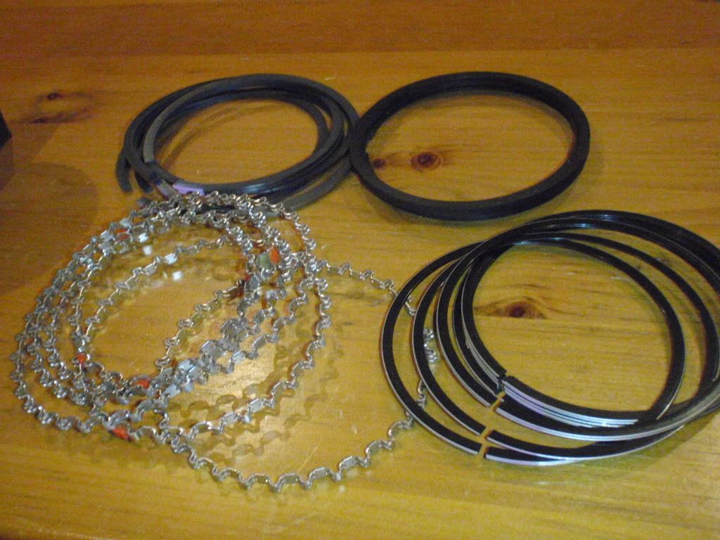

Good news is today the pistons/rings and cam/lifters were on the step when I got home! They are the last bits I needed to finish the stroker. Hopefully I will have a new engine to show off in a few weeks.
Keith Black 2229c Pistons
Ring set
New Comp Cam 69-115-4
Lifters too

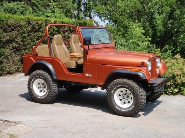

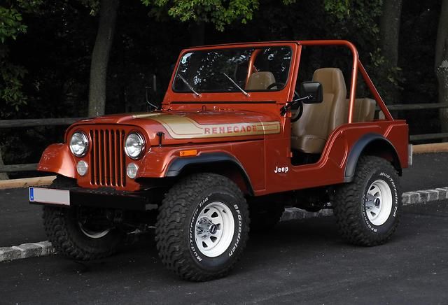

I've been thinking about colours for as long as I've been doing this resto and I came across one I really like. I was hoping someone here could help me identify the name of it. I think it would look really nice with my white roof or a tan softtop.
The gold stripes is what did it for me. Although I have an 84 I'd still use that stripe.
