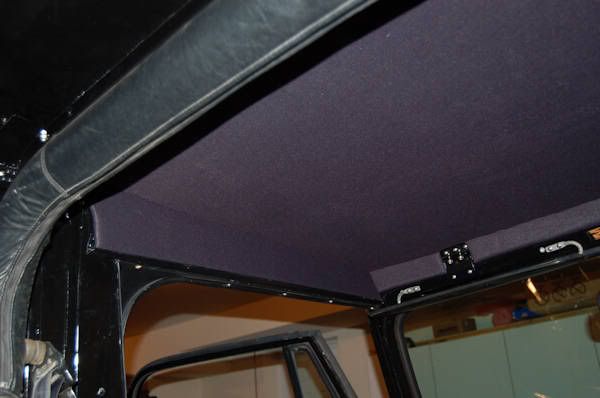

I wrote the answer to that in the post that you quoted... I used 1/8 chipboard, a type of cardboard, it's available at art supply stores. I also used this when I made the headliner for my World Cab. Here's a photo of the headliner. Both the door panel and the headliner have been in the Jeep for several years, they're like new still.
