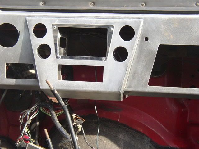

Wow! Nice work Dislsmoke. Do the upper gauges clear the defrost duct? How much do you get for a dash like the one with the radio cutout?

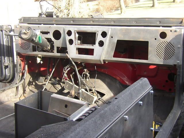

Dislsmoke
Location: lititz, PA
Posts: 176
Yes the upper larger bezel will clear the duct. It's not that much higher than the stock gauge. Most of the full replacement dashs like above are $180. If you want speaker slots it would be a little bit more. I get all the dashs laser cut and the bezels are on a 20 degree angle to the left and up so you can actually read your aftermarket gauges. If you pay over $150 for new gauges you might as well be able to read them easly. The bezels are thin wall dom tubing welding in, they fit 3 3/8" tach and speedos, the others are for 2 1/16". Dashs are just a little thing I do on the side at my home shop for the CJ guys, I know the aftermarket world sucks for us. I haven't done one dash that is the same yet, everything is custom made to what you want, not what you can buy out of a magazine. Thanks if you would like a custom design just drop me an email. I'm not trying to be a vendor or sponor my work, just love to make dashs for the CJ lovers of the world.

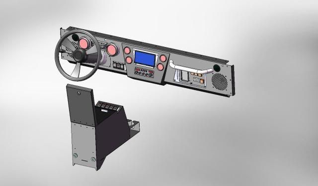

Dislsmoke
Posts: 176
The gray center piece is only $80.
