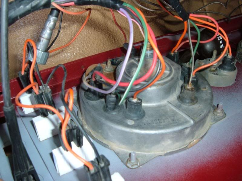

I may have my grounds and power reversed on my dash lights any one have a pic of the correct orientation?
Only light that comes on is the oil pressure.
Here are mine:

I don't believe it matters, incandescent bulbs illuminate regardless of electrical polarity.
Your dash looks super clean... like it might have recently been painted...
Make sure things are well grounded. It is easy with our CJ's to get insufficient grounding. Bad grounds can fry your fuel level sender in a big hurry too.

Rocksquash is right, it doesn't matter the polarity. Just make sure you have a good ground for the rest.
Are you trying to test the dash while it's off the tub?
