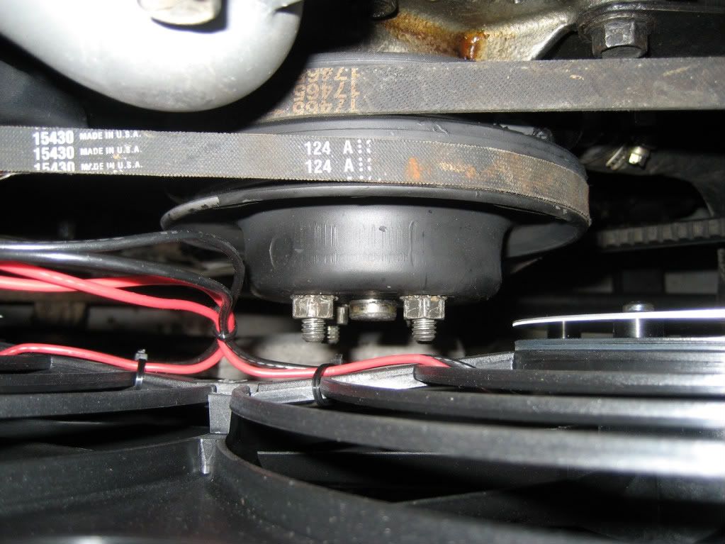

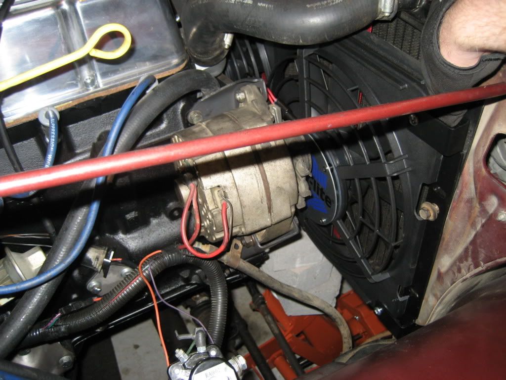

Well i thought I'd update this and solicit some more help. As you can see from my profile, I've got a Warn 8274 winch installed which is massive. I took the winch off and took the jeep for a drive, temps stayed constant at 210. So I'm guessing at highway speeds i'm not getting enough airflow through the grill and the clutch fan is not working hard enough.
So i went ahead and spent the big bucks and ordered a flex-a-lite 575 which is supposed to be fit the CJ like a glove.
I removed the clutch fan and shroud, and I went to install the new electric fans. Problem: I've got maybe 1/4 to 1/2 inch clearance between the water pump and the fan grill, and there is a big gap at the top of the radiator. Any thoughts? I'm stumped at this point. I've read the directions about 10 times and i'm pretty sure i've got everything setup correctly....
pictures enclosed (the wiring isn't hooked up, so ignore that)

I believe that i have the "high performance" 2 core model (with the driver's side rad cap). There is a 3 core that is actually cheaper, but people claim the 2 core actually works better. I know the 3 core is quite a bit thicker and has a center cap.
I guess i could drop the $200 on the 3 core radiator, but even then i don't think my new fans will fit. I'm assuming the 3 core will have the same..or less clearance!
Maybe i'd be ok with the clutch fan and the new radiator. I'm about out of options.

One way to get more fan clearance is to remove the studs in the water pump pulley flange and use short bolts to keep the pulley on.
