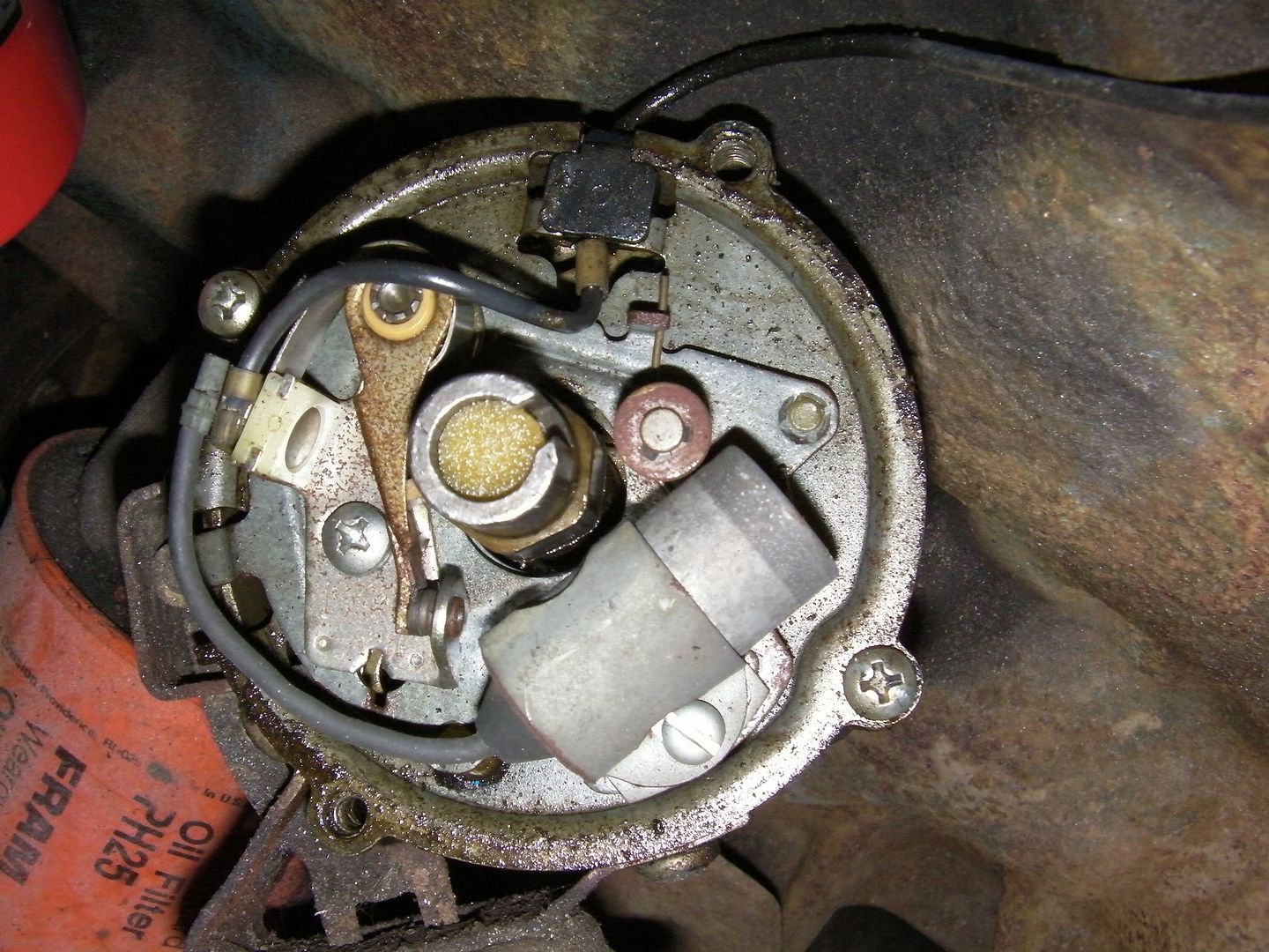

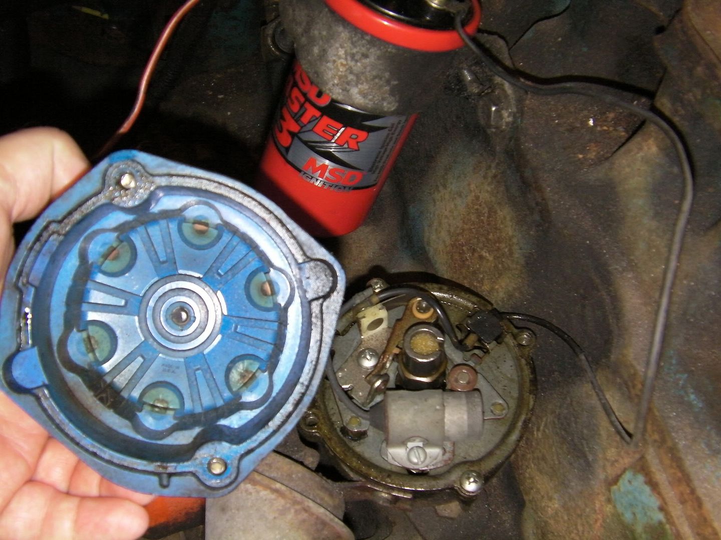

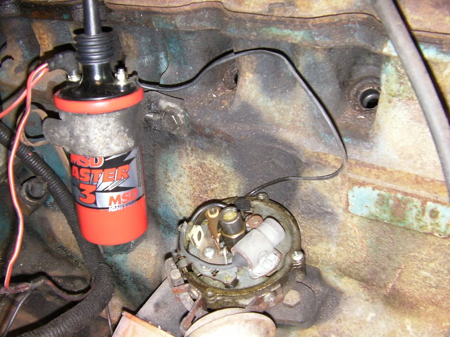

I bought a project and started to do the "Team Rush" upgrade. But my distributor screw holes and recesses (for the screws to hold the distributor together) are 90 degrees from each other. All of the other pictures I have seen (and the spacer I bought) show the screws and recesses about 1-1/2 inches from each other.
Also my new rotor's groove is too wide to fit into the slot on this distributor.
I will try to add pics of what I have. I think the PO did away with any computer wiring too, but i will save that for another thread.

That's a Prestolite distributor. You can't do the Team Rush upgrad on that one.
If you put an '80s Motorcraft distributor in the Jeep, you can do the upgrade but you'll need a different ignition box. It could be a good time to change to an MSD 6 series (or clone) ignition box.

thats not a prestolite its a points distributor. I used to have the prestolite ignition and it is magnetic not points and condenser like that distributor. Outside of that I dont know the specifics. I changed mine out for a CRT HEI several years ago and havent looked back and havent stripped a cam gear either, I made sure it wasnt a hardened gear.

Thanks... Delco perhaps. Neither is suitable for what the OP wants to do.
Wow... The last time I worked on points, it was on a '67 MGB about 32 years ago.

You have a couple of options.
1 You can do a swap and drop with an aftermarket HEI.
2 Convert the system using a Petronix electronic ignition upgrade
3 Do a complete electronic ignition swap by installing components from a donor vehicle.
The HEI is by far the easiest. Minimal wiring upgrades on this one. Just insure you have the proper cam gear.
The Petronix will allow you to revert back to the points if it goes bad and will use the existing Supercoil.
Without knowing what the PO left behind, it will be difficult to give advice as to reverting to stock.
If you plan to keep the points, install 8MM wires and open the plug gaps to .055. Also insure the PO installed a ballast resistor to keep the points from frying.

You have an old style points distributor that is real easy to trail fix if it gets dirty or even real easy to just carry a spare set of points. Those systems worked for a lot of years....
Once you go electronics, then you need a whole box of spare parts if you plan on wheeling way back in the middle of nowhere, no parts to fix, just replace.

Thing only problem with attempting to revert to the stock electronic ignition is we don't know what if anything is left of the original wiring. This means that he may have to locate additional components and loom items. While doable, it may be cheaper and easier to go to an HEI or Petronix. I prefer the HEI as it is a simple one wire hook up. It also gives you an adjustable vac advance and parts can be found at any FLAPS. The Petronix gives the added security of having a redundant system in case something "strange goes on and it fails. Personally, I believe either of these options to be a much easier install than trying to hunt down or fabricate a stock replacement loom.
