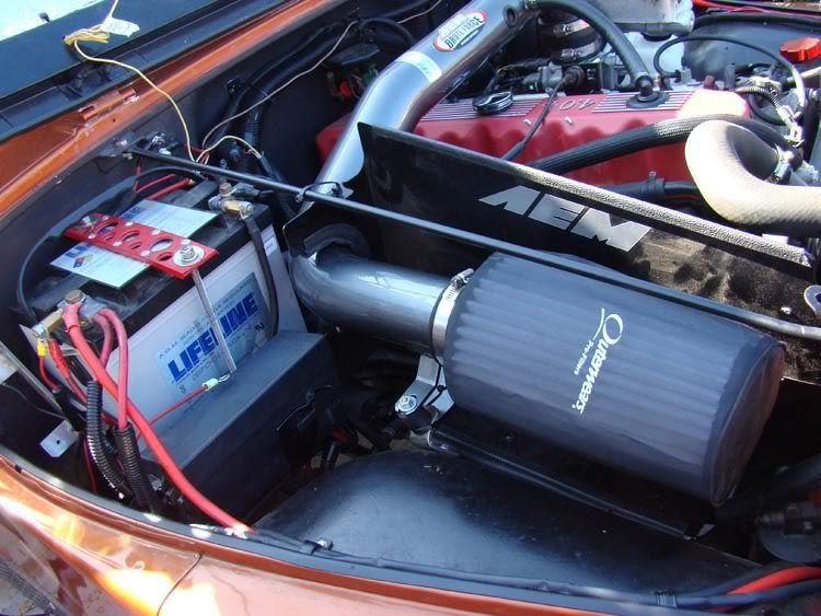

I got this aFe kit at the Truck Fest for $200: Cold Air Intake System Stage 2 Jeep Wrangler (TJ)- 97-06 I6-4.0L 54-10142 - aFe Power
Started by bending the tabs out of the way so I could get it close enough to the fender for fitting.
Trimming to be done on the forward mount.
Before
After
After much on/off, on/off and some "creative" bending, tabs are ready for drilling.
Holes drilled and mounted.
Some baffle material to insulate the fender from getting chaffed.
I had the extra task of slotting the rear of the shield to make room for my hood struts. It took me more time to do that than everything else.
I have the PCV and canister hoses T'd off for now until I can find a fitting that goes into the second location in the tube for a cleaner look.
The seal the system comes with isn't tall enough to seal against the hood so I'll add (rivet on) some aircraft baffle material to completely isolate the box from engine cmpt. heat.
