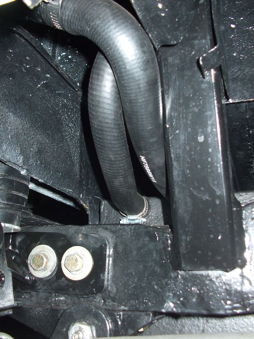

There is a 3/4" air vent to the left of the filler inlet. It is probably closer to 1/2" ID by the time you add the thickness of the metal. The vent tube actually runs from the tank to the top side of the filler neck just like the factory setup. I noticed that if I turned the nozzle 45* to the left, so the nozzle kind of matches the bend in the fill tube, it took fuel faster but still wouldn't allow me to use the first click on the pump handle.
Yeah,, not vent it's the bend...I do the same thing twist nozzle for best flow...YJ same issue

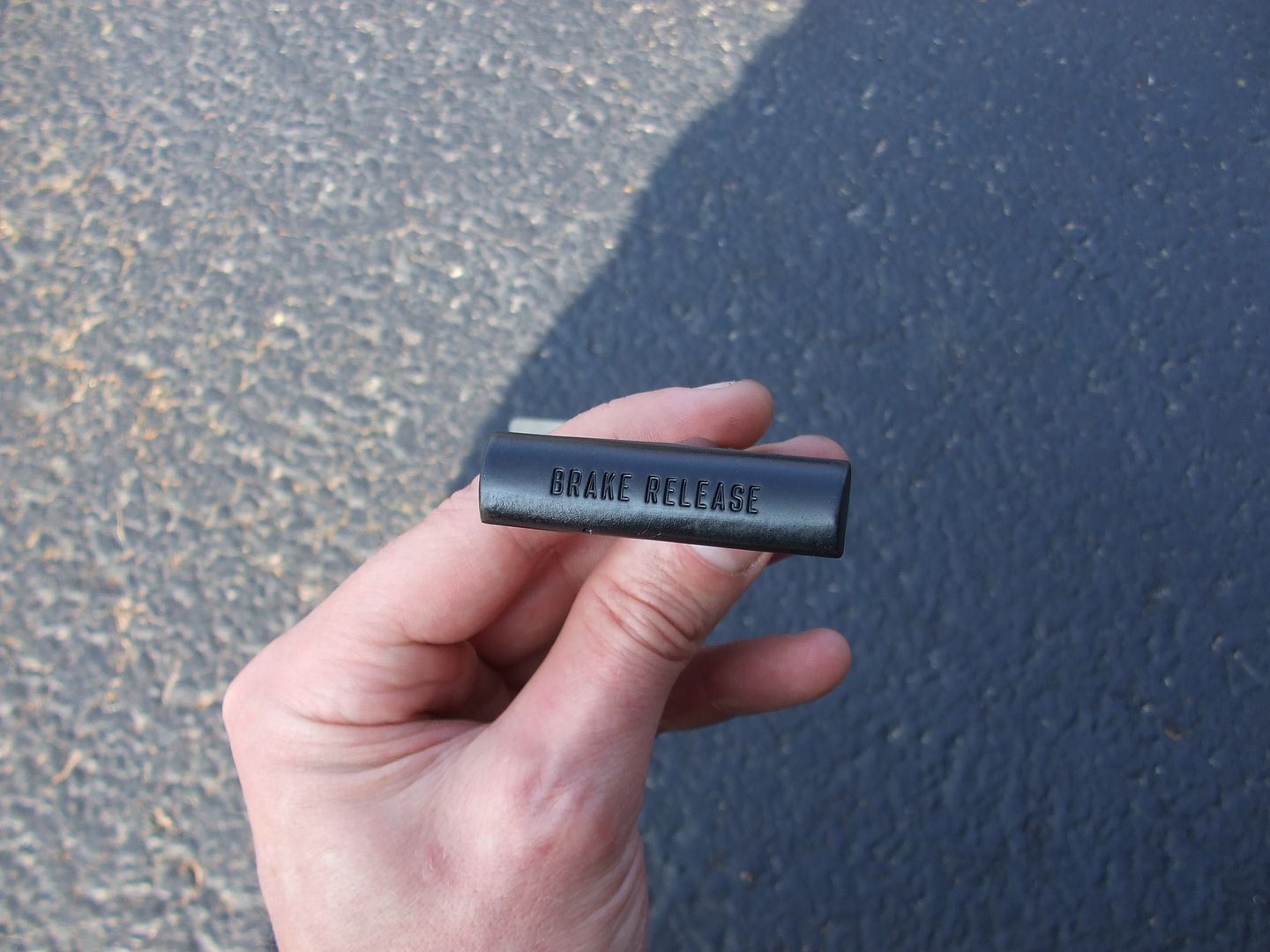

I was looking through older pictures and found something from a month ago that is worth sharing. Maybe this will help someone out.

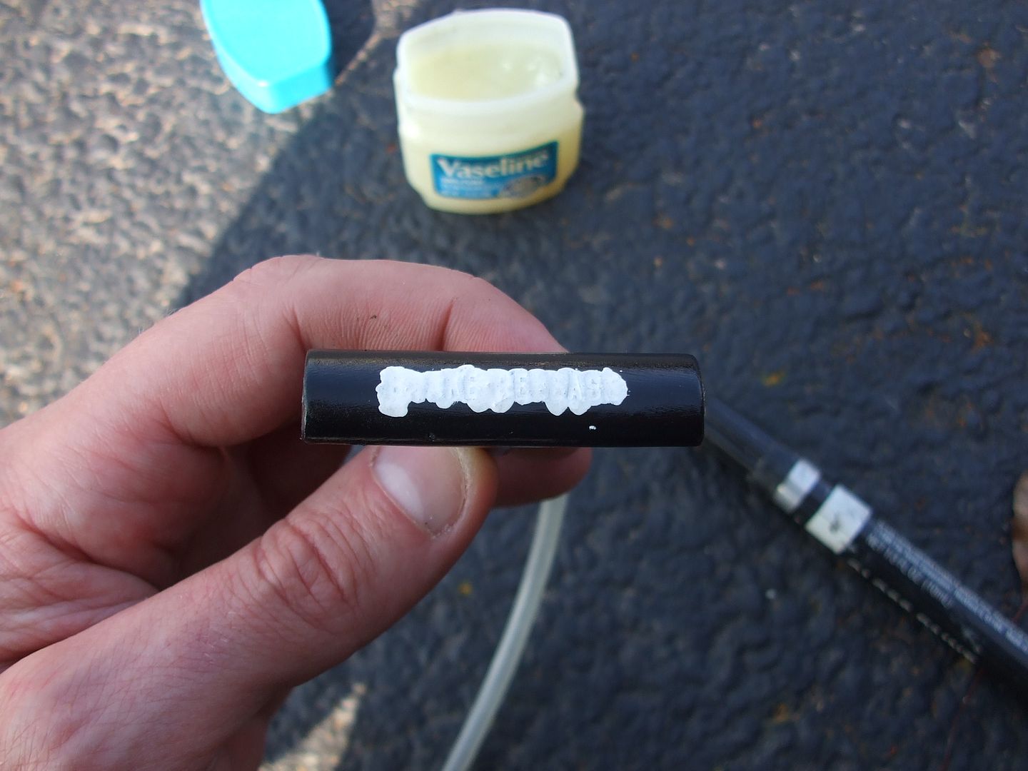

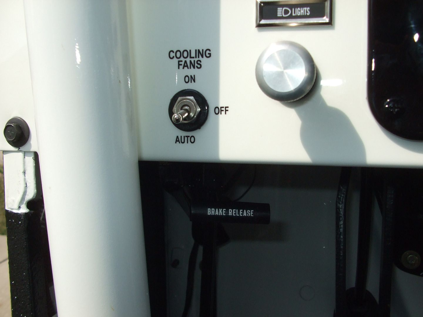

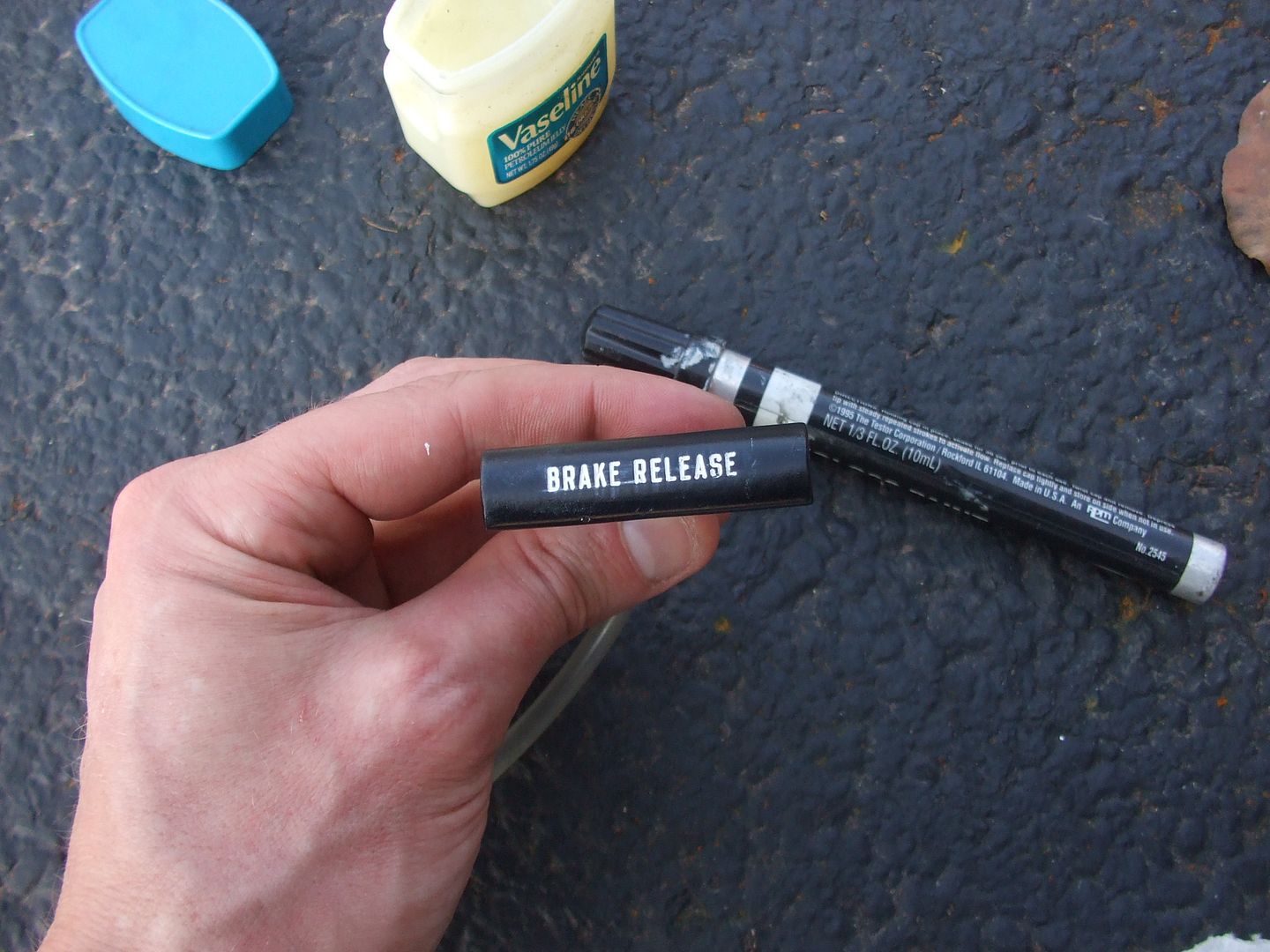

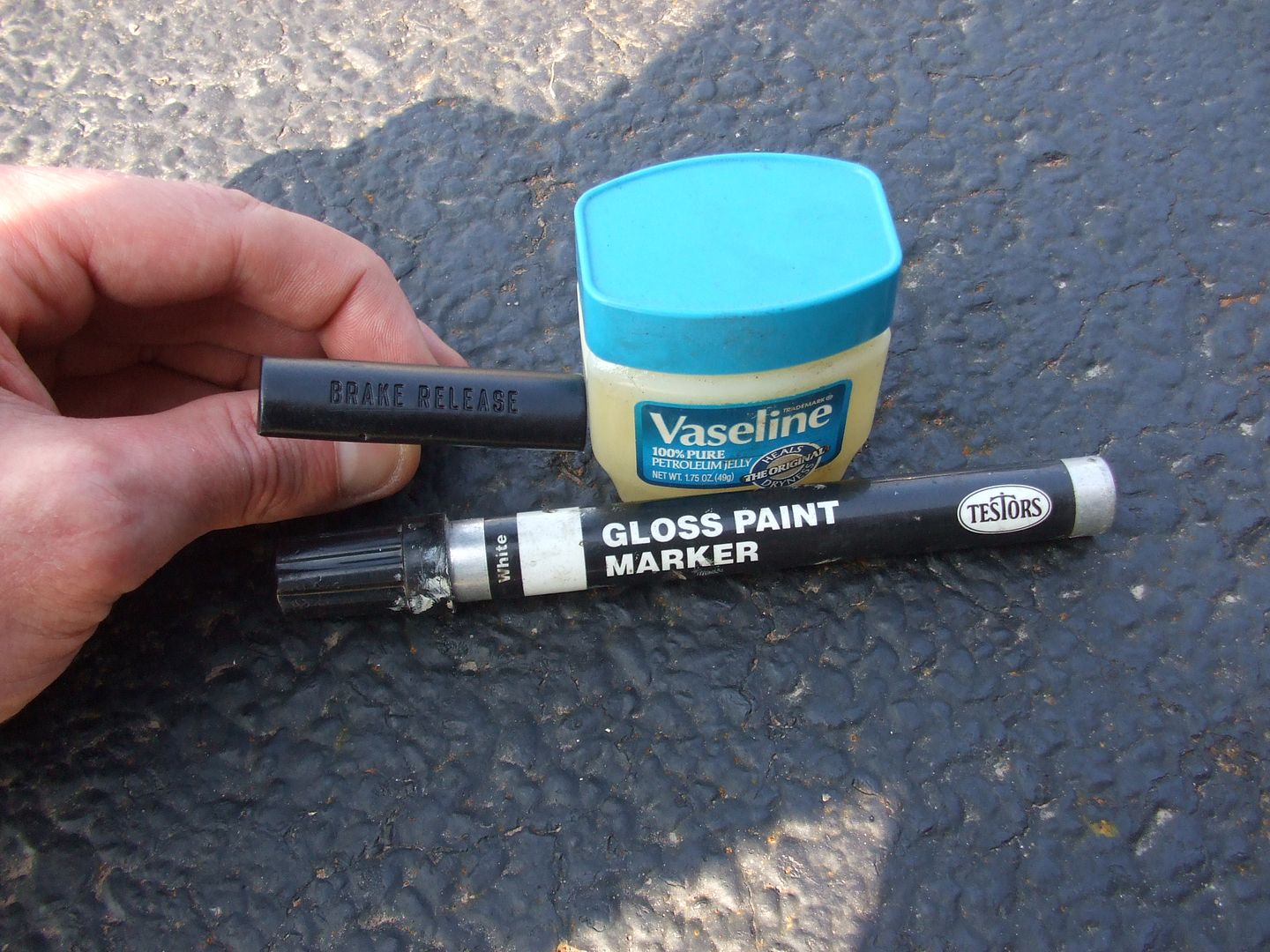

My parking brake pull handle was all beat up and covered in copper overspray so I painted it black.
I wanted to make the letters white so here is what I used to do that. Put the smallest amount of vaseline on your finger and wipe it on the face of the handle. You want to make it super thin to make sure none of the vaseline gets down into the letters.
Next, dab the white paint into the letters.
I waited about 15 seconds and wiped across the face of the handle with a paper towel. I only did it once and fast because I didn't want the paper towel to suck up too much paint and I also didn't want to get paint on the now grease free handle face. Once it completely dried I was able to go back and clean the white haze off pretty easily.
Now it matches the rest of the Jeep. I also labeled my cooling fans with the vinyl I got from Graffxman. You can see where I screwed up the 'auto'. I was repositioning my hand to the other side of the roll bar and I accidentally stuck it on there. I tried to pull it back off but two of the letters stuck and I didn't want to tear them trying to remove them. I think I am going to order another set of the front fender pin stripes to take another crack at those so I'll order a new 'auto' sticker as well as matching 'fog lamps on/off' sticker because those are already pre-wired to that same area.

That is a great tip Mike, thanks for sharing!

That is a handy tip. I wiped vasoline on all the parts that I didnt want paint on when I painted my engine block (like the gasket surfaces) The when I was done, I wiped off the vasoline and then sprayed brake cleaner on a rag and I wiped the surfaces that I vasolined to get rid of the film. Worked like a charm.
Before...
After...
Sorry, the only pics I have.

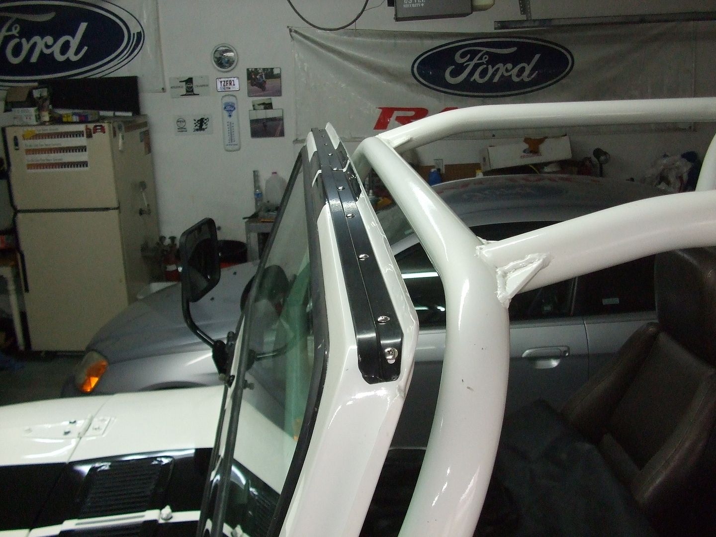

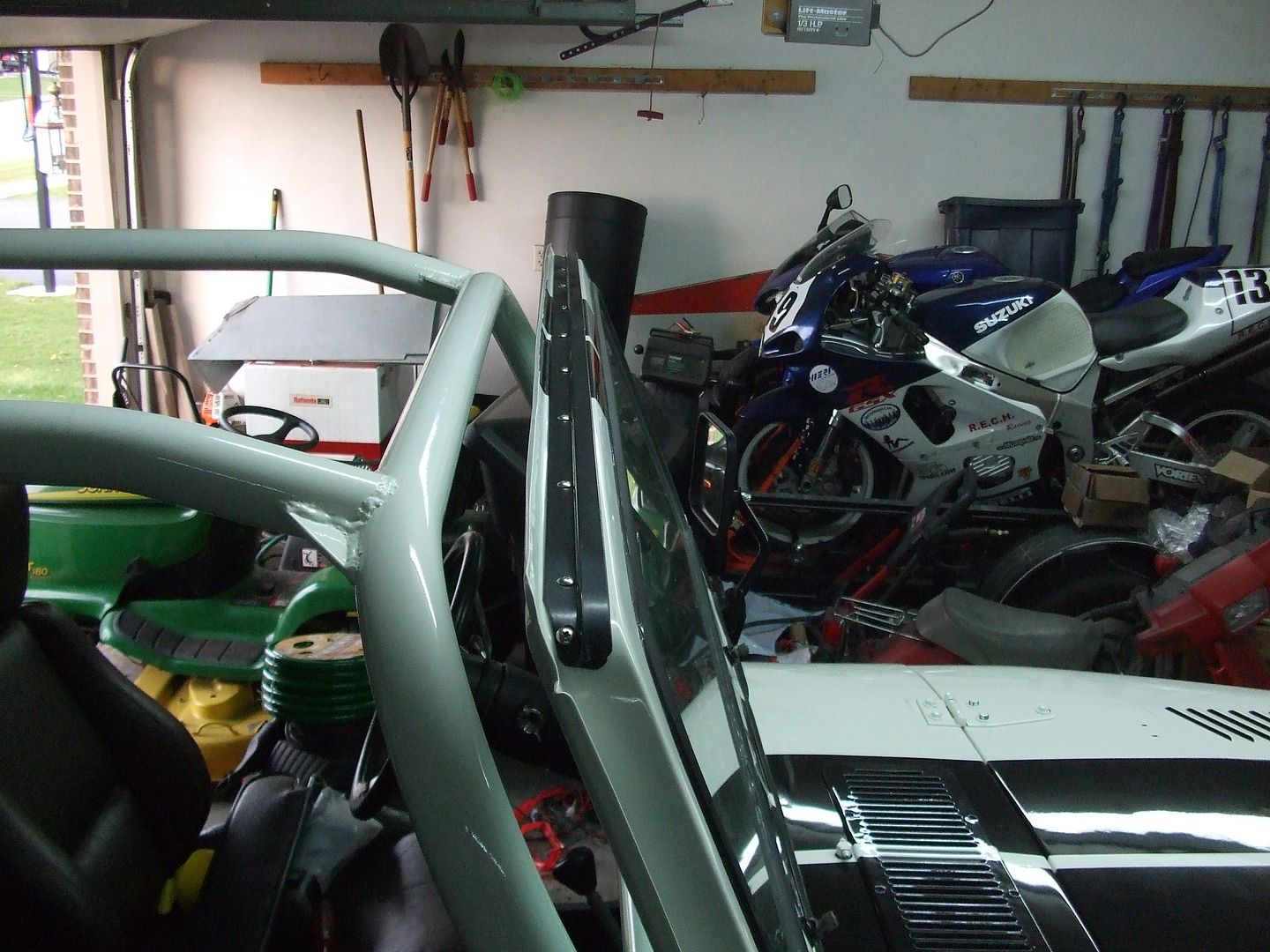

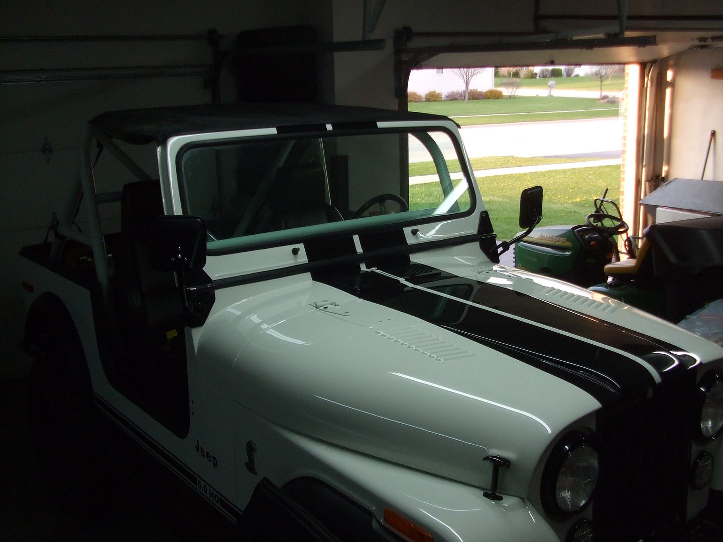

Soft Top Rail
One more thing to post before I show you what we built on Sunday.
I got some SS screws for my soft top windshield rail mount. I'll probably have the bikini top on it most of the time. Nothing too fancy here, line up the rails, drill the holes, touch up with paint and install the screws with a dab of anti-seize the next day.
One from the driver's side. You can see the hood hinge bolts that need to be repainted or touched up.
Here is with the bikini top installed.
I think she is a little shy.
Mike

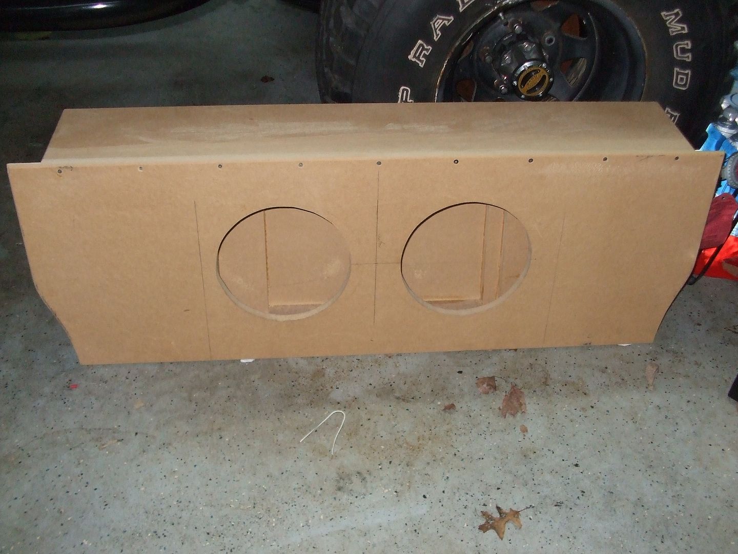

Sub Box

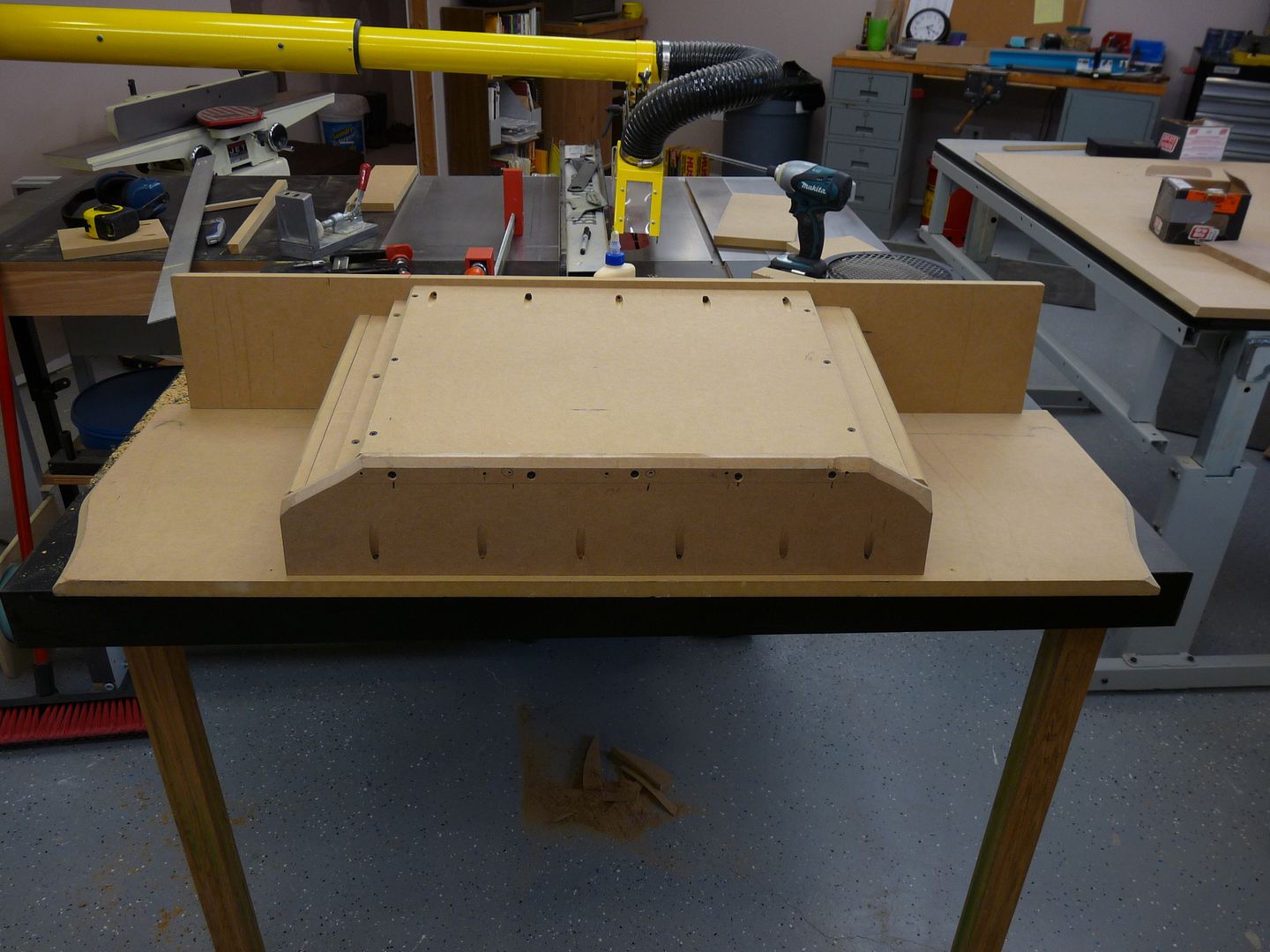

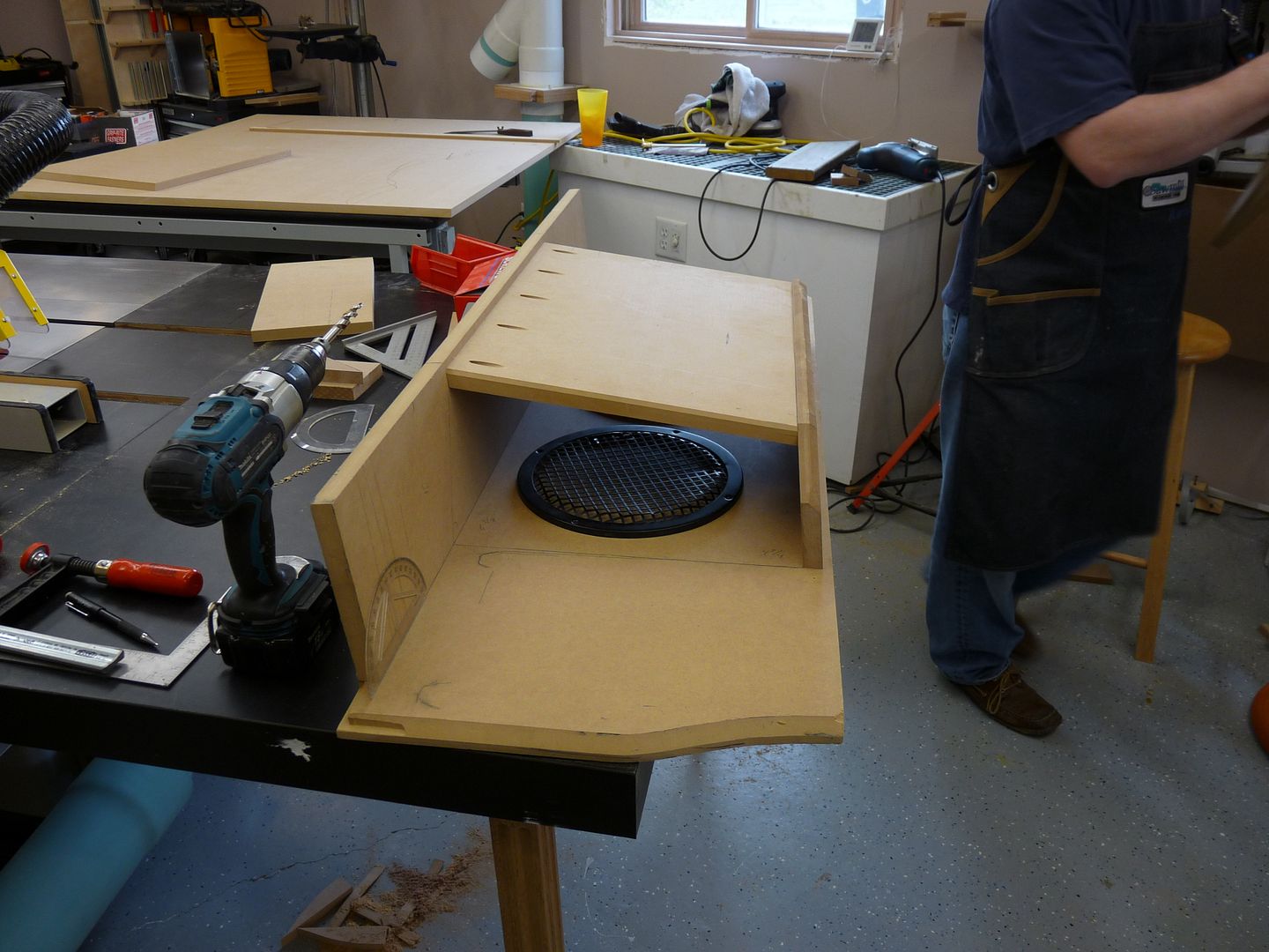

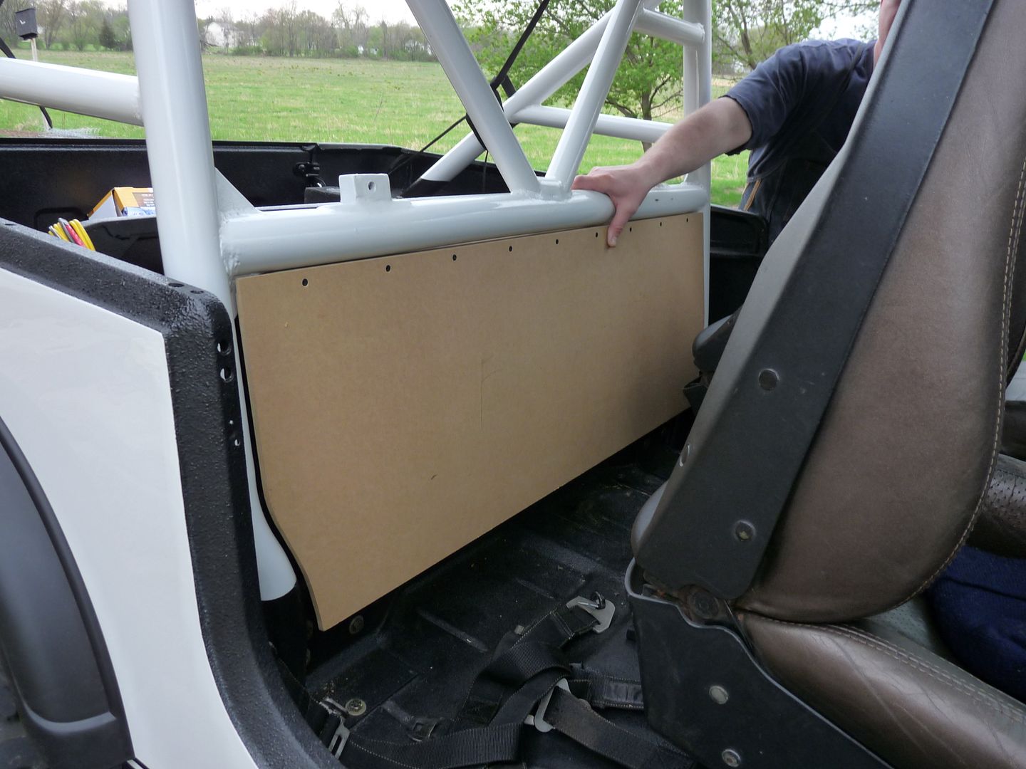

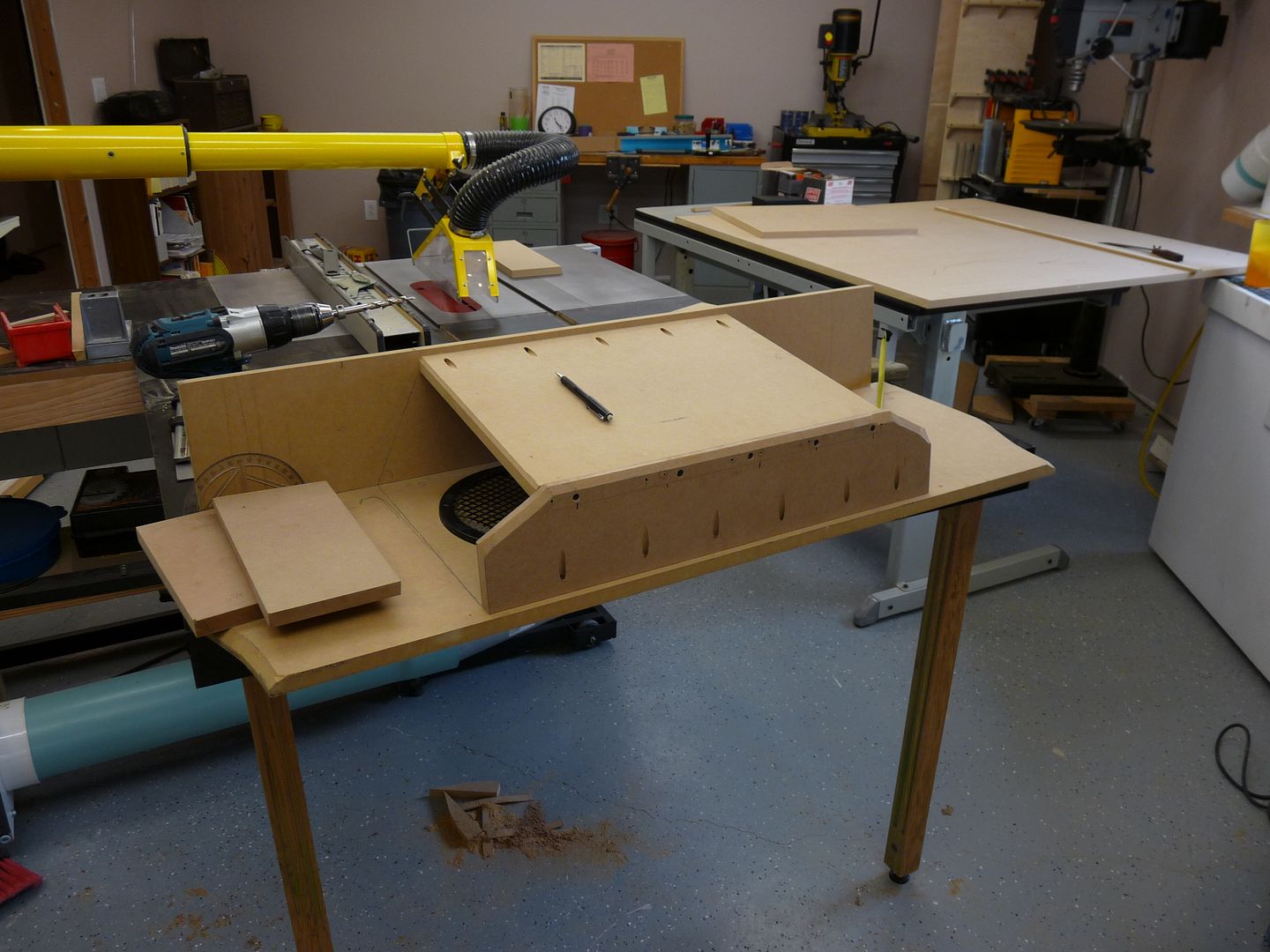

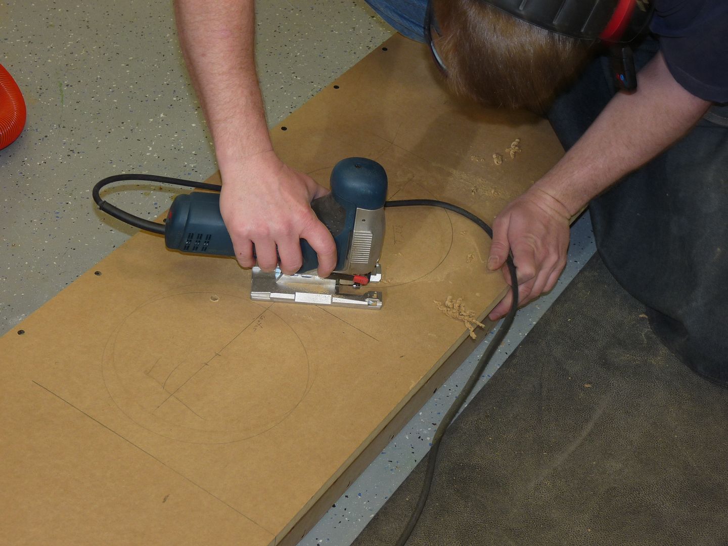

Last Sunday I went over to a friends house, who has a nice woodworking shop, to start work on the sub and amp box. I had forgot my camera and mentioned it to my friend a couple times before he finally went to grab his so I don't have as many pictures as I would like but there should be enough to follow along. Here is a good picture that shows the shape of the Scrambler bulkhead. Keep in mind that the angle in which it goes to the floor is different than the angle the roll bar takes.
We started with a 4x8 sheet of 3/4" MDF and cut a panel to fit across the face of my roll bar, we had to trim for the gussets on the top corners and for the legs at the bottom corners. Next we made a top plate that extends back to the bulkhead and screwed them together. Since none of these angles are on 90*, we were having to shave pieces at 5* and 12* angles to make them flat at the mounting surface. Here is Aaron holding it in place.
Next we cut out a square piece where the main backing is going to fit against the face of the bulkhead and a piece for the lower ledge. Here you can see them already attached.
This is a good picture showing all of the weird angles we are having to deal with. This picture also shows how the two 10's side by side are larger than the main back plate so we can't just make a simple box to close it in. We had to step out the sides to fit the speakers but also not interfere with the contour of the bulkhead.

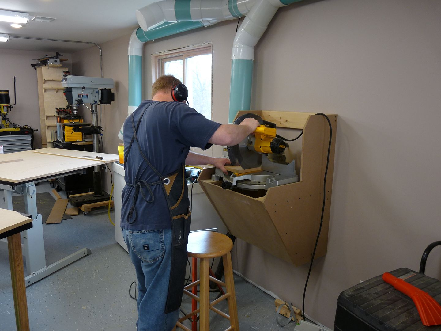

Here is a picture of Aaron cutting one of the end pieces. He has a nice shop with a complete vacuum system.
After much deliberation on how we were going to angle out the end caps, we decided that stepping them out would be the easiest. The smaller sub amp will go on the left and the slightly larger 4ch amp will go on the right. That's why the box extends out just a bit further on the left side, we were trying to get as much box volume as possible.
Last but not least, I let Aaron cut out the speaker openings. He was running the show most of the day so I wasn't about to screw it up at the end.
With the openings cut out we took it all apart and reassembled it with glue. We went around the face with an 1/8 rounder bit to clean up the edges. I'll probably fill the screw holes in the top face before I spray it with Raptor.

Mike now I see why you kept the bulkhead in place. That is a very good use of space. Great looking work and craftsmanship too.
Tell your friend Aaron he's sure got a nice shop too!
(Crabtree Shackle Hangers)
My build thread
Jim1611 is offline
post #1455 of 1947 Old 05-12-2011, 04:03 PM
Skerr
Location: White Springs
Posts: 10,103
GREAT idea for the miter saw! Tell Aaron thank you. I will adapt it to my own shop.
Nice work Mike and Aaron!
