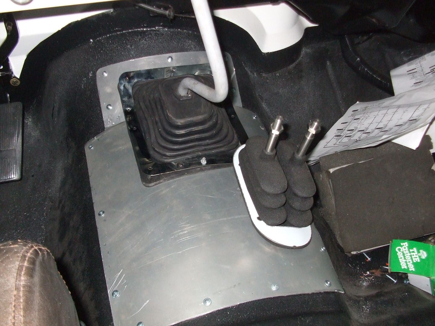

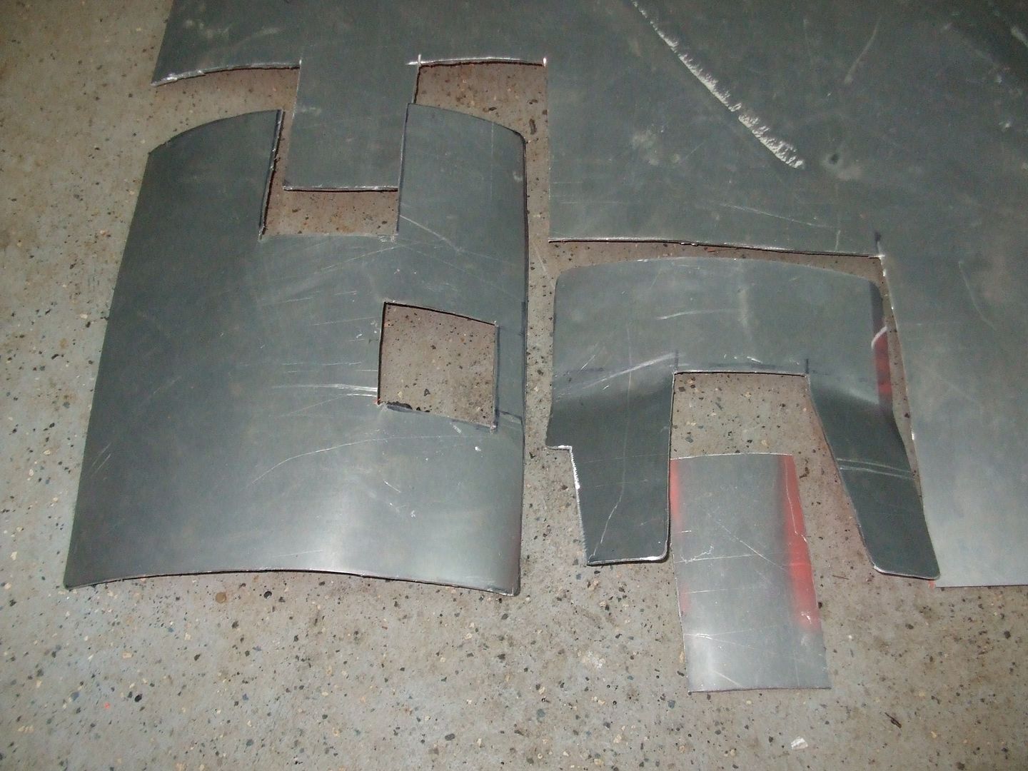

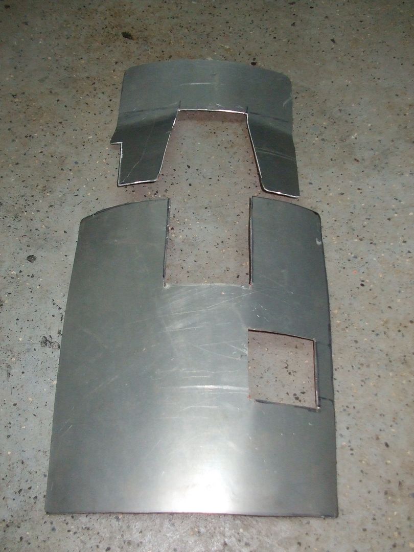

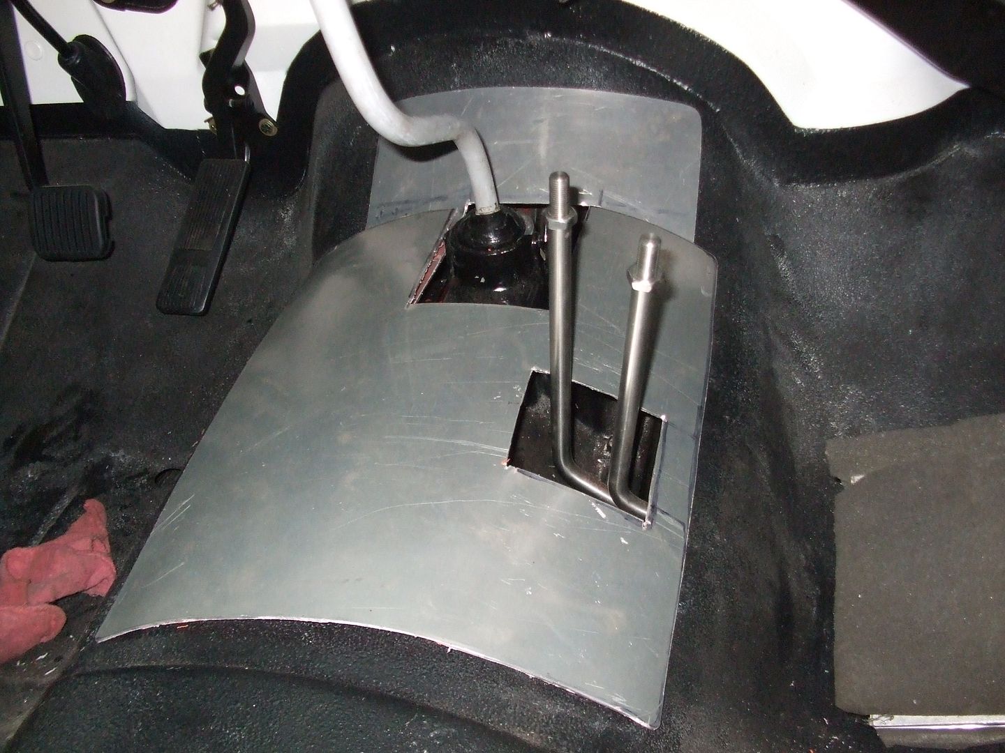

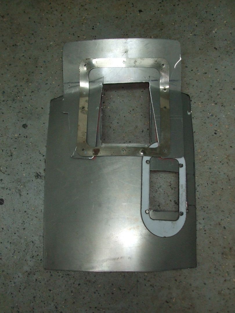

Trans Tunnel Cover
As you guys know, I was having trouble with what metal to use for my trans tunnel cover. My previous one was made out of 26g steel and just spray painted black.
I had just purchased a new sheet of 26g steel because it is easy to work with but it is very thin and also dents easy. Last summer they were running an oil pipeline through the farmers fields in northern IL which took them months to complete. For over a month there was this road working sign sitting in the ditch which looked like it had been ran over by a semi. There was a brand new sign displayed 25 ft from the damaged one. Then I noticed they finally moved it to what was obviously a trash pile. It sat there for another month before I decided I might be able to make something with it. My original thought was to use it for a glove box but even 1/8" aluminum is a little difficult to bend and work. The plastic glove boxes fit and work fine and they are cheap so I ditched the aluminum idea. I had been trying to give it away but no one seemed to want it. Well then it dawned on me that I could use the flattest section of the sign to make the tunnel cover.
I forgot to take pictures before I started cutting and bending but here you can see how it came out of the sign.
Here are the two main pieces that will be installed.
Here is a picture with the shifter boot trim rings. I have the forward piece sitting on top so you can see how the rivet/screws for the shifter trim ring will tie the two pieces together.
Here they are rough cut and sitting in place.
Here is one last picture with the cover installed the shifter boots sitting in place. I'm thinking about running a bead of liquid metal filler where the two aluminum pieces meet.
I ordered a new transmission shifter boot because my current trim ring needed to be replaced, you can't buy the trims rings separate. I actually bought one that is 1" smaller. I plan to coat both sides with Raptor, use SS screws to secure it and I already have the weatherstrip to place between the cover and the tub.
Mike

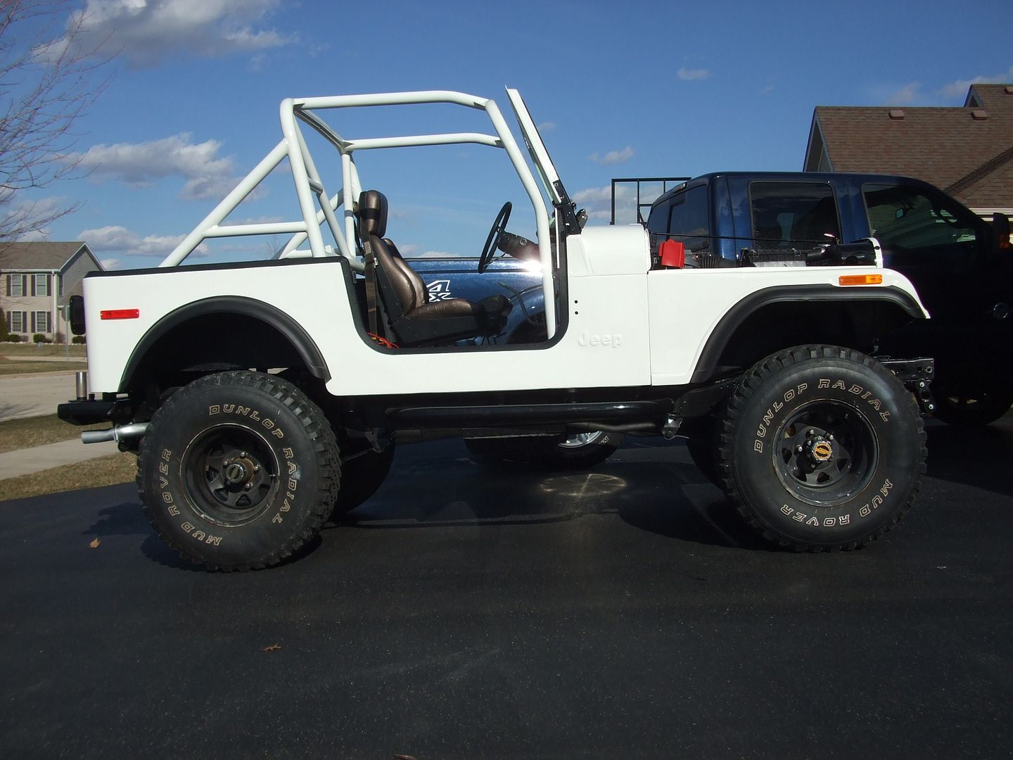

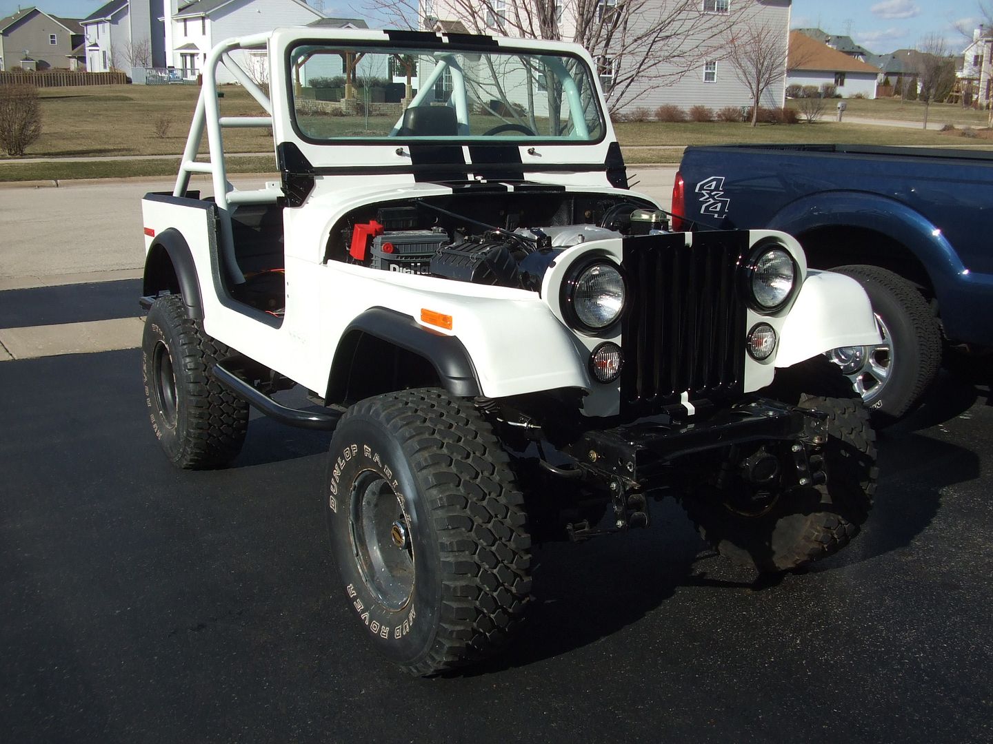

First Drive
Once I had the seat in it, I slapped on the steering wheel and pulled it out of the garage under it's own power for the first time in a long time.
I need to decide on some wheels and I really like the white I picked in the sunlight.
I definitely need to get the hood installed.
Mike
