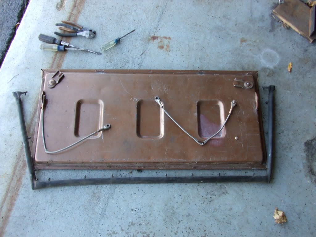

Stripping the tailgate, hood and dash
Thanks for the comments guys.
It has been a lot of hard work and is a very time consuming project but I think I can see a dimmer of light in the distance. I'm at 91% on my free photobucket bandwidth for the month and it doesn't reset until the 23rd so hopefully my thread doesn't go blank for a couple days.

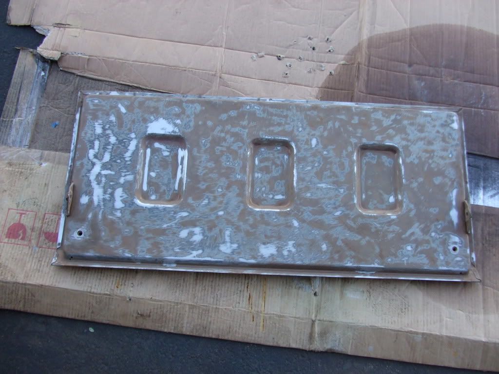

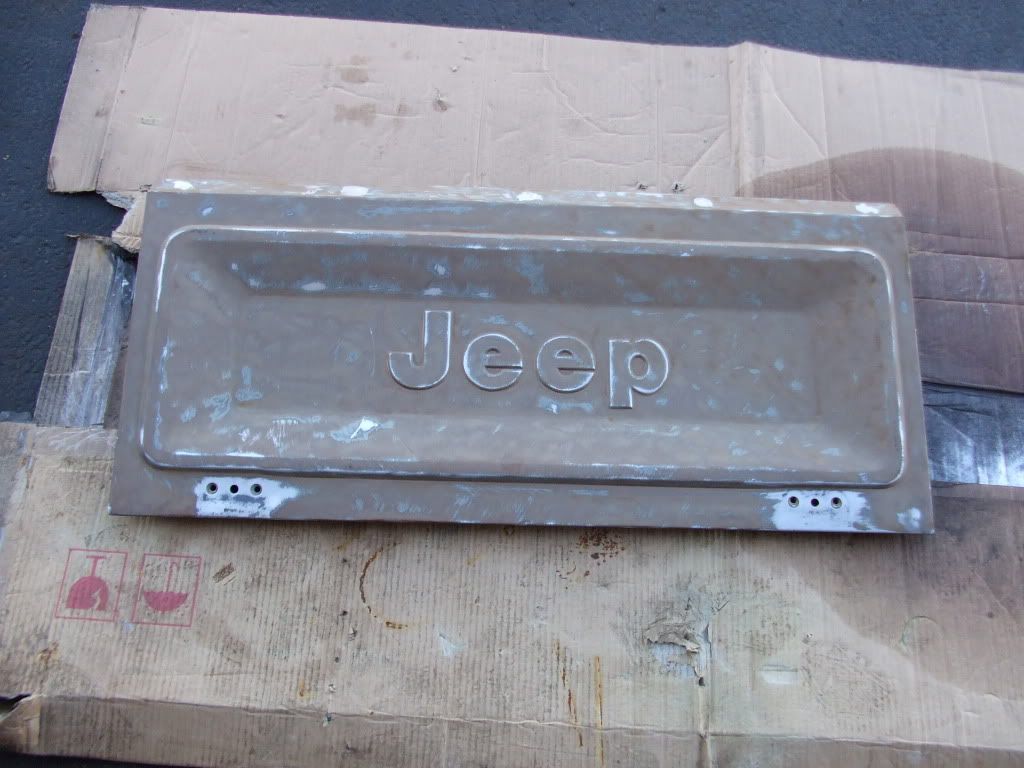

I figured I might as well try to get the rest of the main body panels stripped down and ready to paint at the same time as the tub. Here I pulled off the seal and cable hold-downs. I had to use MAP gas and an impact driver to get the latches off.
I tested several different ways to strip the factory paint and decided to go with removing the gloss via a 4 course-stripping wheel. This knocked all the shine off the factory paint.
I used the same wheel on the outside.

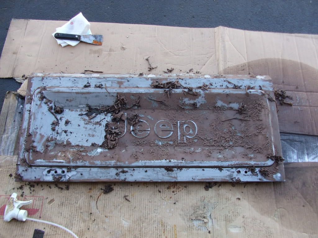

Next I applied a coating of POR-Strip and waited about 10-15 minutes before hitting it with a gasket scraper.

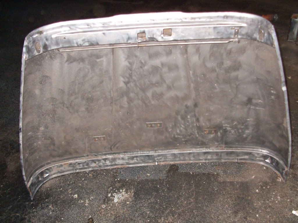

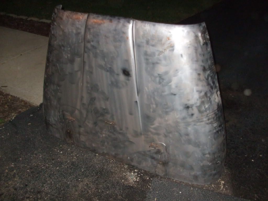

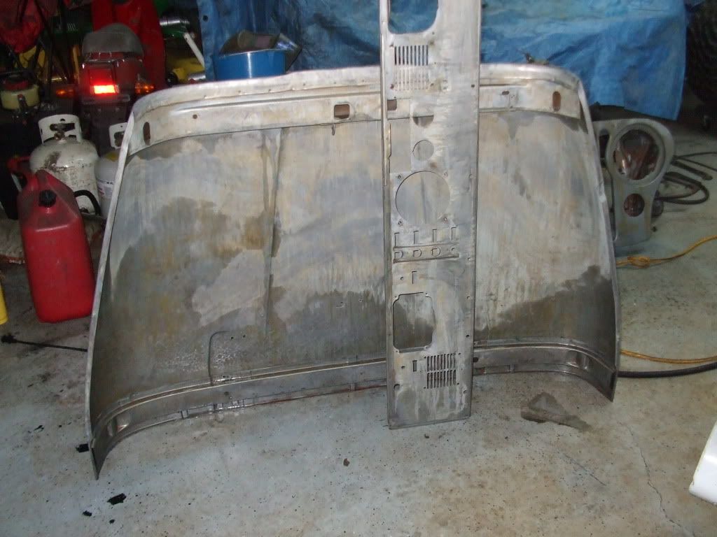

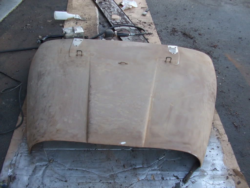

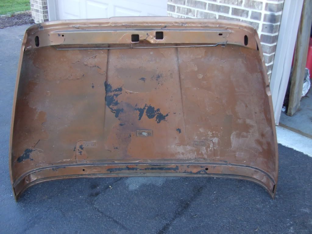

The hood got the same treatment. Before the course stripper wheel:
Here it is after over 20 minutes worth of giving it hell.
The bottom of the hood was in even worse shape.
Another 20 minutes of grinding away.

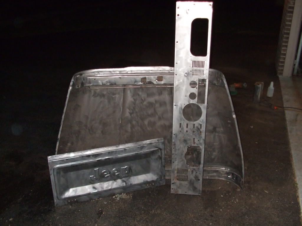

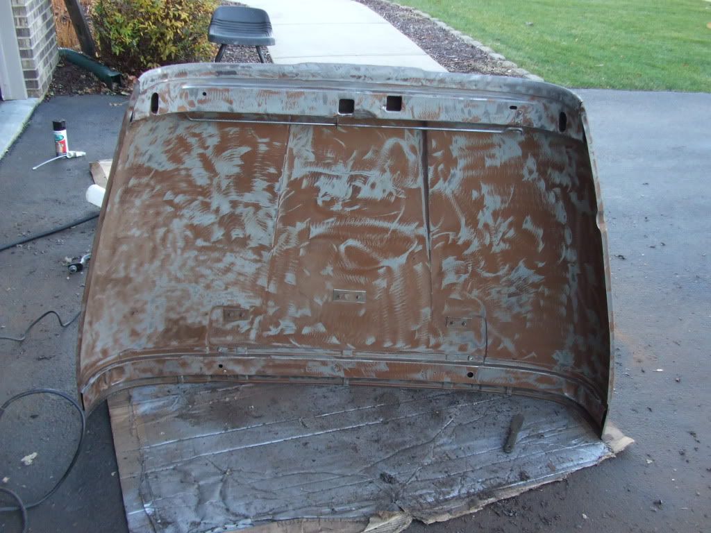

I hit it with the stripper then gave it the same once over with the gasket scraper. From there I pulled out the wire wheel and hit any areas left over.
The bottom came out clean.

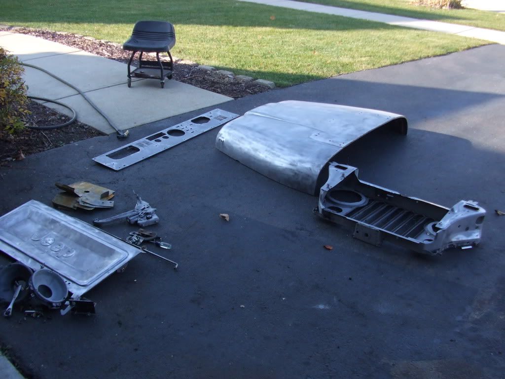

The dash got the same treatment so here are the three pieces ready to be washed and painted.
I had the grill media blasted so all I have to do is clean that along with the rest of these pieces and paint them along with the sides of the tub.

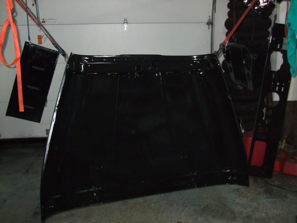

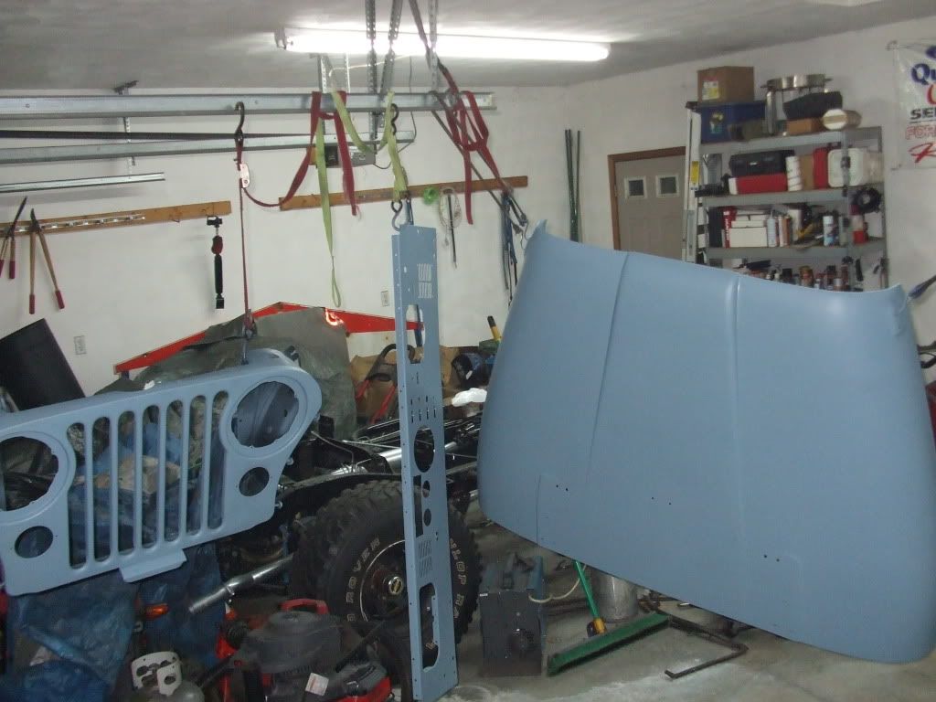

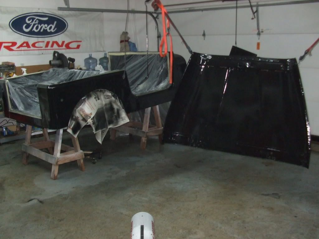

I used one of our last mid 50-degree weekends to get some paint on the rest of the main body panels. I cleaned everything to be covered with POR with Marine Clean then coated with Metal Ready. Here there are all of the parts ready to be cleaned.
Got the tub set up on some barrowed sawhorses and cleaned it as well.
Here is the hood and dash drying after the Metal Ready.

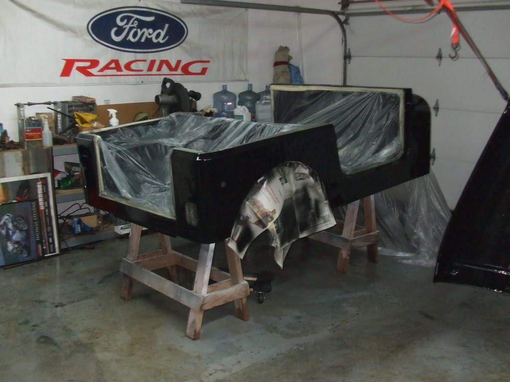

I taped off the insides to keep the over spray off of the Raptor and hung the rest of the parts.
Bling Bling. First coat on the tub sides.
First coat of POR on the rest of the panels.
This is one of those photos that show you a little something extra hidden behind the flash. They usually show off women’s underwear but in this case it showed my light paint coverage. With the naked eye only the lightest strip left of center looked a little light, everything else looked pretty solid black.

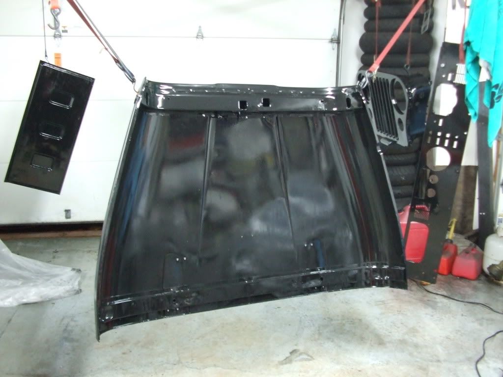

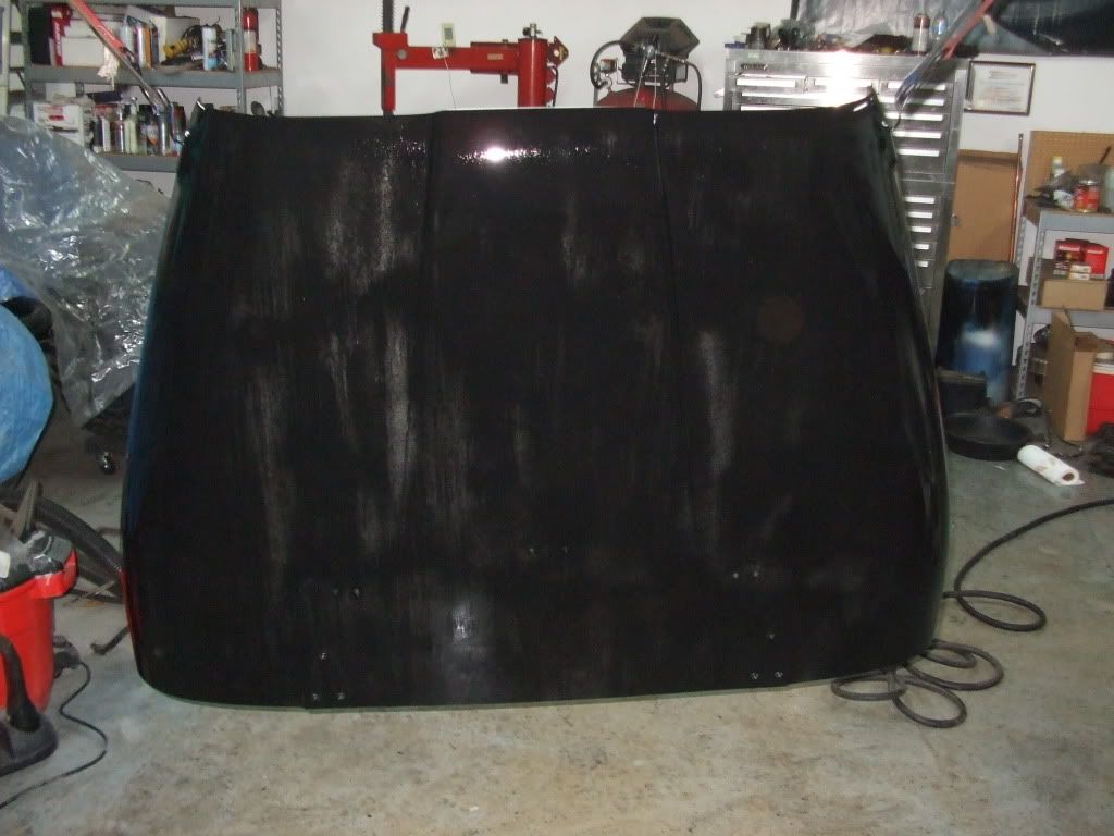

Second coat on all the parts.
Everything is looking pretty good.

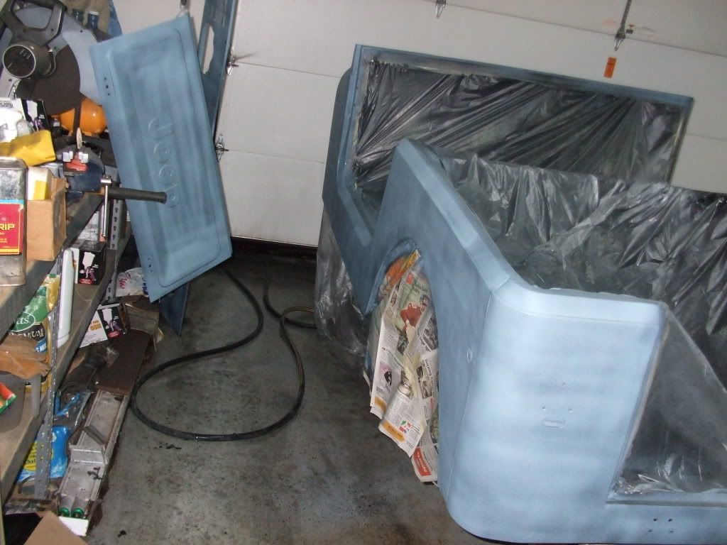

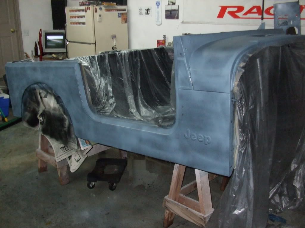

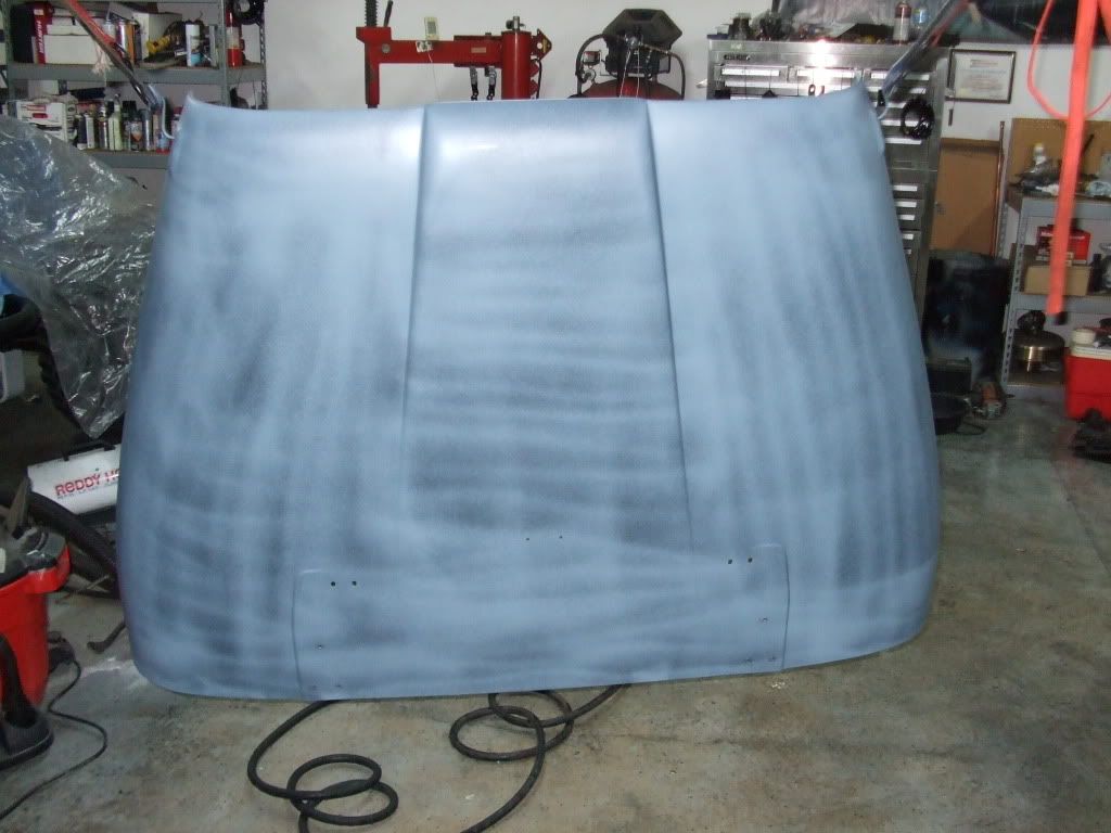

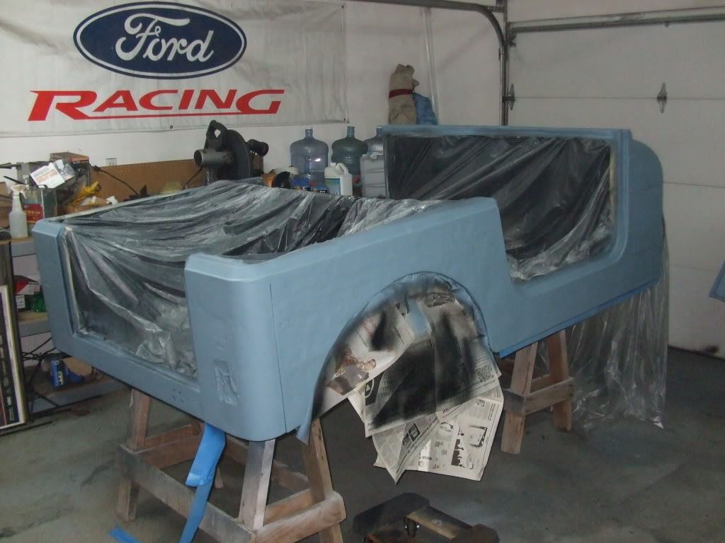

POR suggests spraying on a dustcoat of primer while the POR-15 is still tacky so I decided to do that with their Tie-Coat Primer.
Picture of the passenger’s side.
The hood didn’t look quite this streaky without the flash but it was supposed to be a dustcoat anyway.
POR says to wait at least 24 hours before applying more primer so I actually waited until the next weekend to put a full coat of primer on all of the pieces. Had to use the heater for a little bit but not too bad.
Now comes the fun of body filler and sanding. I’ve got a gallon of Evercoat Rage Gold and a tube of Evercoat Easy Sand. I've got all winter to do it because there is no way I will be able to paint color until spring but I plan on busting it all out as soon as possible to use as much of the decent weather as I can and to not tie up the entire garage with the tub on stands, not to mention having to deal with all of the filler dust. I just want to hammer most of it out and only have to clean up once. I also need to get the hood to the local Hotrod shop to get the louvers stamped in. I’ll be asking for opinions on that in another thread. It's finally starting to look like a Jeep again.
