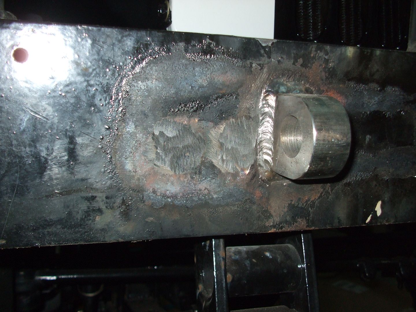

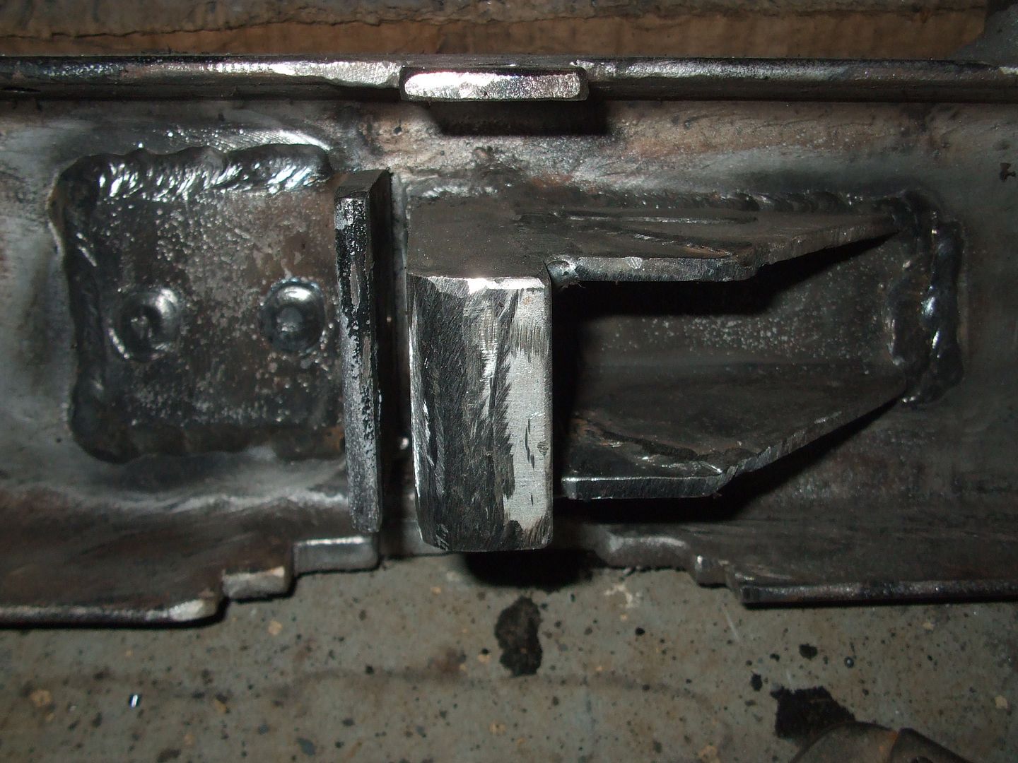

More Bumper Mods
With the bumper originally installed mainly by the 3/8" angle iron, I had always used those to make sure the bumper was in the correct position before making all of my other winch plate and clevis modifications. I needed to keep that 3/8" angle in there for the proper gaping since it was on the inside of the winch plate's front legs.

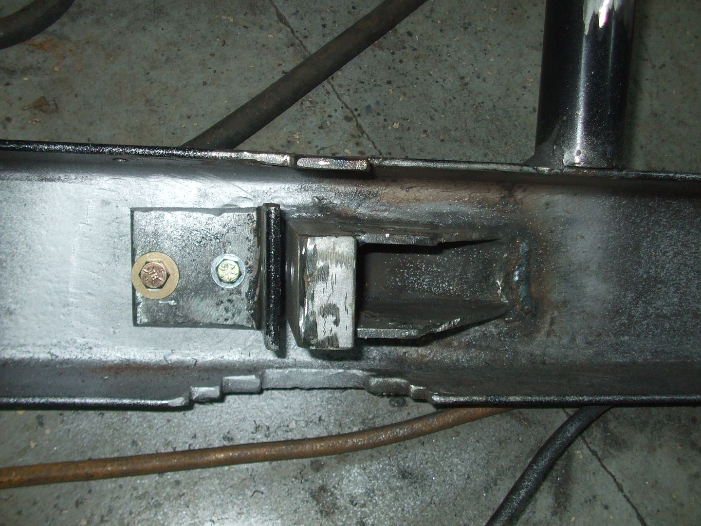

I reinstalled the 3/8" angle iron attached as it originally was.
Here is a shot of the driver's side. As Jim mentioned before, I probably could have shaved those edges down a little more.

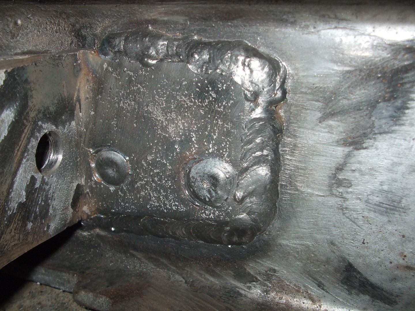

With the bumper installed and the brackets neutralized and tightened down, I went ahead and tack welded the brackets to the bumper. I pulled the bumper off the Jeep and finished welding the angle iron to the bumper. I think that should hold it.

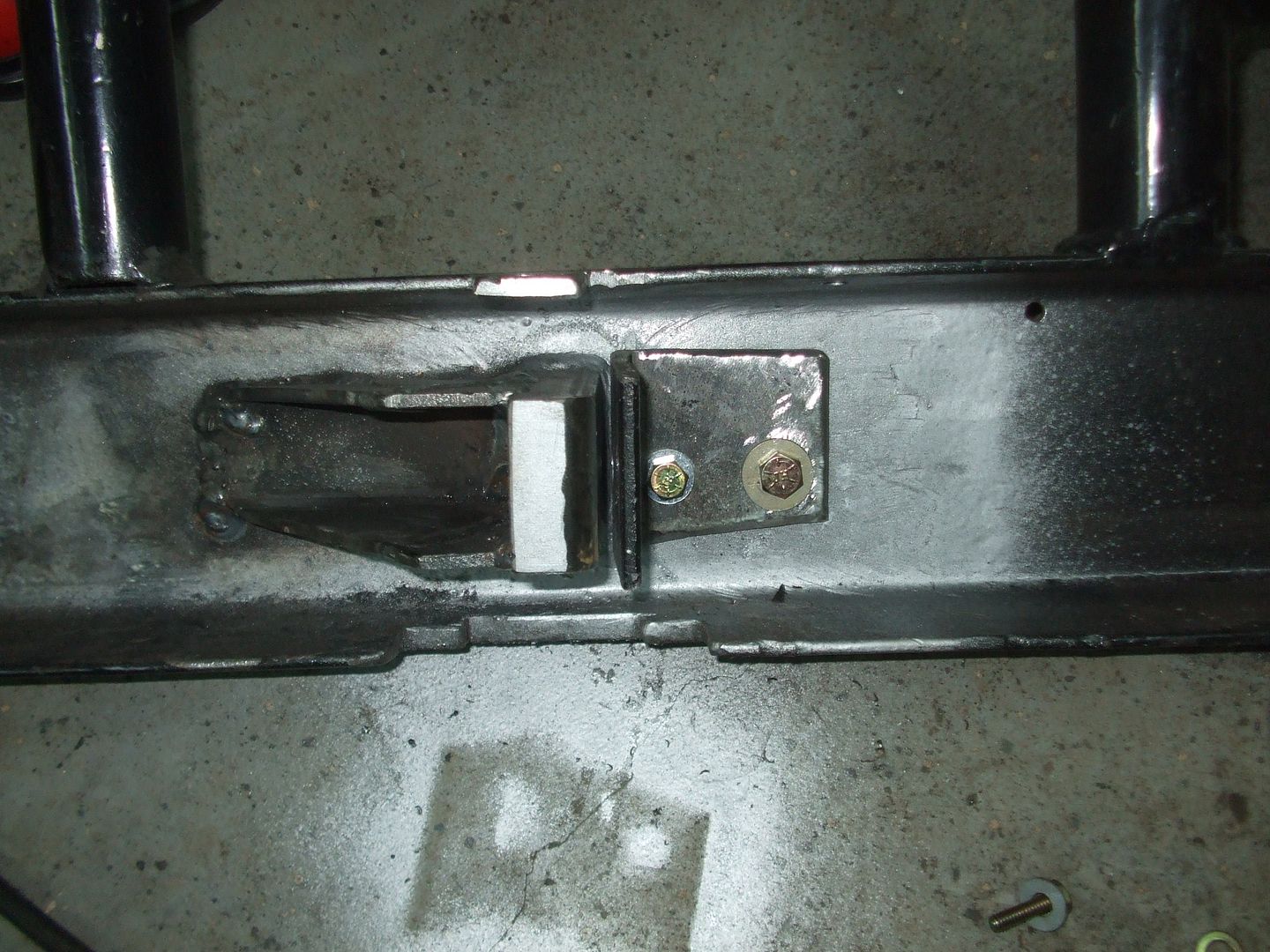

A picture of the driver's side all welded up.
No more holes in the bumper face.
One more picture of the entire driver's side mount. I have a feeling if the bumper ever gets ripped off, I'll also be looking for a new frame.
Think about how much the clamping force of those components would stiffen up a 1/8" thick frame rail. If you need to stiffen up a long rectangle, which two beams are the most important? The ones on the ends, I think I've got that covered.
I don't know how much this thing weighs but between the bumper, mounting plate and winch, my back and legs hurt on Monday from moving them around last weekend. I hope the front of the Jeep doesn't sag too much. Hopefully my Ground Pounder Fab rear bumper with a spare tire will help even out the weight at both ends. Those mods are worth a half mile to the gallon.
