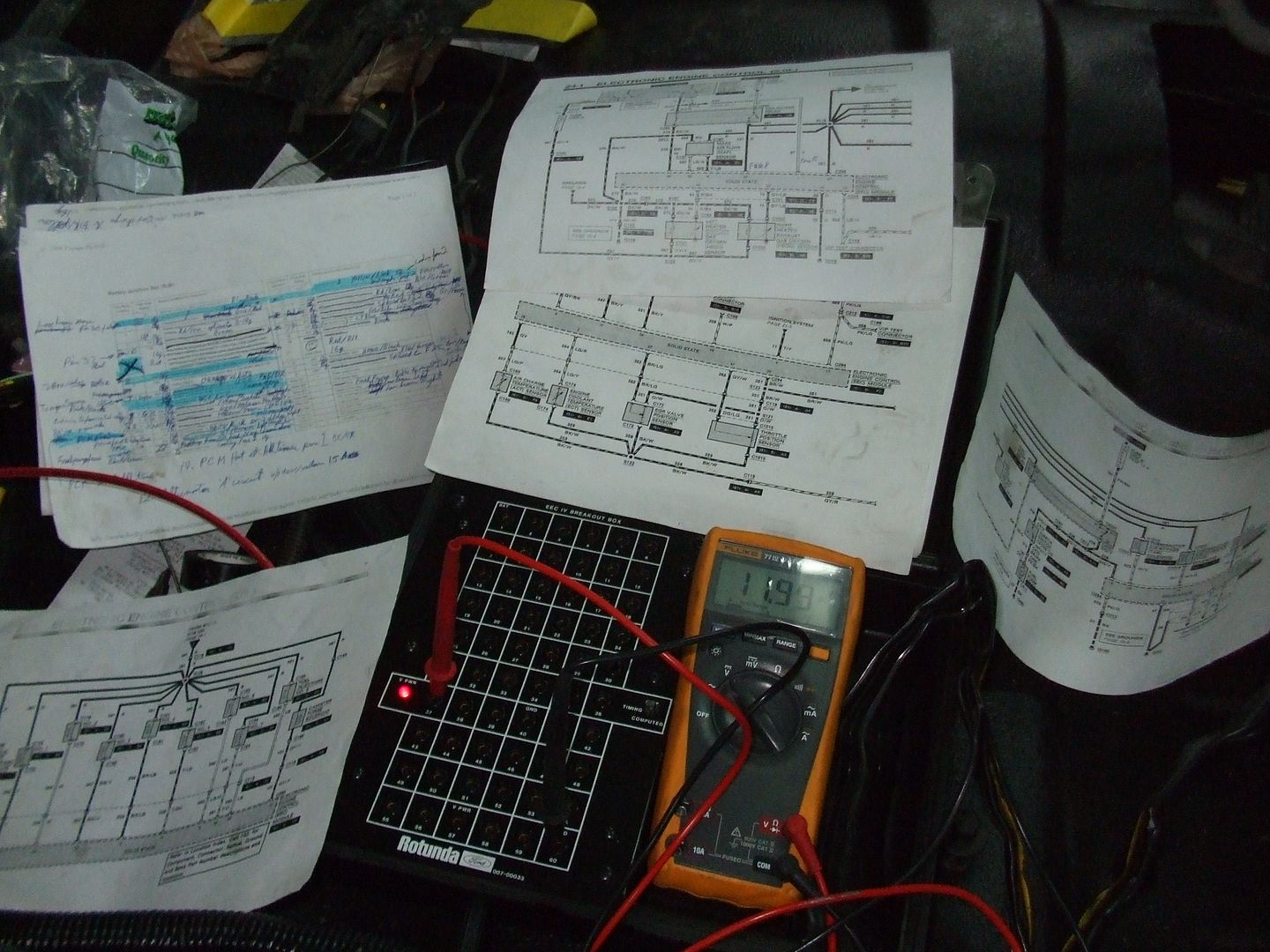

Since I had to run my extra power wire to the amp up the same harness as the PCM, I had to pull it out from behind the dash. Much to my surprise I was able to get it out without too much trouble. Since I had easy access to the PCM I decided to check out some of my engine sensors and verify their readings. I hooked up what is commonly referred to as a BOB. A Break Out Box is simply a terminal station that is spliced into the harness directly at the PCM itself. Here I have it connected to the PCM and can now connect the vehicle harness.
This allows me to start and run the engine if I want while being able to check any circuit to or from the PCM. You can see the VPWR light is lit up and I'm down to 11.99 volts on pin 37. This is after I had already been checking most every sensor with the engine off. Pin 37 is the main VPWR to the PCM. Pin 60 is ground.

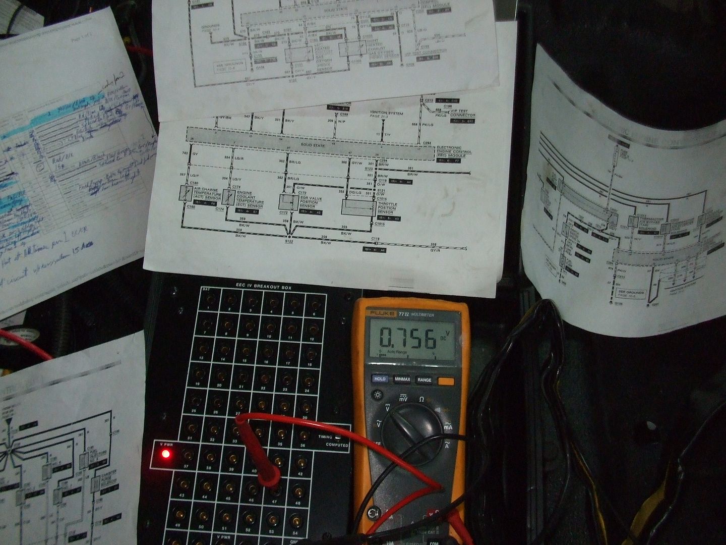

Here you can see me checking pin 47. If you notice the diagram above the meter, pin 47 is for the TP (Throttle Position) sensor. It was at .925v closed and only went to 4.0 at WOT. I adjusted it down to .756v closed throttle and now it goes to 4.249 at WOT. Anything over 4.0v is considered WOT to the PCM, I just wanted to make sure it really knows when I want WOT.
I also did this with the EGR. I commanded it on and off, verified it had flow when the engine stumbled and verified the position sensor changed. All of the sensors looked good except for my HEGO's were awfully slow. I think they need to get a good drive cycle and some heat under their belt since they haven't really been used in so long. If they don't perk up on my first test drive I'll have to replace them.
